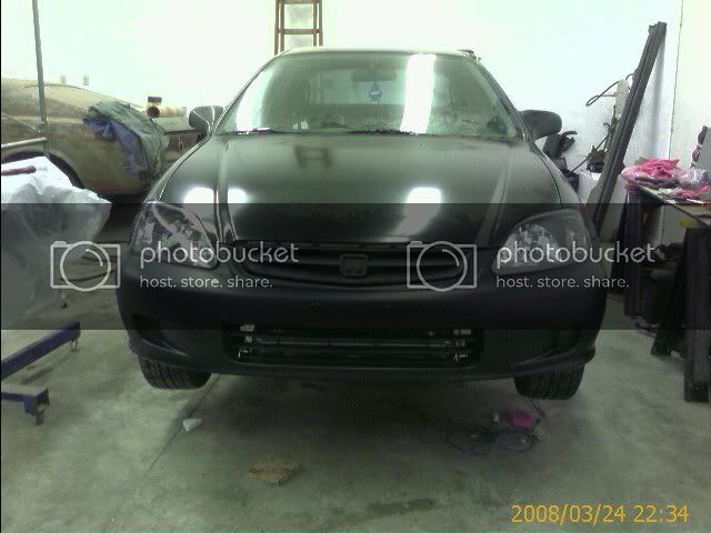

Front end is all mocked up, and sitting correctly. Mild tweaking needed to get things perfect. I'm very happy with the way it looks. (Sorry the front lip is off, I completely forgot to put it back on!)

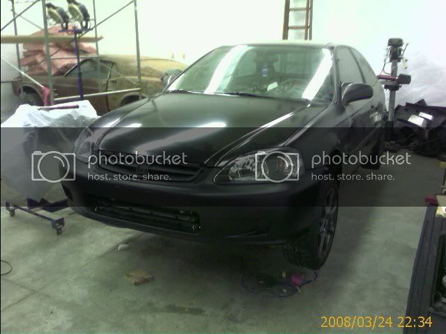

A slightly different angle, just so you can see down the side, everything is lining up decently.
