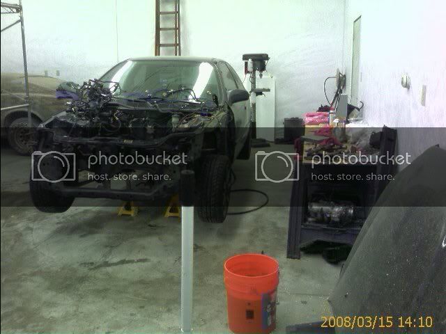

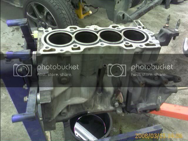

Update. Here's pics of how the car sits right now.

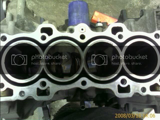

Engine out, stripped, ready for honing and new internals.
A look down the cylinders. I can't lie, this engine was exactly what jdmonline said it would be, low miles. You can still see the factory crosshatching. No scoring whatsoever. Even after almost a year of me driving it and almost 10,000 miles more than when I got it.

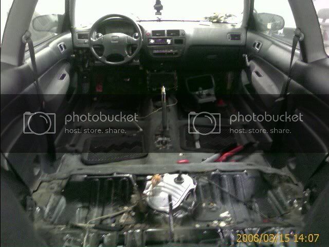

How the interior sits right now. Still trying to decide on what I'm going to do with the interior.

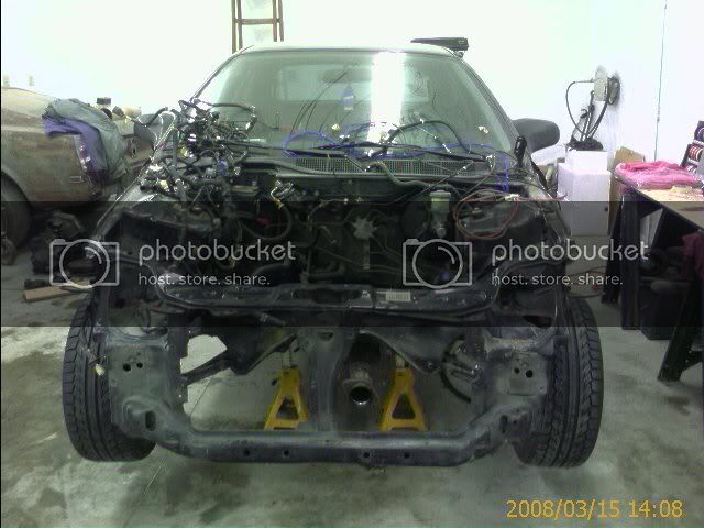

The engine bay. Needs a good cleaning and it will be getting repainted. New sheeth for all the wiring, and a wiring tuck if I can stop being such a lazy ass.

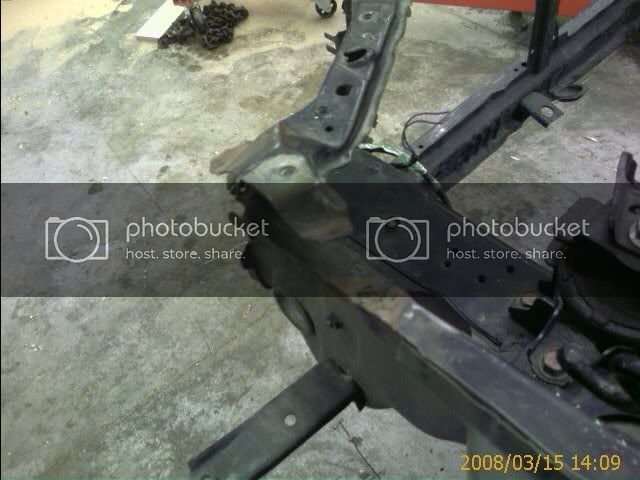

This is where the core support meets the chassis on the drivers side of the car. What a bitch this was. Don't hit things. Trees and cars dont mix.

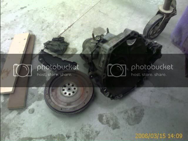

B16 transmission laying off to the side. New clutch and flywheel are in order.
The workspace. Clean and organized. Thats the only way to be :)
