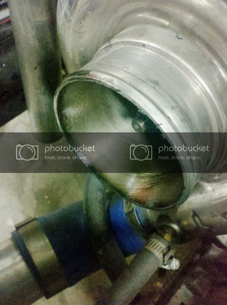

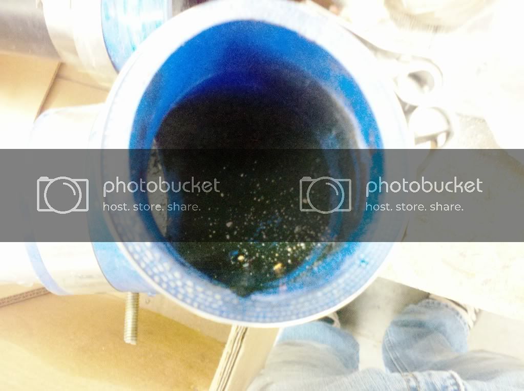

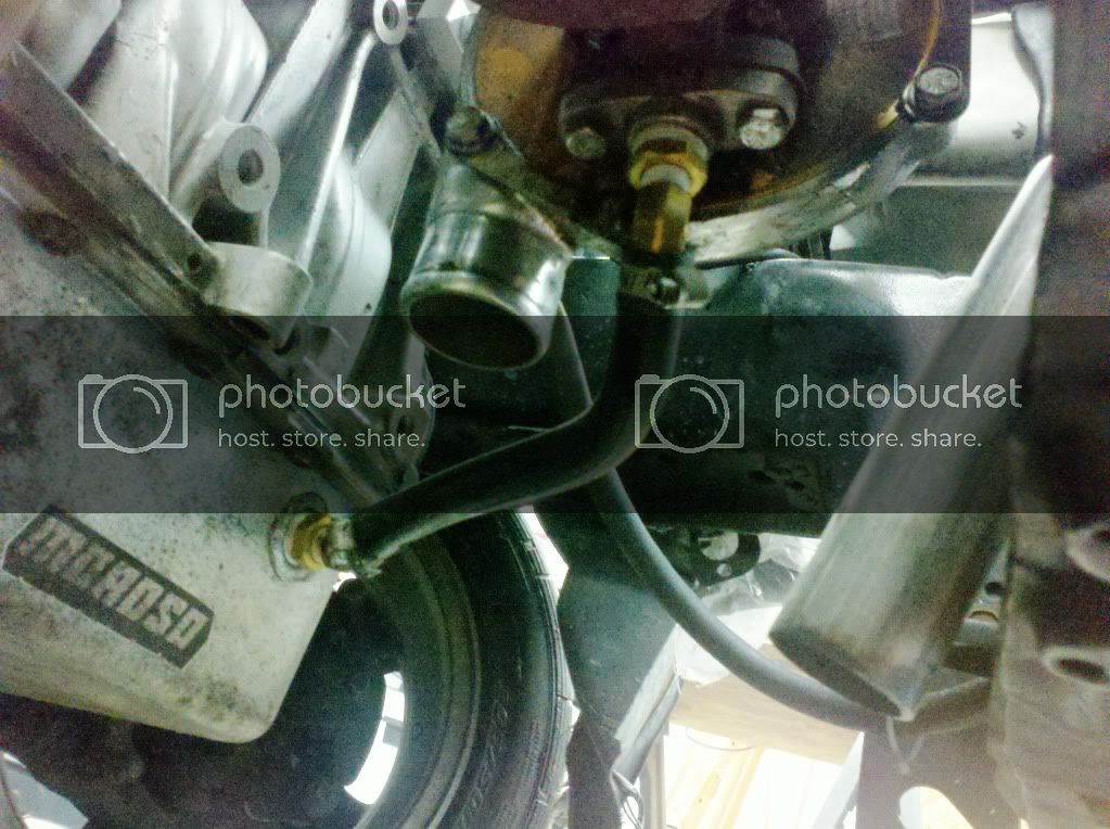

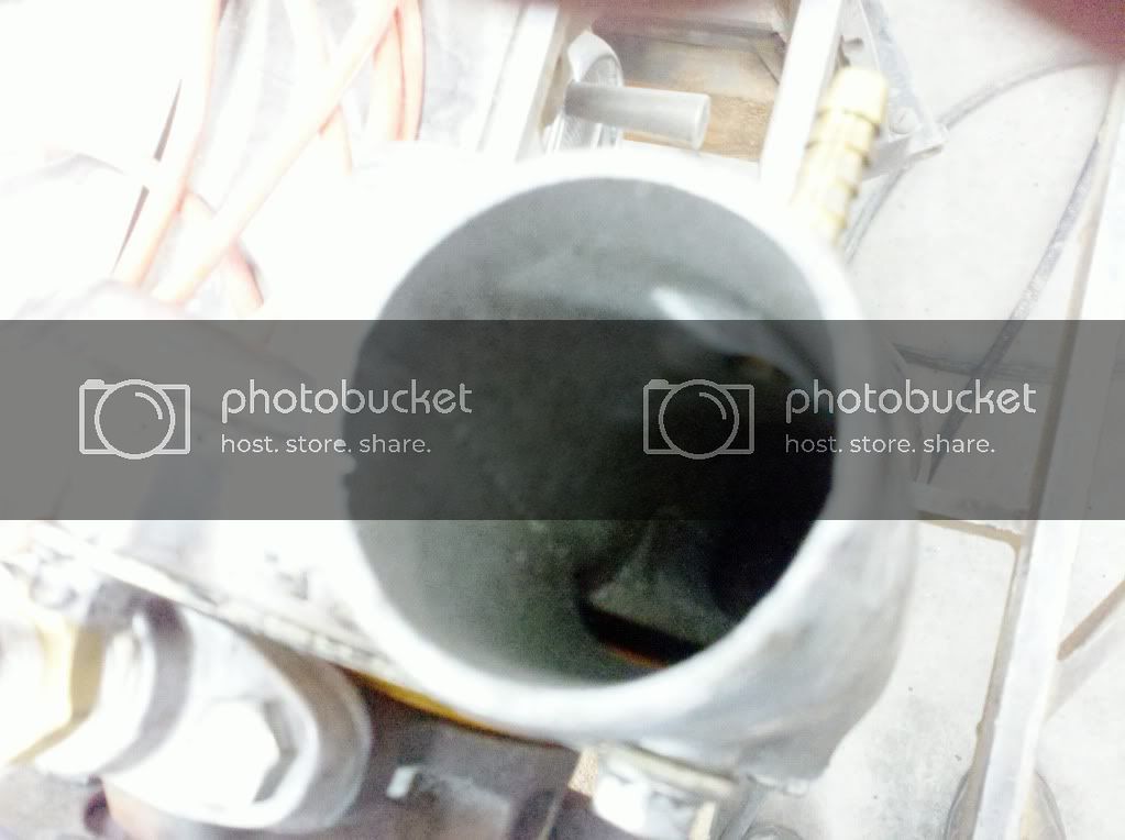

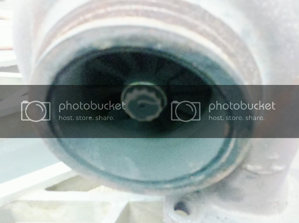

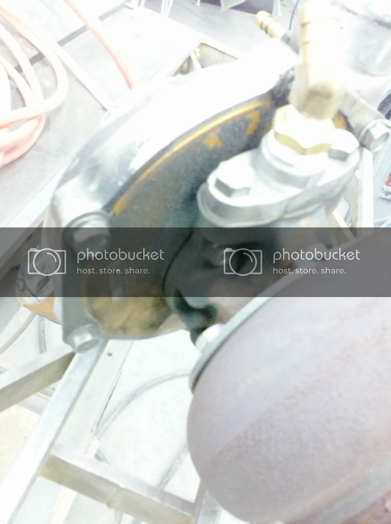

well i got the turbo out, and i got some pics as well. i completely forgot that i changed the drain from the stealthmode setup. the way i have my charge piping routed makes it only possible to route it a certain way, and the braided line simply would not cooperate. so this is what im stuck with:
inlet on the turbo:
outlet:
exhaust side:
this is the outside of the turbo. i obviously have a leak somewhere:

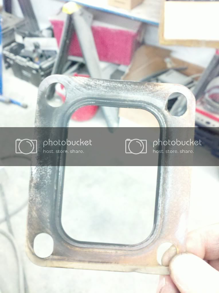

also had a leak on the gasket for the turbo, probably not relevant but still notable:
thoughts?
edit: sorry for the shit pictures, my droid fails at taking pics in the shop for some reason
It looks like your drain flange goes to a reducer, then a brass 45, then hose, then another brass 45? Can't you take out the reducers and use larger fittings and hose?
Looks like it to me, I've never seen a reducer on the drain like that.
That is possible the drain line could be to small... I would to try and get a bigger drain line and make sure there is no flat spots..
fuck, that means im probably going to have to redo my charge piping as well. as of right now there isnt another way to run it
ill try a larger diameter piece of hose, and im also taking the turbo in to have it looked at and be sure that everything is in order. there is a slight amount of side to side shaft play
