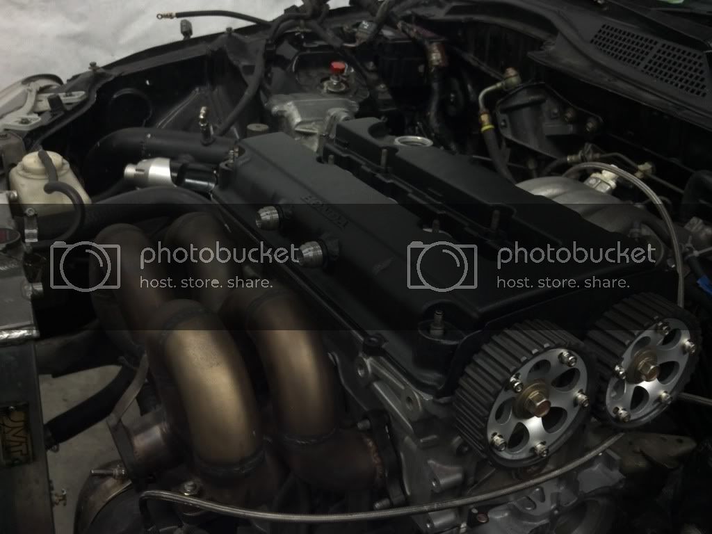

I did manage to get the valve cover painted last night.ill post pics later when im on my computer.
I used truck bed liner on it so it'd be durable. I plan on sanding the letters down to the bare metal and thats about it. And yes the engine is at a funny angle because it is basically resting on a jack with one mount in the car so I can work on the broken bolt.
Looks like the challenge with the broken bolt is the proximity of the wheel well limiting access to tooling?
Yep. That's the main problem. Shoulda seen how far I had the drivers side jacked up the other day - looked like the titanic lol
