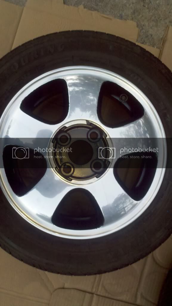

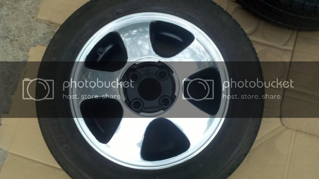

I changed my mind about the color scheme. I am now polishing the falt areas and lip and I am going to paint the inserts black or gunmetal.
Thanx. I got them off. I used a screw driver and a few easy taps with a hammer. They came right off.
Definately wanna see pics of the wheels w/the above scheme.
I am taking lots of pics. I am almost done polishing the first wheel. It is taking forever since I only get about an hour or two a day to work on them.
Well in spite of the fact that my car is down, do to a cracked crank pulley, I have almost finished my wheels. I have painted them and now all I need to do is clean up a few spots where the paint bled an then buff. I will probably have to replace the center caps. They are just too beat up and now that they are polished you can see every mark and dent.
Hopefully the only thing I messed up when I broke the pulley was the pulley. If so then it shouldn't take too long for me to get the car running and take it for a drive with the new wheels.
I will take better pics when they are finished.
