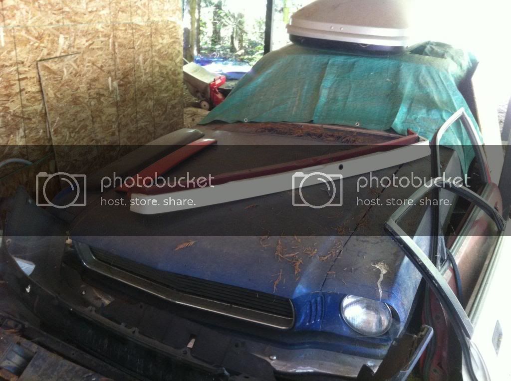

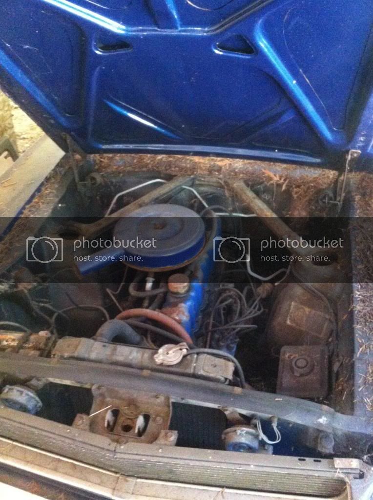

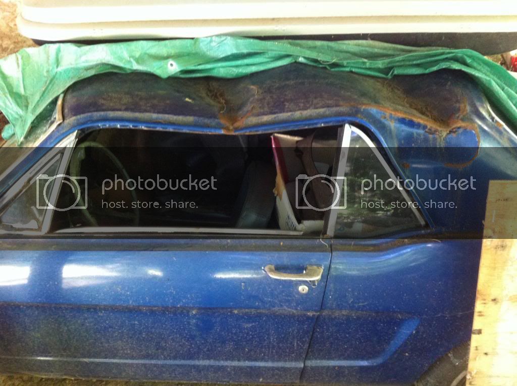

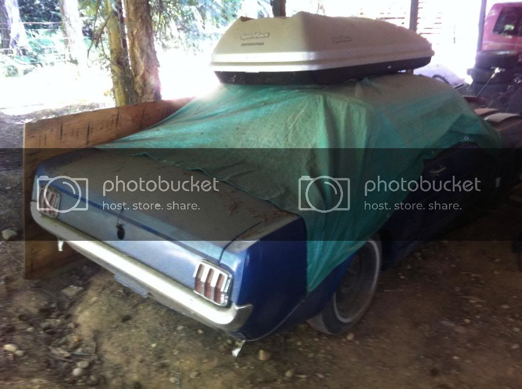

Don't mean to spam your thread but my father and I also have a '66 notch back with the 200ci, did the Maverick front disc swap and 8.8" rear as well. Got the rust cut out and repainted then we had a heavy snowfall and it collapsed the shop...now she sits
Ughhhhhhhh that is horrible, good lookin car ya got there. Looks like it was a solid platform to start off of. What are your plans fix the roof or cut it off and get a donor roof to weld on?
My dad wants to make it a year round convertible (don't put any top on) but I want to make it a fastback, there are kits for it. Something will happen eventually haha
good to hear your not gonna give up on it. The problem with makin it a year round convertible is the torque boxes and inner rocker panels are totally different from an actual convertible. Your gonna have to do some serious strengthening to that car to run it with the top off other wise it is gonna cave in in the middle. If it were me I would find a rotted out fastback on ebay for like 500 bucks and cut the roof off and splice it in.
That eBay idea is good! And yeah was a while ago, the shop was unfinished I bet you 2 cross bracing 2x4s would have saved it lol. It took out the mustang, our boat, buddies boat, and minor damage to our jeep. Missed the s2000 by inches lol :) insurance paid for a new better shop and were still f'n the dog on working on the mustang
