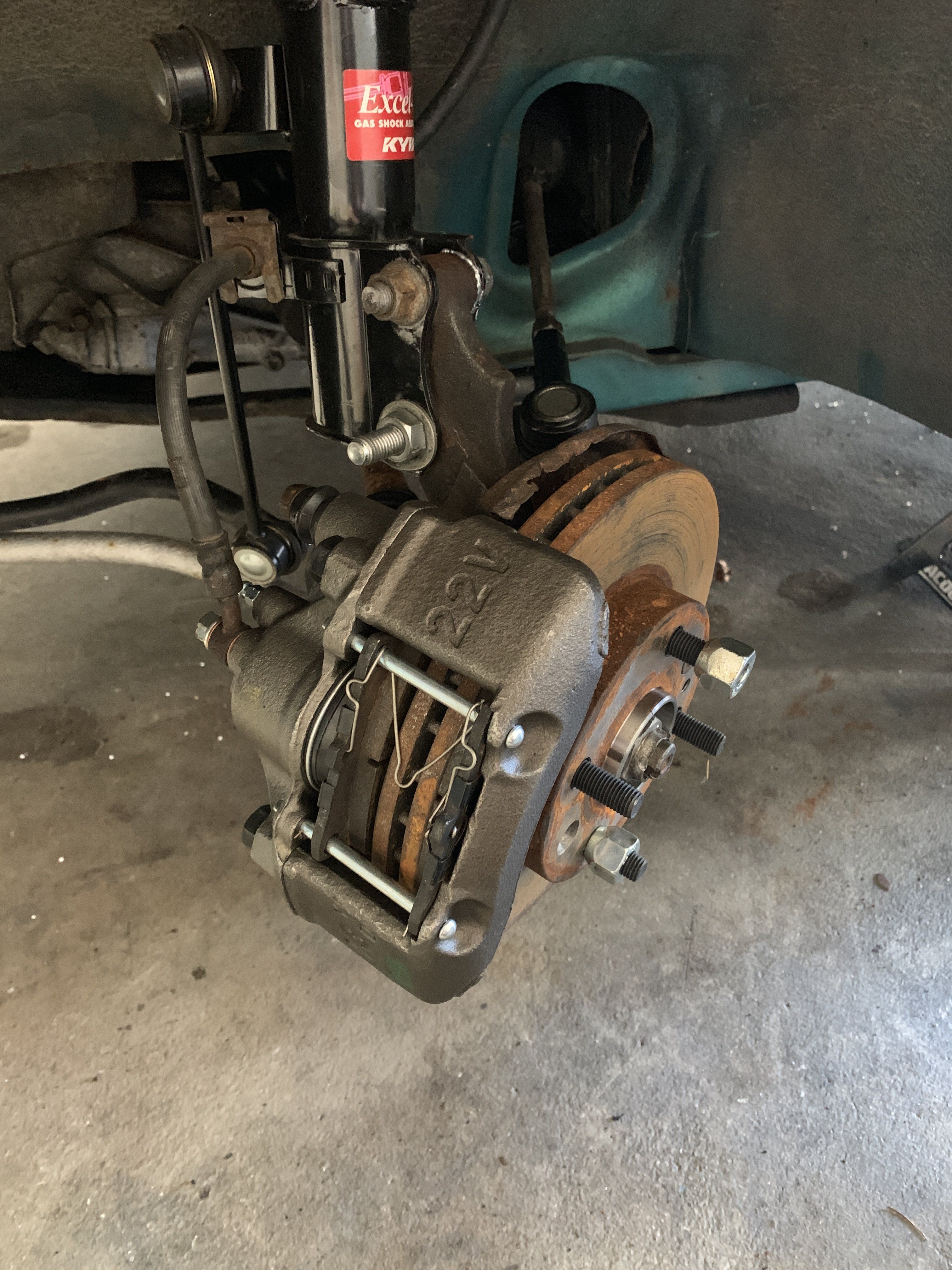

Got a chance to finish drilling and tapping the caliper mount on the knuckle. Ran the tap through the other hole as well to clean it up. Bearing on this side is measured already so it can go back together next.

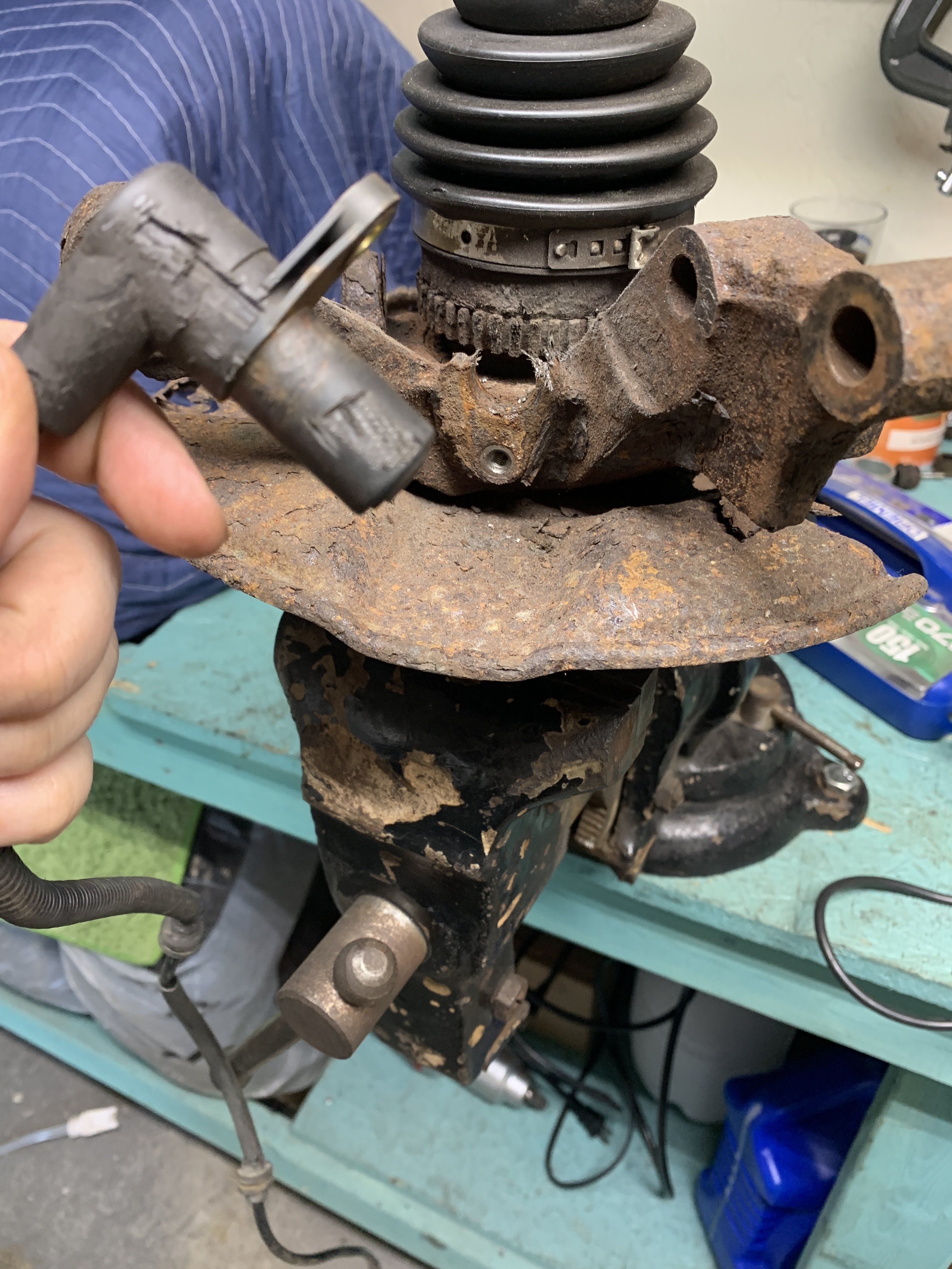

Got it all back together. New caliper and my drill and tap of the caliper bolt hole worked and is holding fine. Then I cut the speed sensor out of the junk knuckle and installed that.

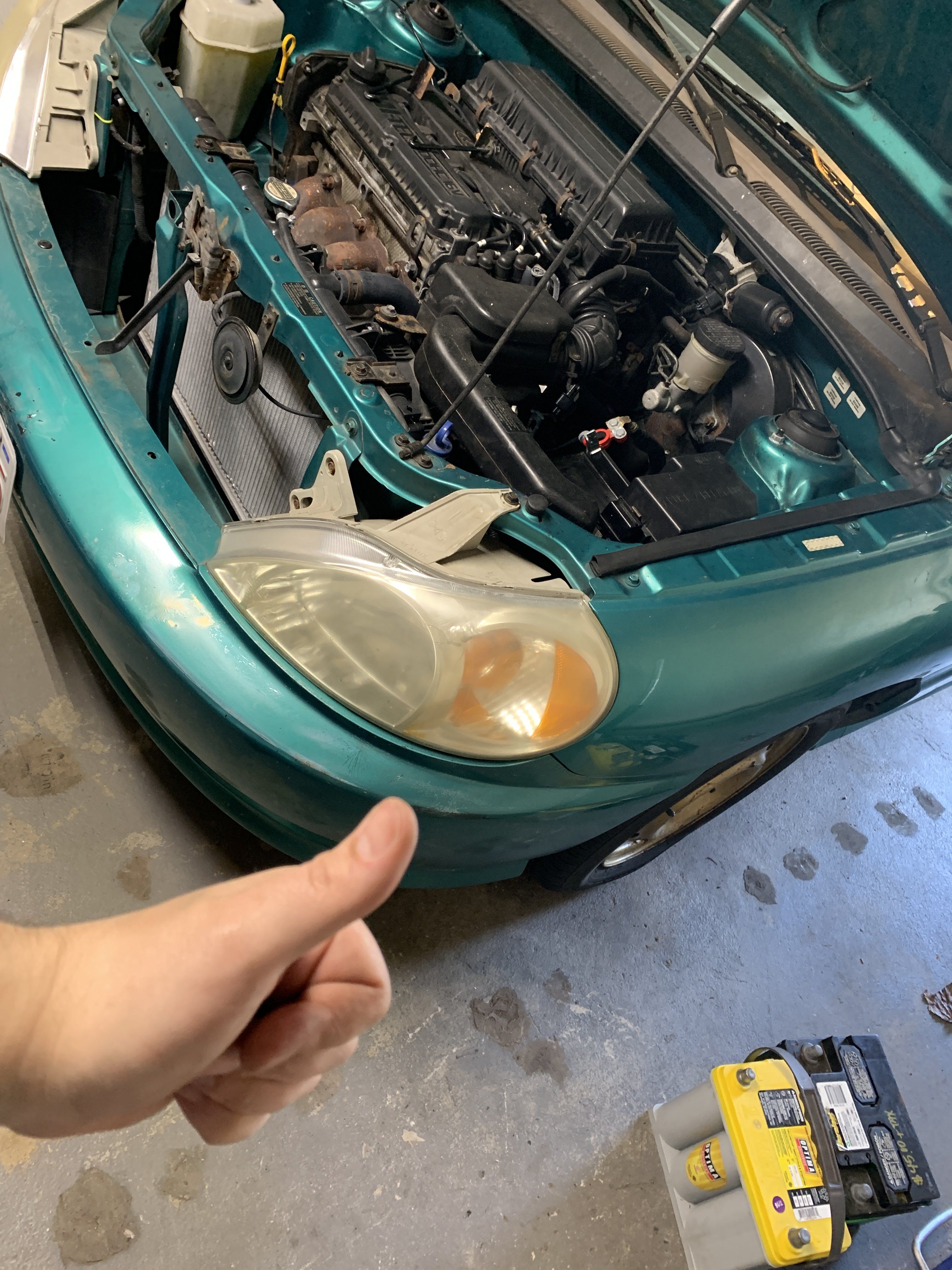

The yellow top wasn’t completely flat so I jumped it and let it run for awhile. It started right up again after so we will see lol
Now for a bath! Been in the garage since October.

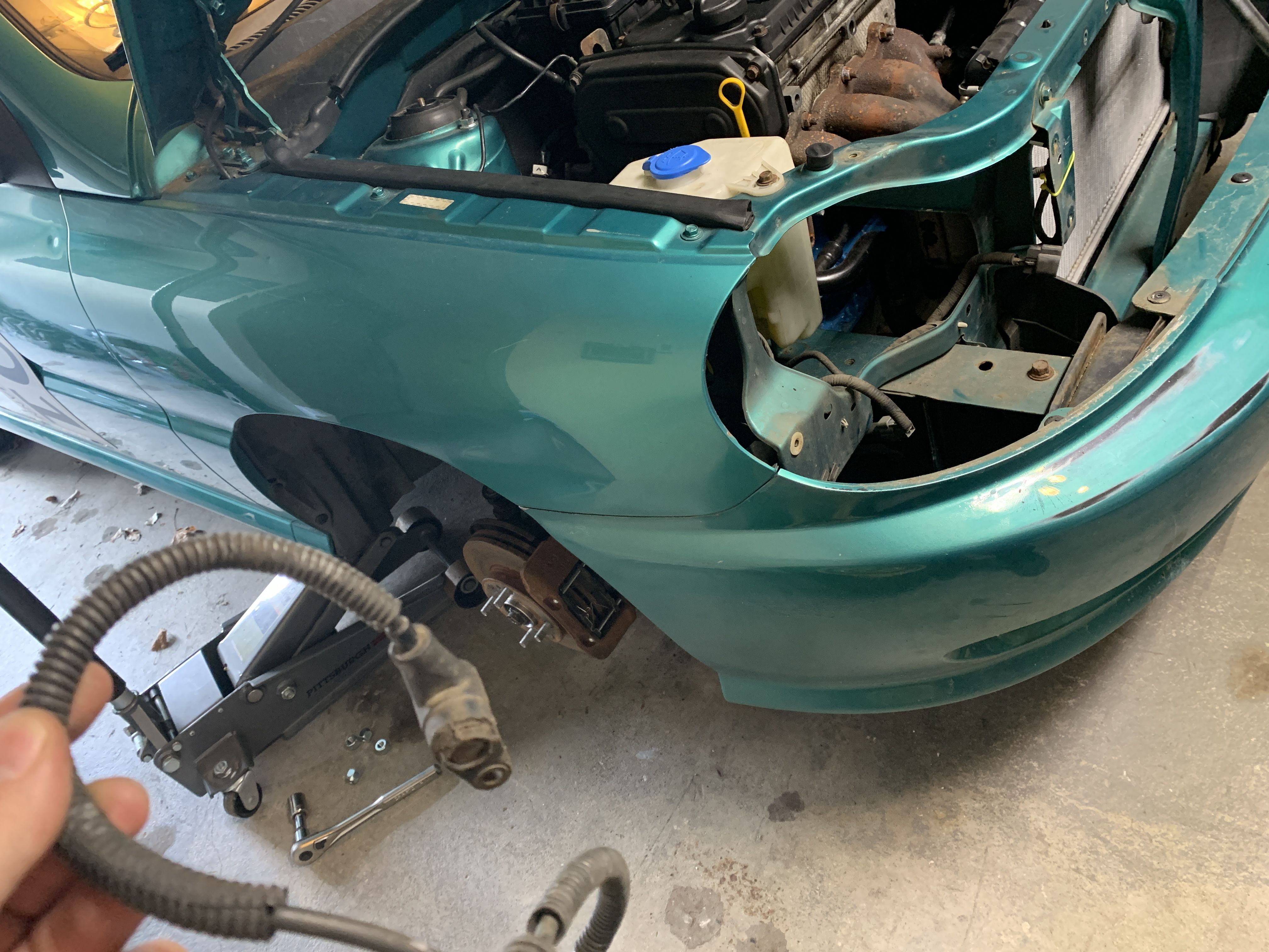

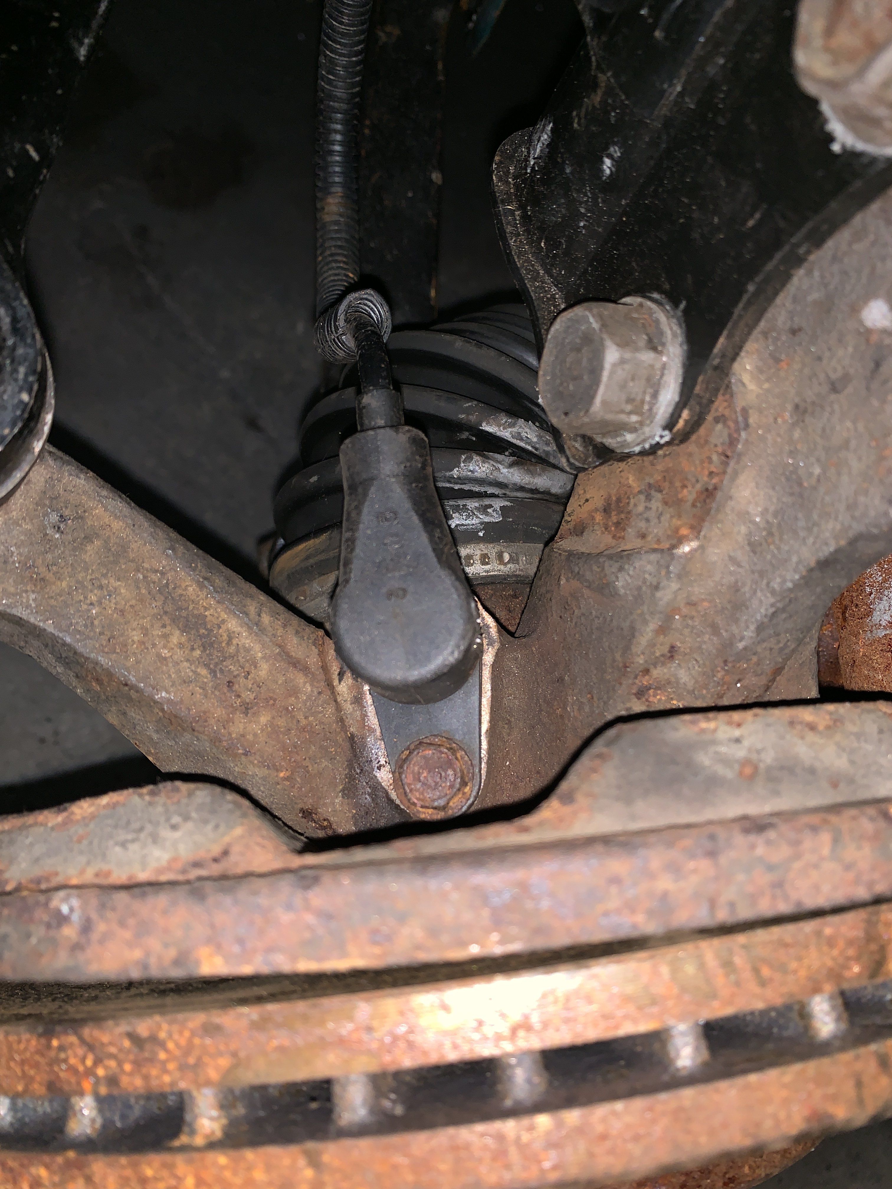

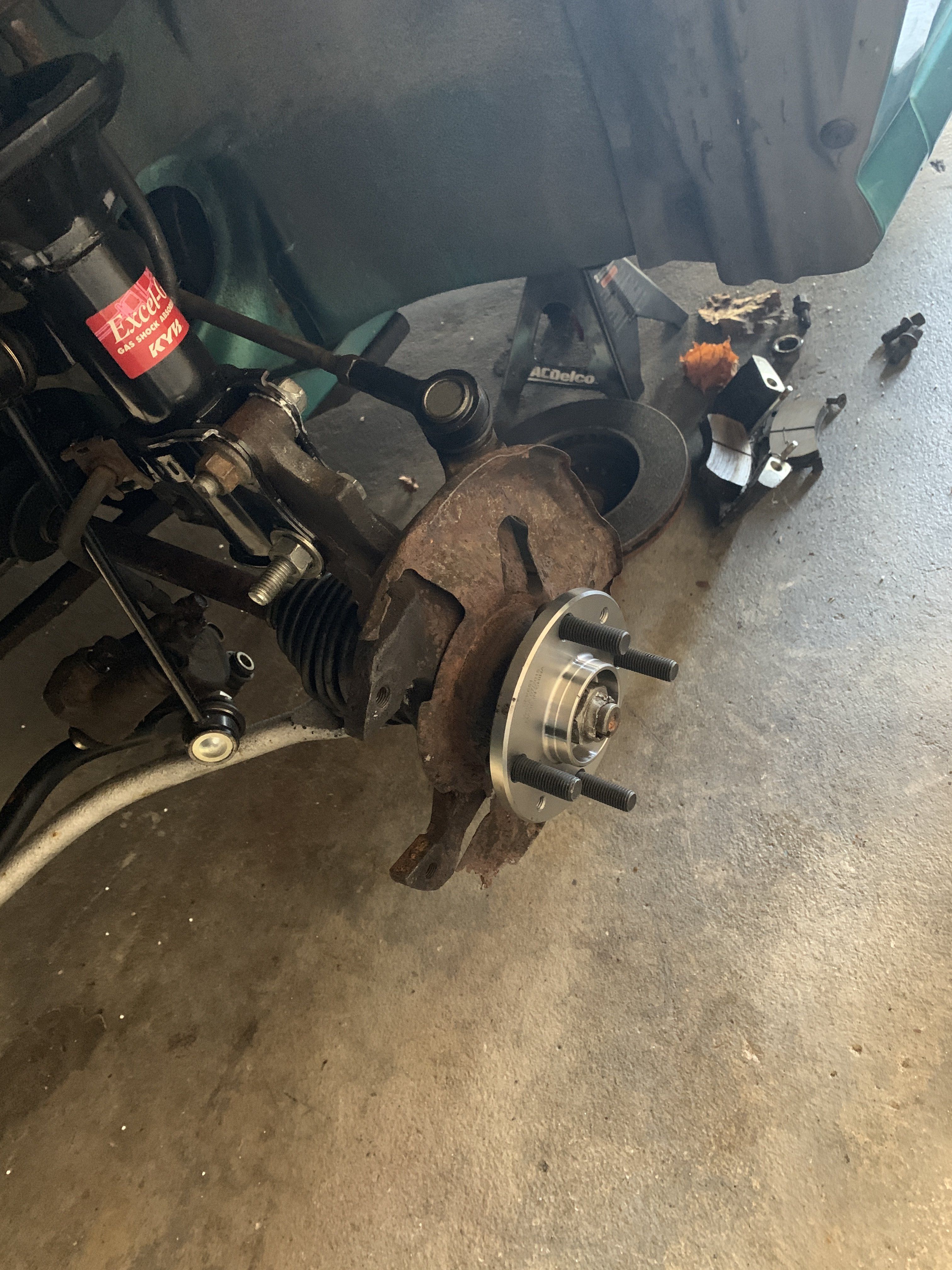

Finally have time to work on the sedan again. The pass side knuckle still isn’t right. I disassembled it and the races basically fell out. I checked everything on the bench again and there was play that wasn’t there before. I shaved the spacer again 2 slots on the chart and torqued, great. Put it on the car and it’s still got a small wiggle, so I’m scrapping this knuckle. I grabbed a good one from the yard for 26 bucks and I will drill the bolt holes to fit studs and toss it on the car. Hours of work wastedpreppjng this knuckle, FU stupid bearings.
Slammed studs into this bad boy ready to put on the car!
