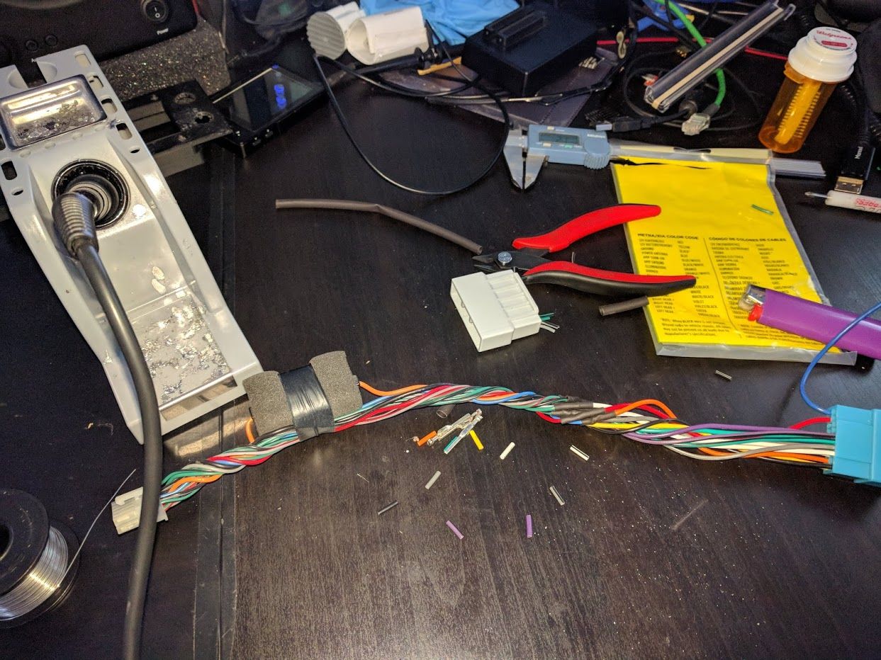

Nice! I wouldn't twist the whole harness though- you might pick up interference in the speakers from having your power line wrapped in with the rest.
Yeah, I later decided against doing that too, so instead I depinned each of the speaker pairs and twisted each one independently, then leitz braided the ground, batt, key, and dimmer together. You know, because it'd bother me otherwise, lol...
