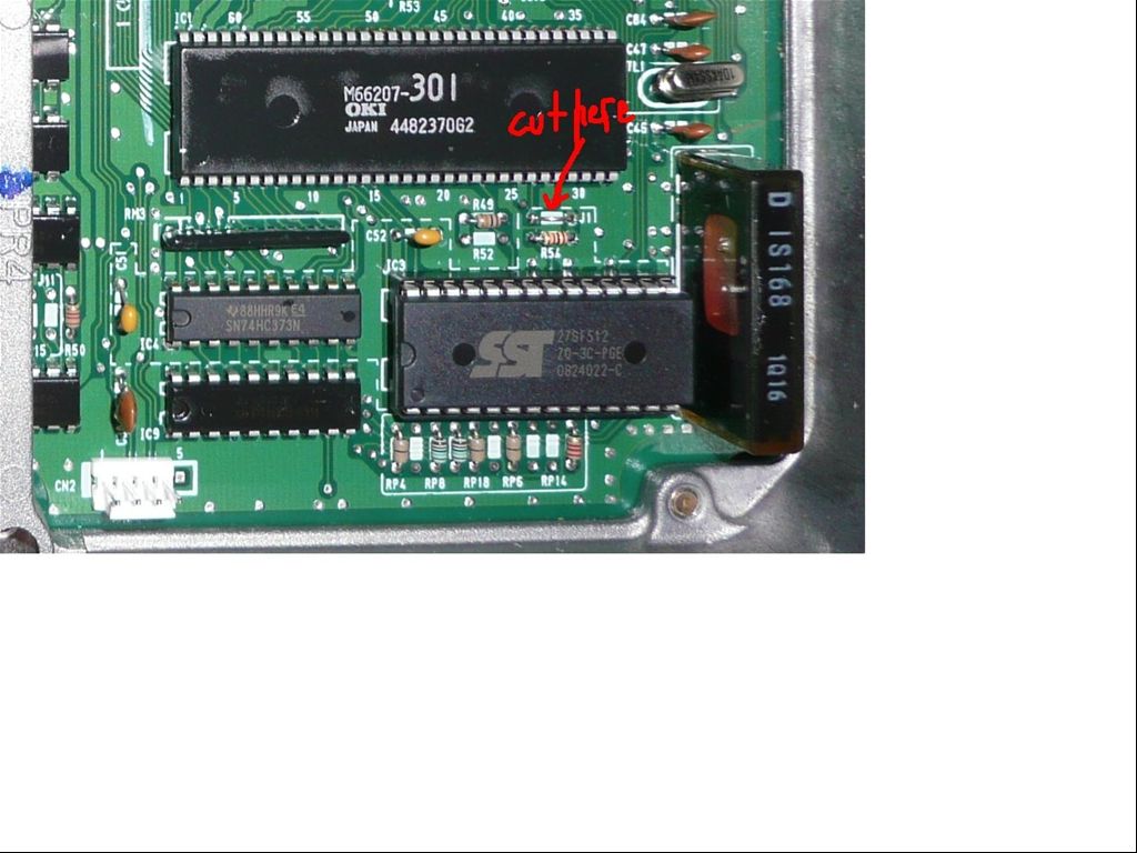

so can I just remove the SST chip?

That looks to be a P28 ECU; it already supports VTEC. Just cut J1 to disable the chip. Wiring VTEC wouldn't effect the emission, but I have a feeling the chip may be causing it to fail. Check for vacuum leaks also.
Yes, the SST chip can be erased and re-burned.
So can't he run a P28 with the D15B VTEC basemap? (I am actually wondering if its different anyways) That way he has the luxury of VTEC too? Or the JDM correct ECU should be easily available too?
He asked about swapping in a 88-91 ECU, which would get rid of the jumper harness. Yes, you can run a P28 with D15B basemap. I actually did that for a while but you have to pay attention to the settings. 88-91 and the D15B VTEC came with 1-wire O2s and the P08 does not use a Purge solenoid, so purge and O2 heater would have to be disabled.

If I cut the J1 will that permanently disable the VTEC controller? Or, is it just related to the chip they put in? And when you say "cut", do literally mean cutting the connector on the backside of the chip(I don't have it in front of me so I'm really just shooting off the hip)

No. They installed a piece of wire that literally jumps J1(hence turning the circuit "on"). Cutting it makes it revert back to the stock ECU(ignores whatever chip is in there).

as for the serial number, are you looking just for the number on the chip itself?
276F512
70-3C-PGE
0824022-C
is this what I want to cut?
I dont know if you should cut anything right now. The bar code with the numbers on the outside of your ECU....thats what I am looking for. Its a sticker. Well....it does say PR4 in the left middle of your picture but I'm not knowledgeable about ECU's. You have some type of map on that chip and it may be the correct one.
Edit: Forgot you said the sticker was gone!!!!
Yes, that's J1 that you cut to disable the chip.
Take the chip out, send it to Xenocron and have them put a stock P08 base on it for you, its a mystery ECU, so it wont have the right maps for your motor if you just cut the jumper. If you get the right base map for the motor everything will be how it should and there should be no reason you shouldnt pass emissions.
^^I agree...this is a good option. I am betting that it already has a base map for the D15B but having someone who knows how to check/change is a good idea.
