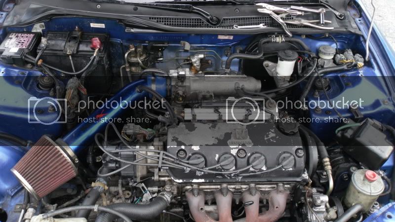

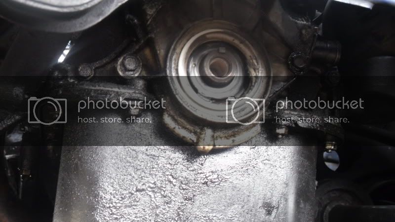

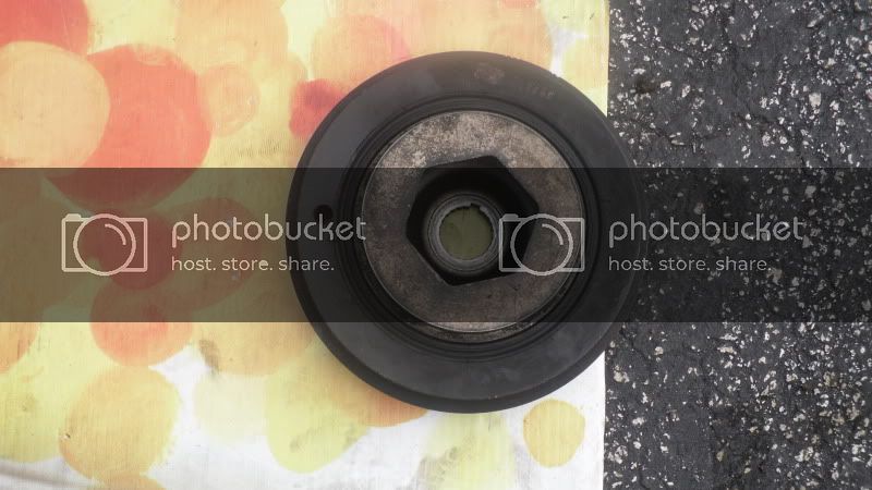

Well the Sol's been sitting in the driveway for the past week now and I finally got the crank pully off today so I can fix back the timing belt. I bought the Honda/Acura crank pully tool at NAPA then I bought another an extra 24" breaker bar at Harbor Freight and another 17mm deep socket since I broke my first one.
Unfortunately night came down too fast so I'll have to finish up tomorrow and crank her up :)
I also put on my front lip today and bought some new OEM del Sol mudflaps on eBay :D Those should be coming in the mail sometime next week.

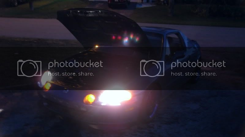

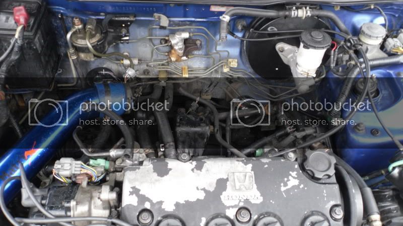

Holy crap Batman, the del Sol is up and running :D
Soo today I put the timing belt back on and tried to crank the sucker up, but it still wouldn't start.
After a few hours of trying to find out the problem I temporarily gave up and put everything back up that I took apart.
Went back outside and tried starting it up again, but it still wouldn't start so I went down the check list. The engine had fuel and timing, but I wasn't to sure about spark.
Pulled out the spark plugs and they were burnt to toast. So took a trip to Advance Auto Parts and bought a set of NGK Spark Plugs. I put them in but car still wouldn't start. I narrowed it down to the ultimate noob mistake.....spark plugs in the wrong order. Went online and found the D16Z6 firing order and mine was completely backwards :(
Never the less I put them in the right order and cranked the engine one more time and watched the beast start up :D:

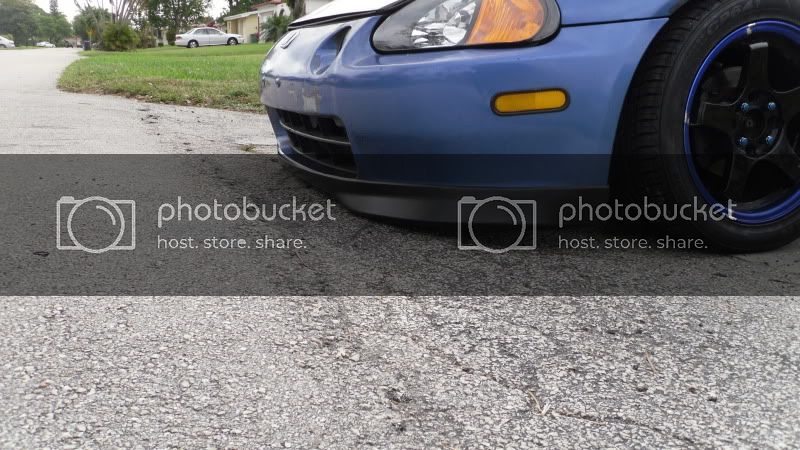

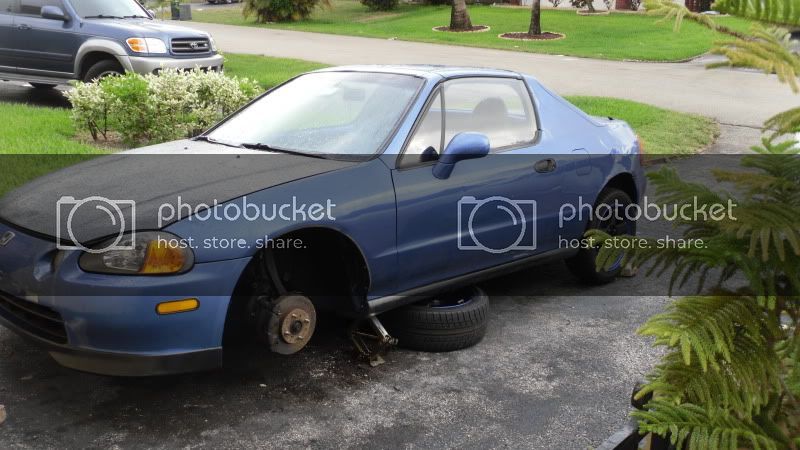

Damn :( I can't even make it out of my driveway anymore lol.
Not taking the lip off either so I guess it's just going to scrape away haha.
Or you could lift the car just enough to clear it.
Thats what I would do.
nah man, you can just gotta learn to take things at big angles and slowly.
ive seen his car, its not that damn low. its not quite as low as mine and i make it over lots of bumps and dips still, and i have the same lip.
Yea my car is nowhere near slammed/tucked . It's just lowered a tad bit to close the gap inbetween the wheel and fender.
My driveway just has a ridicolous dip at the very end. If I was to raise the coilovers back up I would be back to 4x4 status ha.

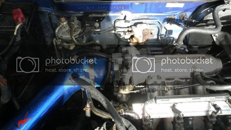

Left my house around 8:00am so I could go to Walmart and pick up some oil and coolant before I headed out to the meet. Well when I pulled up in the Walmart parking lot I noticed a bunch of steam coming from my hood. So left it to cool down and went in Walmart, bought the stuff, and came out. Come back to the car and pop the hood and there's coolant everywhere! It was coming from a hose attached to the FITV. I thought the hose was just loose so I tighten the clamp and poured coolant in and started to head for the turnpike. Well a couple of blocks from the turnpike the engine started to overheat so I pulled over again and just decided to head back home.
I was only about 9 minutes from home, but I had to pull over 12 times just so the damn engine wouldn't blow up.

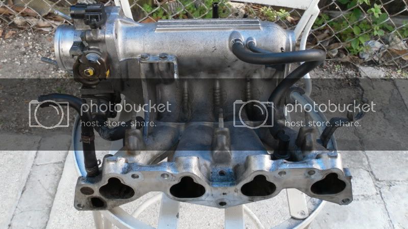

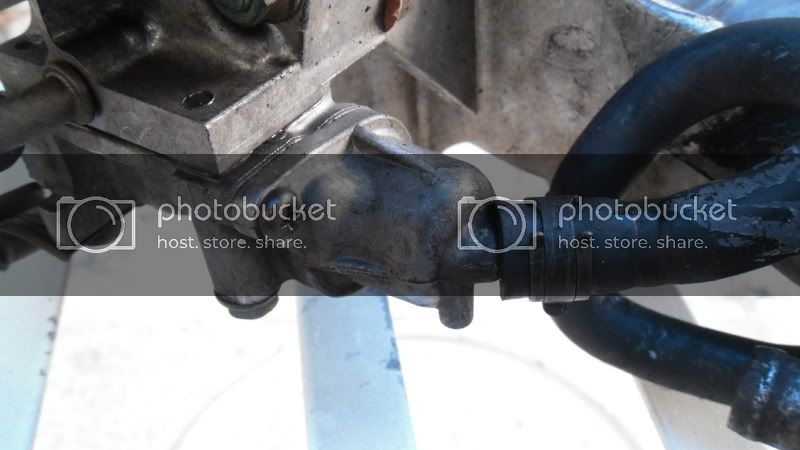

So I safely got back home and pulled off the Intake Manifold to inspect it.
This is where all the coolant was squirting back out from.

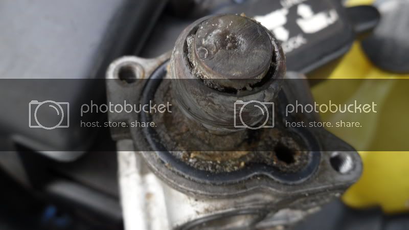

I took off the FITV and I find this :eek:
The FITV as well as the little nipple that the coolant goes into was dirty and corroded so the coolant had nowhere to go but back out the damn hose.
Gonna clean it out now and it should pretty much solve the overheating problem.

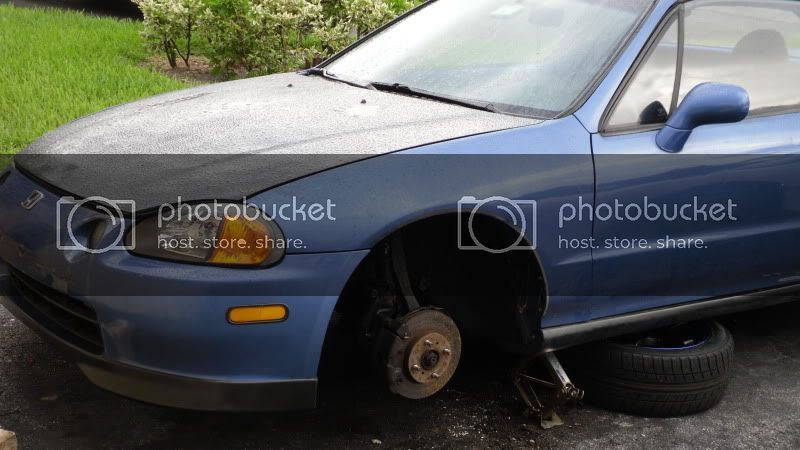

nice :thumbsup: i wish i could have the same luck with mine... i've just bought a new clutch and tranny for it and cant get the axle nuts off so we're gonna have our mechanic do it for cheap hopefully... i really like your car though looks like you are doin everything right
Thanks!
I think I need some experience on suspension and how to remove the axles. I'm pretty sure I'm going to swap my engine soon and that's the only thing that I don't have much knowledge about yet. I should start researching now.
the axles are just kinda tricky (from my experiences) you just need to heat the nuts up and break them loose im pretty sure, then push them out (i think lol)
