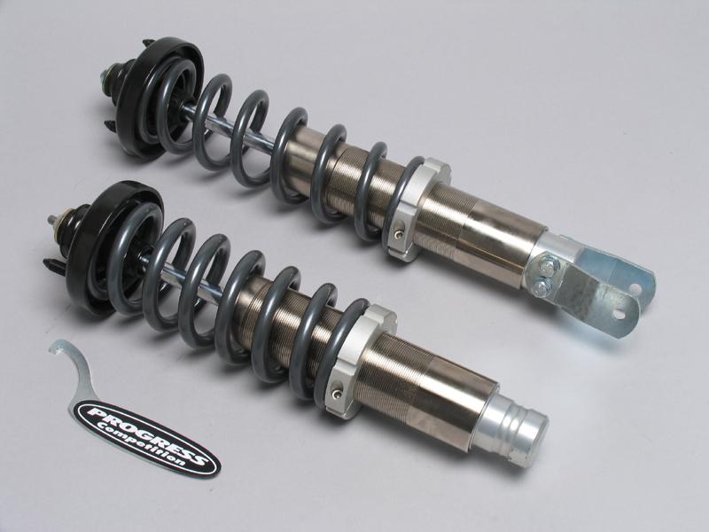

I have 2 sets I run right now for track use, 500/800 and 800/1100 with a 23mm bar in the rear on my 95 HB. Great rotation and I have been very happy with them so far but I might need to go to a more expensive setup at some point.
Im running the higher end Progress Technology that they offer with Hyperco springs which cost me about $1300 shipped. The additional set of springs was about $150. The nice thing with these is I get great support and they can be revalved and rebuilt for $75 a corner. Thats something to keep in mind, I also had that set valved for the rates Im running.

I have owned skunk2, tanabe, koni sports (shocks with sleeves), kyb (shocks with sleeves),and progress.
The progress so far have been the best for me. I have not used the koni race from them but I bet they are slightly better than what I have now.

I looked into Progress.......the machining and such doesn't impress me.

You can get what you want, I actually own the Progress and I have owned Konis as well as the others I mentioned. I dont know what would be wrong with the machining? These do what they are supposed to do I know that.

I would rather own Koni 2812s ,Koni race valved, JRZ, over my Progress but thats it.

But the way the progress attach to the rear LCA's....its not welded. Its a piece that is bolted to the shock body. It doesn't really make or break it but isn't that strong either.
