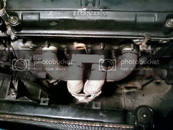

Header Install!

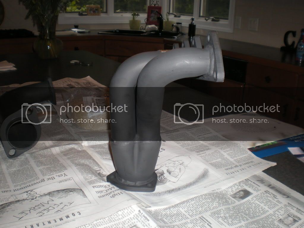

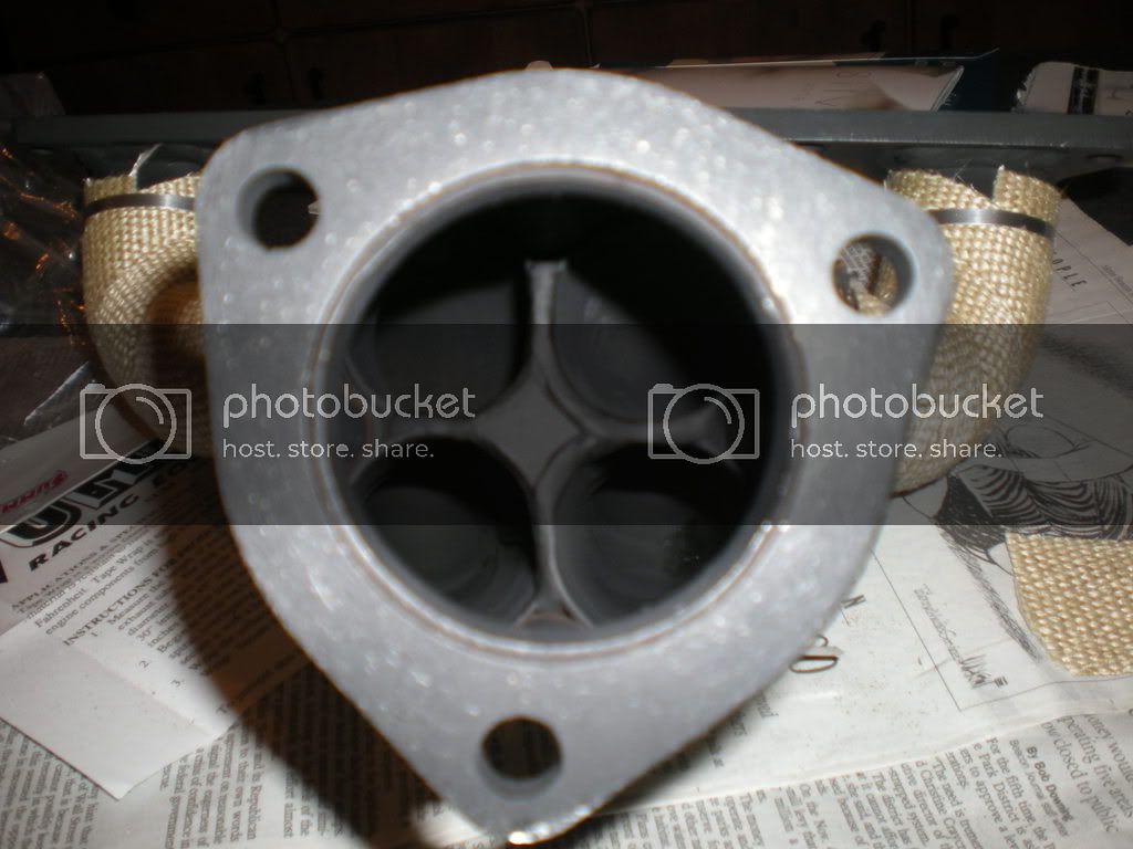

After a lot of debating I decided to go with the Kamikaze header instead of a Hytech replica. I found an article on Edyne stating that the Kami is the best for s/c hondas. Its an equal length 4-1 shorty design. I got the 2.5" downpipe in the plain high temp painted finish. $250 bucks aint bad.

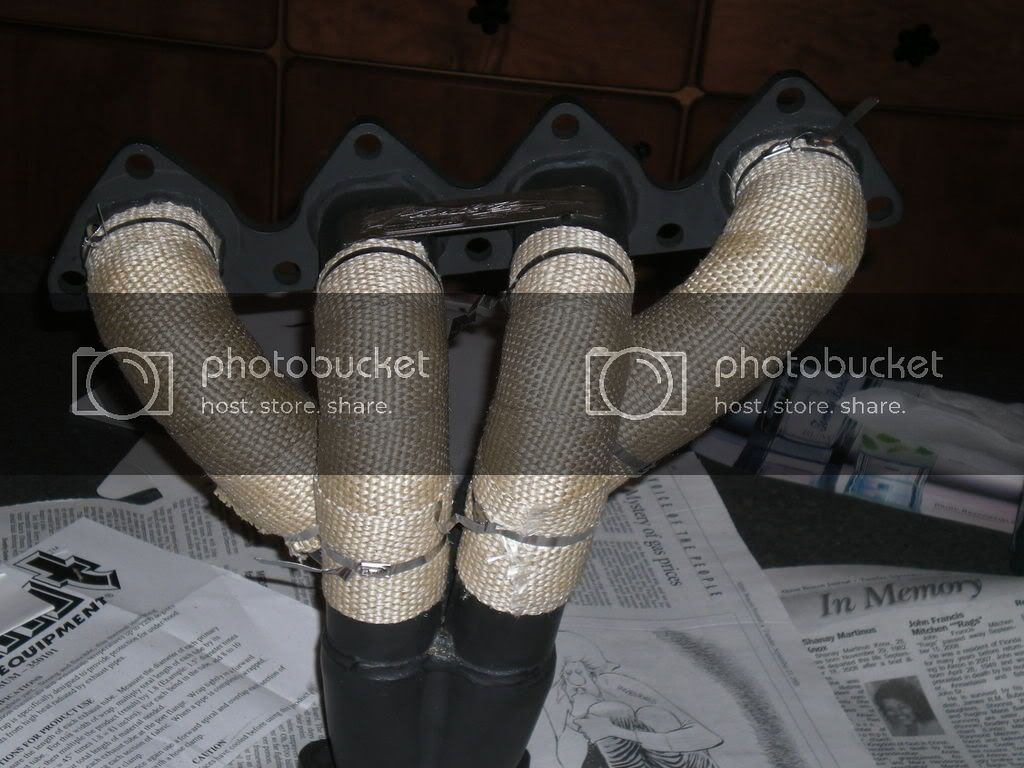

When I got the header I wrapped it in some Summit fiberglass header wrap to keep underhood temps down. Man that stuff smokes the first time its heated up.

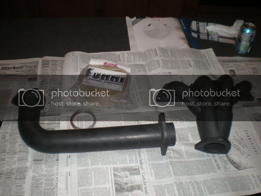

The collector exit was about 5" too short, and it was lacking an 02 bung. Luckly my test pipe has 2 ports (one for the narrow band, one for the wideband). I bolted the test pipe to the header after modifying it a little, and doing some searching for a donut gasket that would fit.

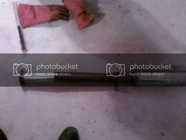

To make the 5" extension, I extended the catback itself. It was really easy because 2.5" piping from summit slips perfectly over the 60mm piping of my catback. I then sealed everything up with my mig welder. Now the exhaust fits better than it did before.
The butt dyno is showing some amazing gains! I think this shows how much the stock 2" header was choking me down. This is really evident from 4-8k under WOT. I think $/hp this is the best investment made so far. Another trip to the strip should verify this as I think I easily gained a few mph.
The only downside to this is that it made a loud car extremely loud. At idle and part throttle it has a nice toned rumble. Under WOT it screams. All the raspyness from before is gone, it is just deafening, especially when behind the car.
