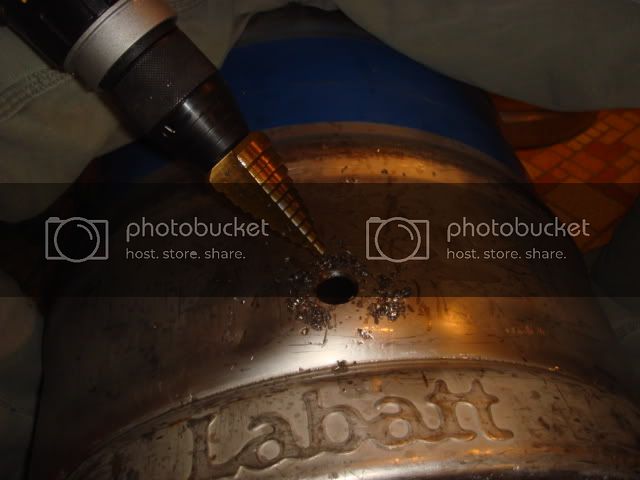

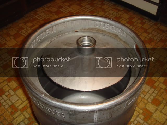

    Well, this is how I've been keeping busy during the freezing cold months of winter.

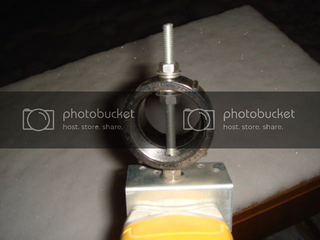

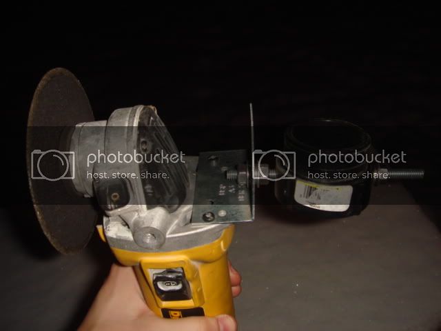

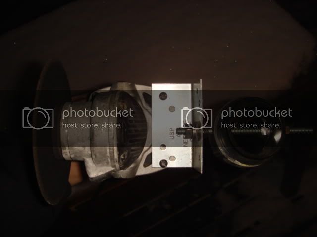

    Here's a few pics of the kegs and the angle grinder jig I made.

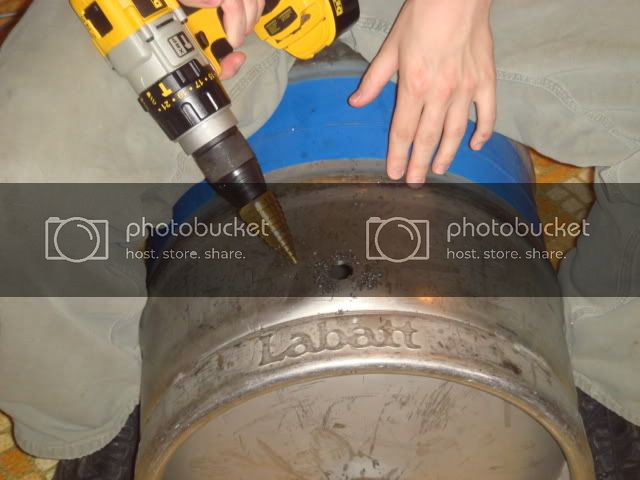

    Drilling the holes with step bits is a PAIN in the ASS. Don't get a cheap step bit, this one lasted one hole before I had to go buy a decent one.

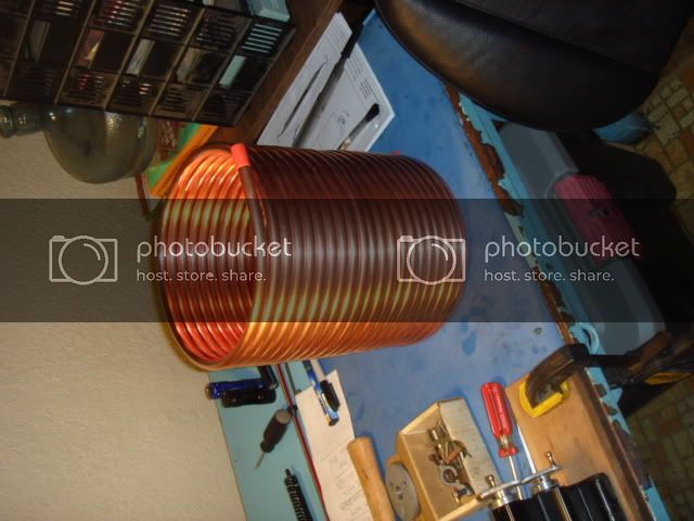

    Here's the 50' 1/2" coil. I wrapped it around a corny keg.
    Tiny fingers are best for getting the dirt out of the crevices.

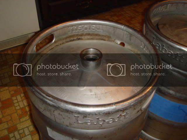

    This will be the boil keggle.

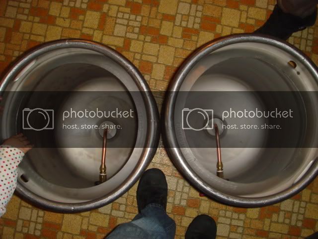

    Here's the Mash Tun and Hot Liquor Tank with valves and pickup tubes installed.
    This is the HLT showing the holes for the coil.
    Now I need to order sight glass/thermometers, hose and quick disconnects, and a pump before this can proceed.

    Sweet! How much did the copper pipe run you? I've been looking to make a compressed air dryer out of a coil of copper tubing like that, submersed in ice water to chill the air inside.
