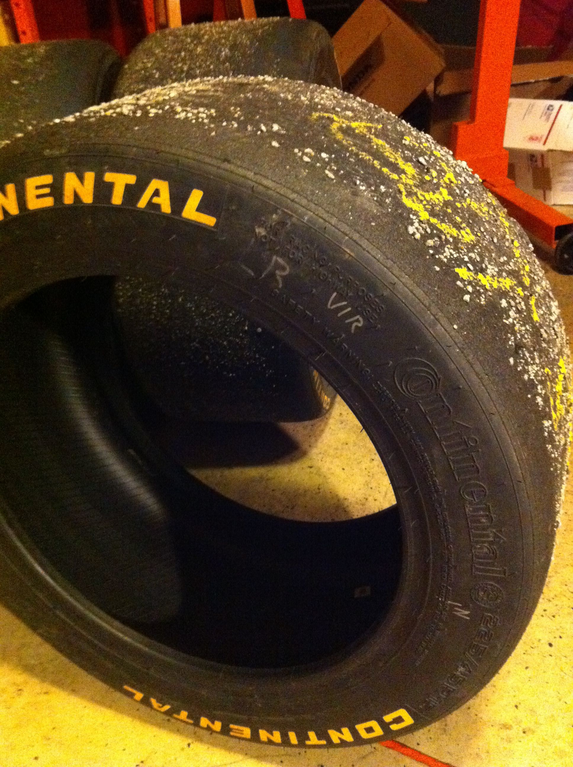

conti take offs ....these should be fun!
225-45-15
I think he ships them too, he has like 9 more sets at that size.
I paid $200
The guy runs a tire store locally.
They arent legal for scca or nasa I dont think because they are not dot.
Ya, those tires would bump me into TTS.. +30 points in TT for those tires!? crazy.

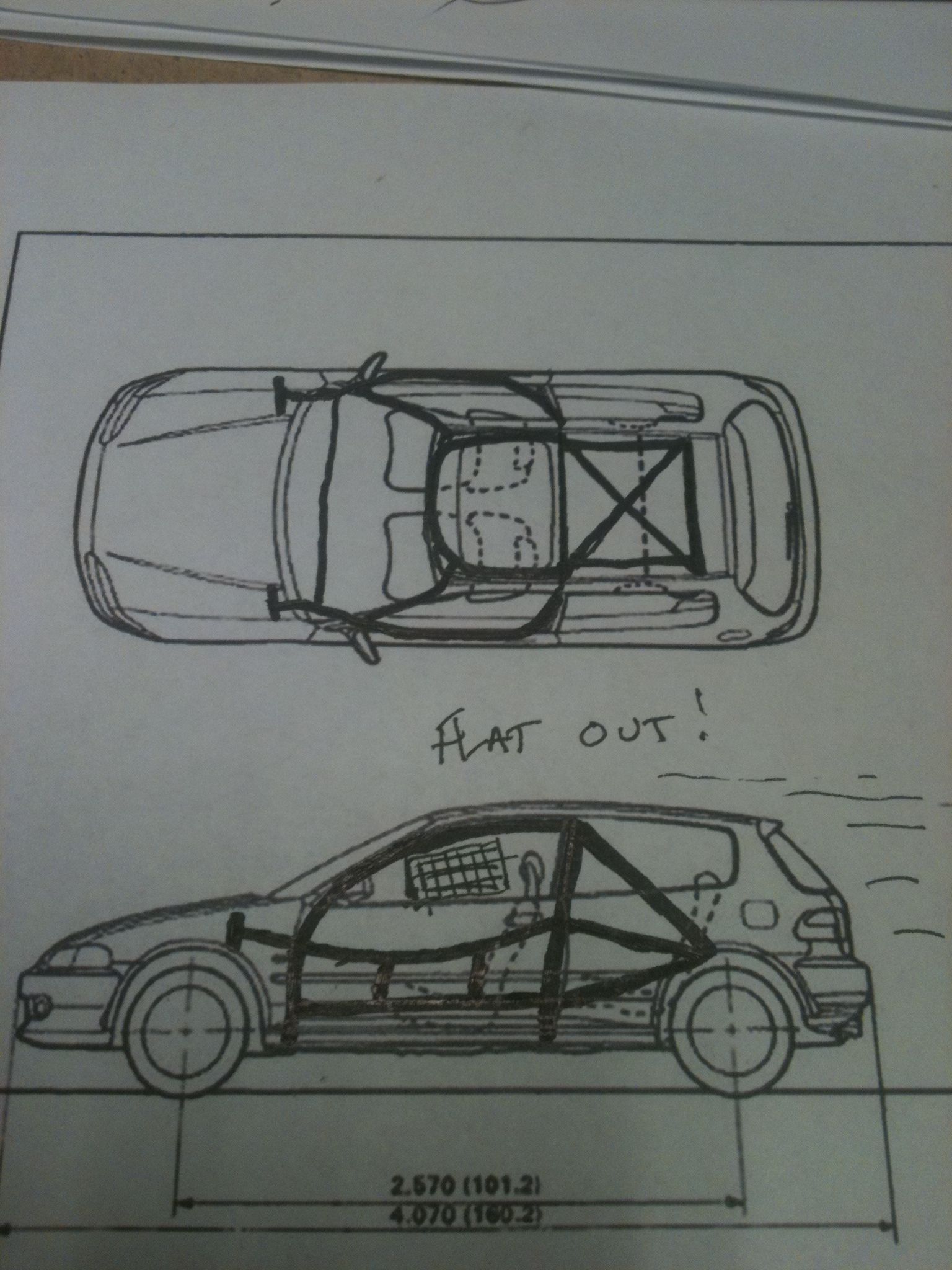

The roll cage guy Im meeting with Saturday so hopefully his quote is within reason considering I have a pre bent kit.
Here is my shitty design. The x bar would connect from the rear shock towers to the shoulder bar.
STL is Super Touring so you can go through the firewall to or past the shock towers no further than 31 inches past the front axle.You can also have as many points of connection as you want on the interior.
I met with the cage builder today and was shocked at the pricing, $1200 to put in my pre bent cage or $1900 to do a full cage at a smaller and lighter weight. The cage I have now isnt a perfect fit but is close. Im trying to sell it so I can go with the full blown custom done IT Improved Touring cage which will not allow shock tower monting but will allow me to drop classes if I cant hang in STL. If I do well in STL and feel I can compete I will have the cage gusseted and extended through the firewall.

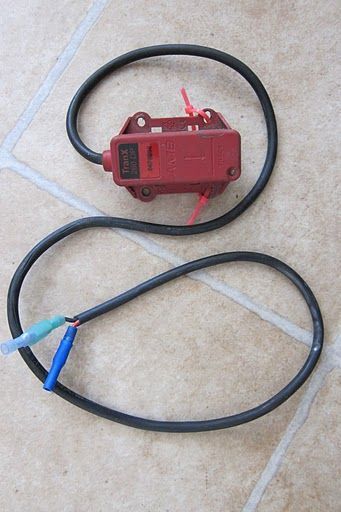

Used transponder, no choice I have to have one

Nice! I had a hell of a time finding a used AMB, had to end up buying a new one. Cool shirts FTW.

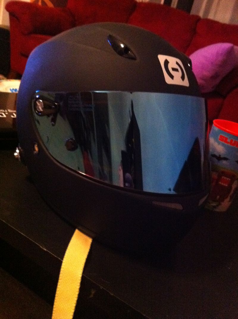

I needed a new helmet because mine just didnt fit properly.
I went with an HJC AR-10 II 2010, I couldnt find a black si 12 2005 under $500 and a 2010 si 12 is $700 so I went with this one. The si 12 isnt worth the double price for the lighter weight anyway. The 2005 si 12 you can find for 350-500 in white and black if anyone is looking. Installed my hans attachments and test fitted, everything seemed good. I also bought a tinted blue lens which is installed in the pic.

That seems a bit steep to be trimming and welding in pre bent cage bars.
Have you considered shopping around?
Also, I'm not sure what the rule book says but DOM tubing is just ERW that is Drawn Over a sizing Mandrel after it is welded. This makes the size of the tube more exact. So a 2" ID dom is closer to 2" than a non DOM. Otherwise, the metallurgy, wall thicknesses etc. should correspond. All tubing is ERW, or electronically welded.
The idea that DOM is somehow so much better is really an enormous myth, perpetuated by people that sell products made out of "DOM" tube at a premium.
