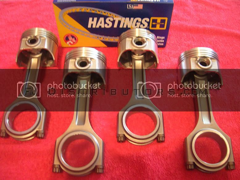

Got my camera charger back, yay! Here is the next item on the list besides studs.
YCP Vitara's - I am going to stay with the standard bore on this one.
FJT Custom Length Rods - I will have to notch the block but I don't have any problems with that. Eagle H-Beam Rods give too low compression ratio's so I am going with these designed specifically for the YCP/Suzuki Vitara's.
Eagles compression = 7.8:1 and FJT's are 8.8:1 I figured it will be better to stick around 9ish.

Thanks for Subscribing Afro Samurai! All of that is true, the head gaskets used, shaving the head and Rod Length also. The Eagle Rods are too short and you would have to mill too much from the head to bump compression up enough and still be dependable. FJT's set the Vitara pistons flush and the bottom of the block must be cut out *decked* below each cylinder to make room for the rods. I think a normal 3-layer gasket will be used, I try to keep my gaskets, bearings and seals all OEM as possible but I will be using a Golden Eagle or Hondata Intake Gasket probably. No apologies needed for a good question! ^_^ I will actually need to do more research in this area before I choose the head gasket, Thanks.

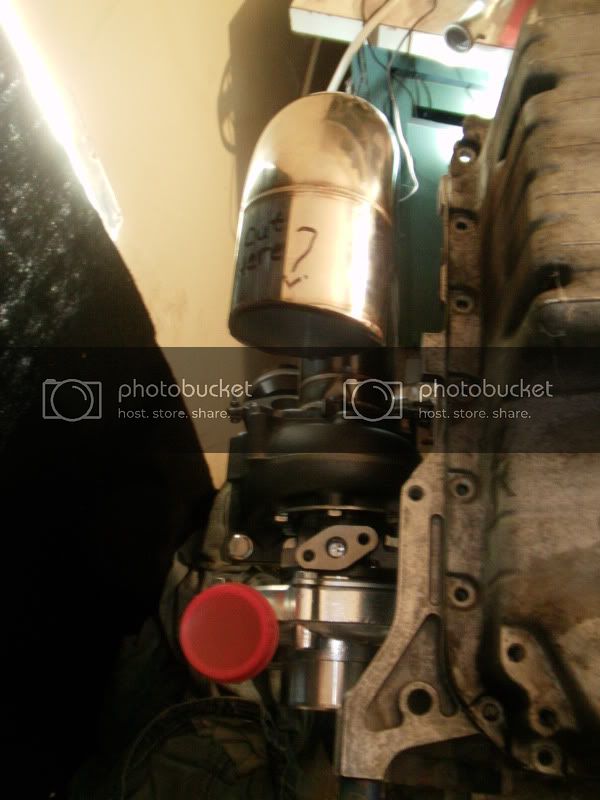

Can do, I got the downpipe welded up *even though it looks like shit* it should work well. Still waiting on cash again, Women are dough sucking leaches among other things. lol Now that I have a little extra time and should have some extra money soon and the blizzard cleared up I should be starting to update again. Thnx

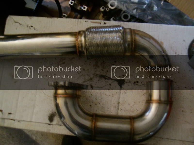

I am running a little slow with the updates but I had originaly planned to be finished in around May, 2010 so I am not too upset about the progression. Here are a few pics I snapped a week or two ago. I am ashamed to post images of the downpipe now, my welds are hideous but they are strong.
