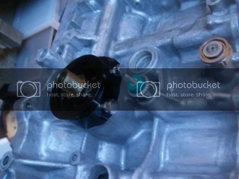

Pod sitting on the y8 block

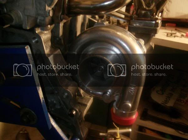

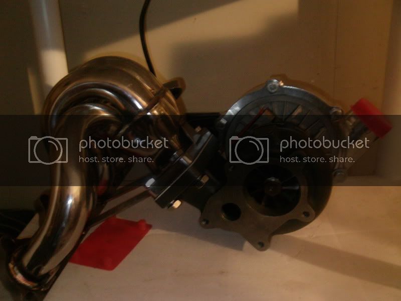

Bolting up the >anifold and Turbo

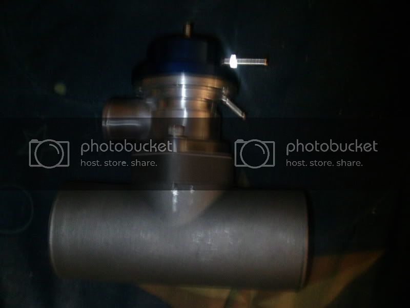

BOV

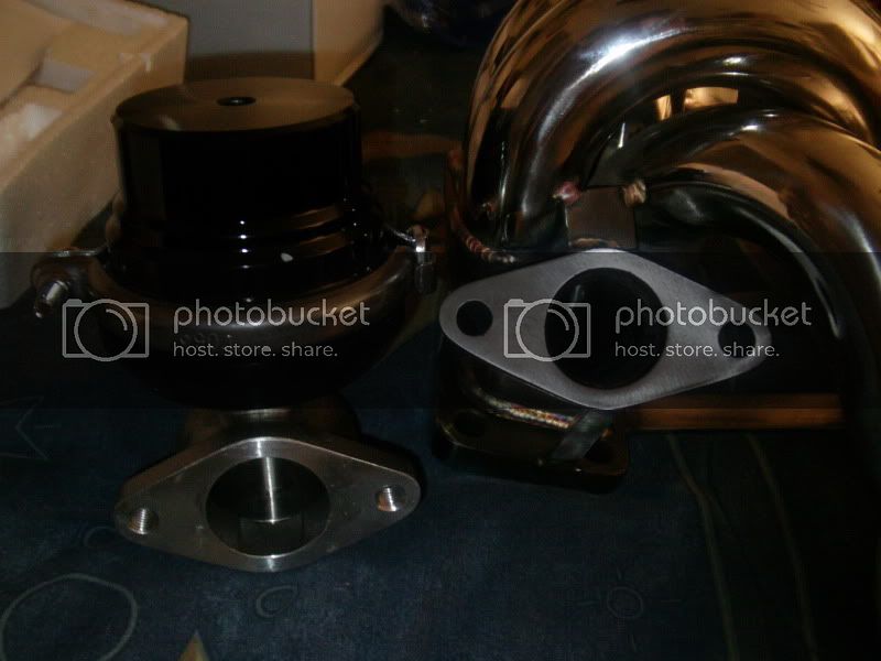

V Band WasteGate

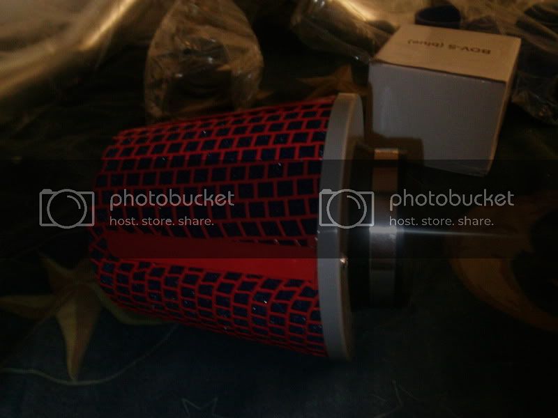

Cheapo Depo Filter

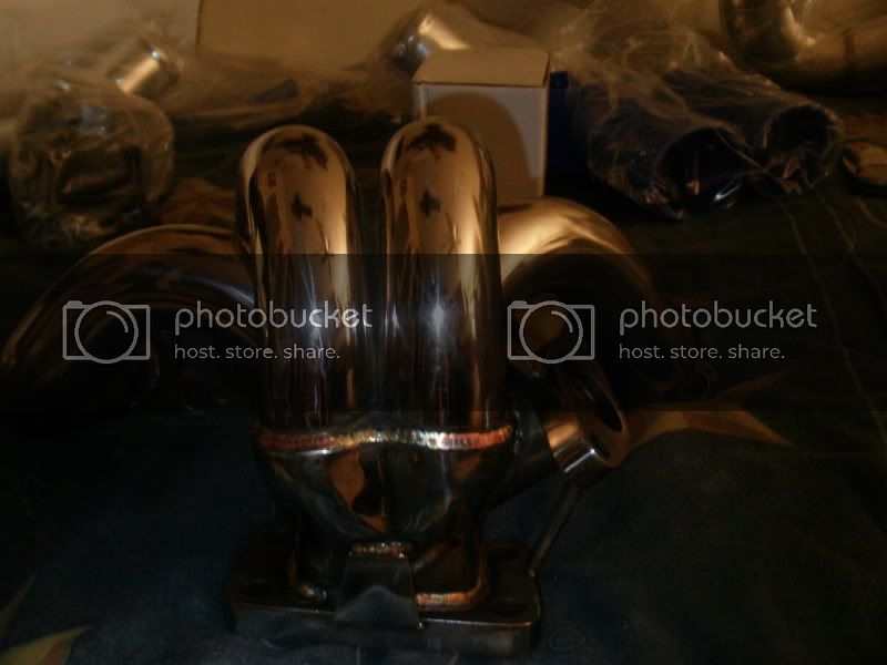

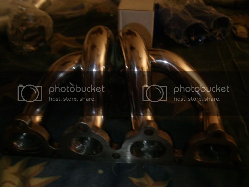

Mani
Reverse Side

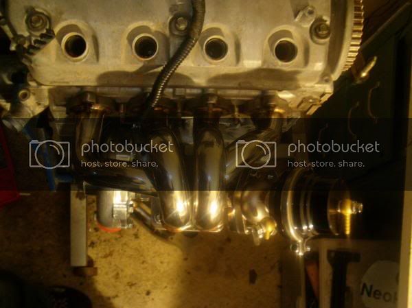

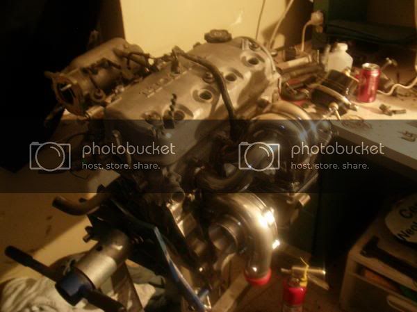

3 Bolt adds power? The head is on the block connected to the turbo manifold and turbo and wastegate. Bought a actual Honda Swap book for reference material and the welder is finally put together. I am still begging my ex to leave me alone so I can spend some sweet tender loving time with my engine. :(

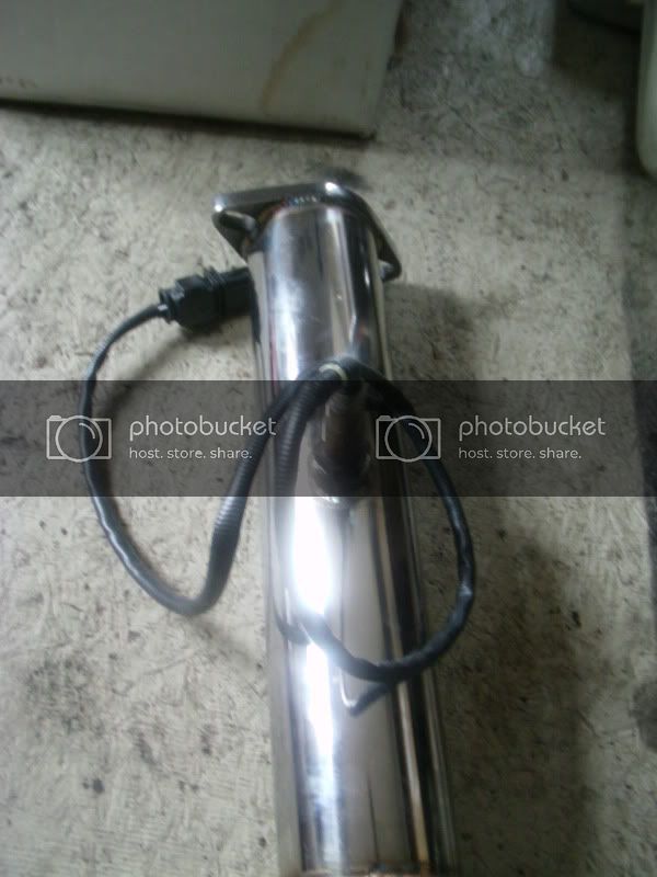

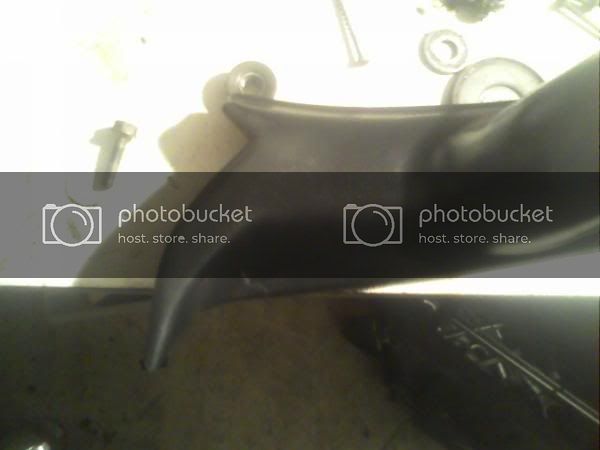

I'm not for sure if the downpipe will clear the oil pan so I will do some test fitting tonight. Got the boost gauge in the mail today and all I am waiting on is the oil pressure. The triple pillar did not fit so I may be plastic welding it to the stock panel.

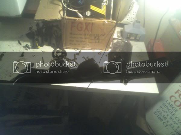

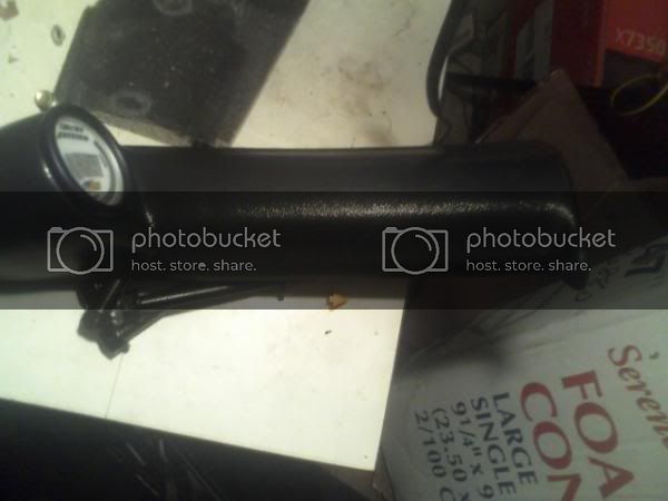

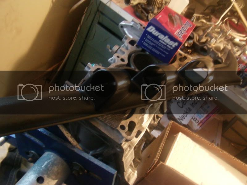

There is a pic of the pillar on top of the y8 block in there somewhere but I will get a better one with the gauges pressed in it. The fitment on it was horrible and the downpipe turned out to be about 2inches short before one of the bends. I guess I will need to learn how to use that fancy welder I bought.:D
cuz i know when i got mine for my rex when i got rid of the rex i tried putting it in the hatch and it was like 4-5 inches to tall so i cut the top off and it fit nice..
just get me a pic of where it goes down by the dash
Can do! That is what I was thinking but I wasn't for sure how much to trim off.

Hooked up the sending unit to the sandwich perfectly and will be ordering studs and pistons and rods next on the list. Got stuck taking someone out for a small vacation so it will set me back a few weeks. I need a break anyways tho.
yep its for a ef hatch..i used mine..the bottom piece fits real tight in both the hatch and crx..its the same..but the top needs to be trimmed to fit the rex..the roof sits a little lower..
use some tin snips or something and cut it at the top
