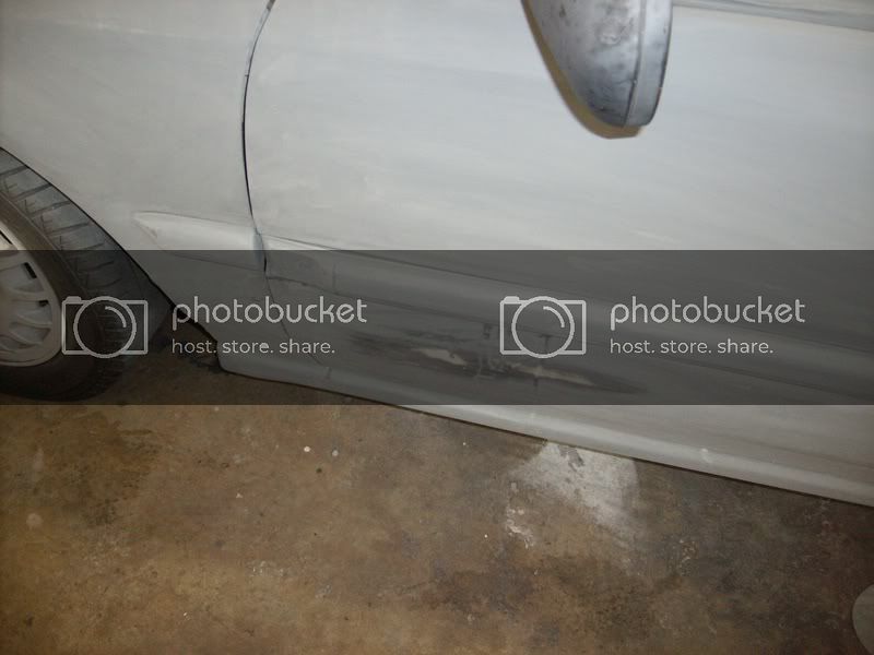

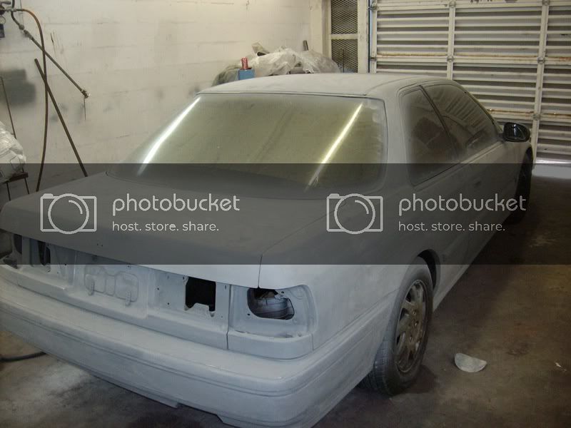

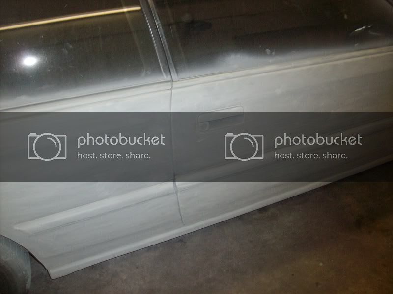

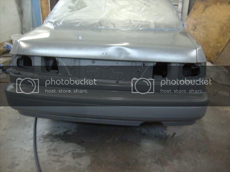

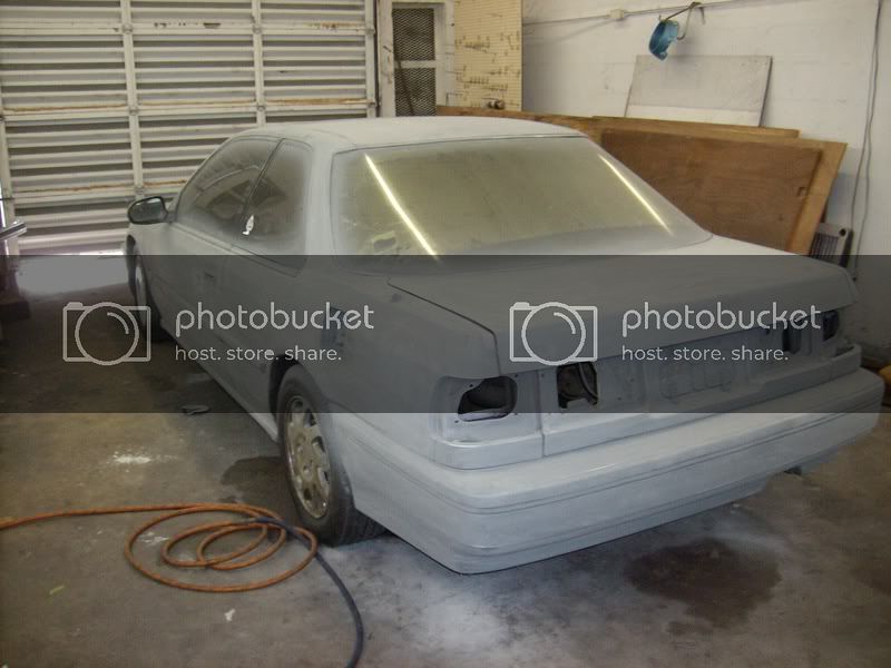

So today I laid the primer down. By the end of this week there should be paint and clear coat on it. xD
PICS ARE HERE! Scroll down

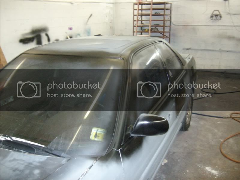

Yes, I'm fully aware that I didnt tape up the windows which obviously leads to paint on glass.

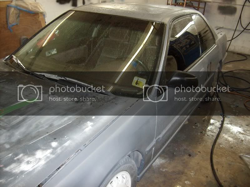

Only two places where I had to sand out runs, and only because after I washed it, I forgot to air blow all the water out, so when I started to spray, water came out. :huh:
OH NOES! Gray gas cap.

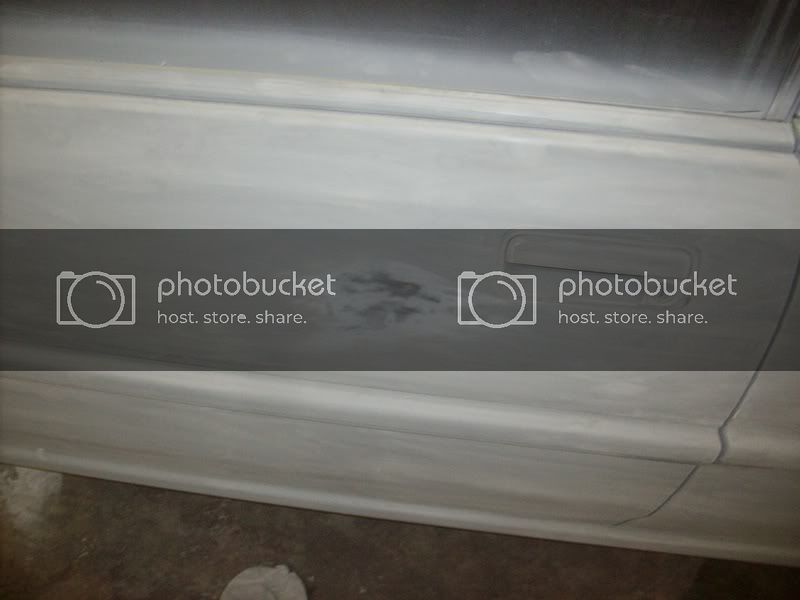

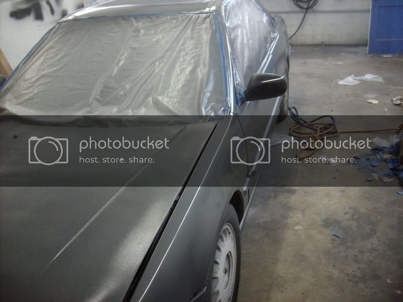

More Pics. If you've noticed, I've yet to lay any paint on the hood. That's because I'm going to replace it and paint the new one black, or something. Its got 2 dents and its really weak, going down the road is flops, and I hate it. So replace it and be done with it.
And now for the pics.
I get to start wet sanding it tomorrow and spraying the second coat.
what are you using to spray??cans or actual paint in a gun??
it looks to be tiger striped,and why the 13 on the side?

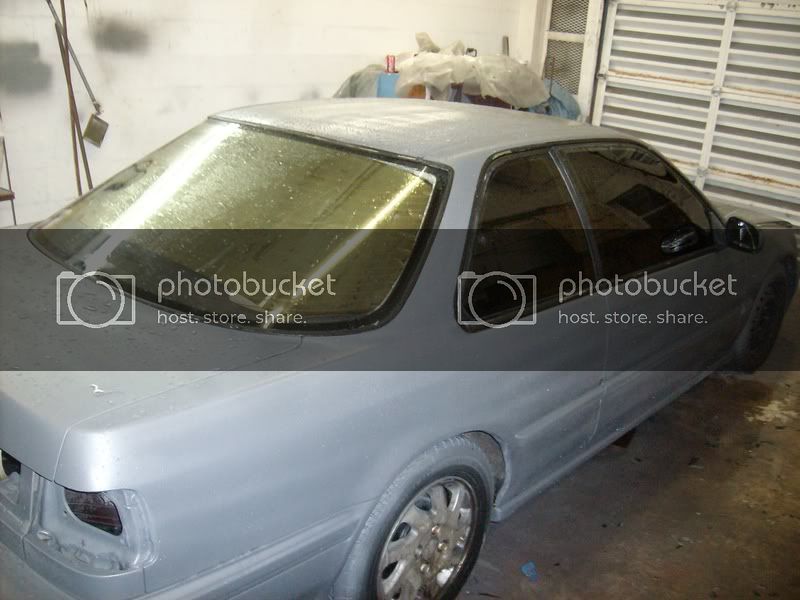

good answer, but im not mexican.... nor in the mafia. its my race number. Sounds gay to put it on the car, but yeah. The story behind the number is the first time I've ever went to race on a local drag track, they handed me that number out of all of them. That night I ran a great the entire night. So I kept it, that number wont be so blunt and obvious when Im done. Its tiger stripped because I mixed the paint wrong and it over sprayed. I'm using laquor paint, or however you spell it, today I wet sanded the car down, sprayed another coat, except this time I thinned it more so it wouldnt be so thick, then waited for a while, and sprayed the clear coat.
Monday I'm going to sand it lightly and put the last clear coat then be done with the car.
Remember, this is my first time ever picking up a gun and going about on my own paint job, so its going to be kind of rough being I'm just learning. But upon this experiance. I like it, and I think I want to try to make a career out of it. Not sure yet.

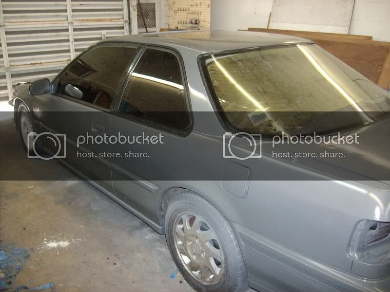

more pics

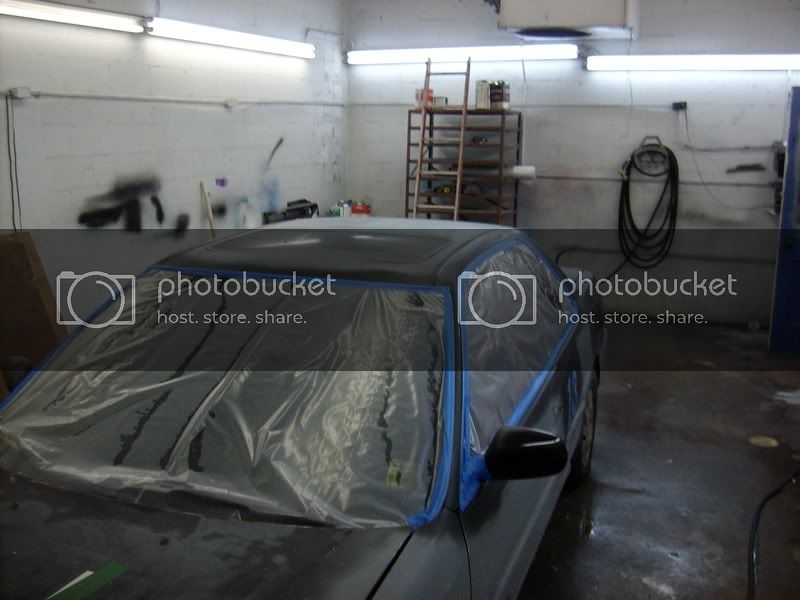

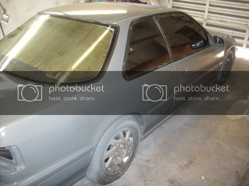

So, I got the second coat of clear on. but I'm not too happy with it being I neglected to use a paint cone strainer, and some trash got mixed into it, and sprayed on the roof, and some odd amount of places, so im going to let it sit and dry, sand it once more, then the last two coats will be strained well, and be the final and last of doing this car.
Here' some pic updates.
a local painter stopped by and looked at it, and said that I didnt do that bad considering the type of paint im using isnt easy to use at all. He also said I have a good amount of potential with this, and I got the basics down. So that makes me feel ALOT better about this.

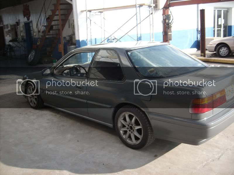

Last Paint Update

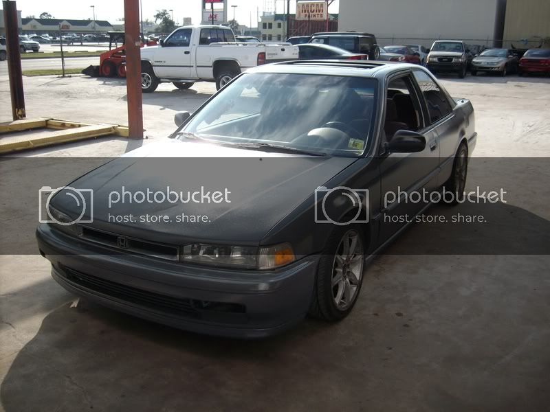

So I'm finished with the paint, got all the tape off, tail lights back in, corner lights, etc. Rim's are back on and these are the end results of the paint. the only thing im going to do body wise, is replace the hood, mirrors, and tail lights, and I'll be just happy with the body.
looks great, i like this....
