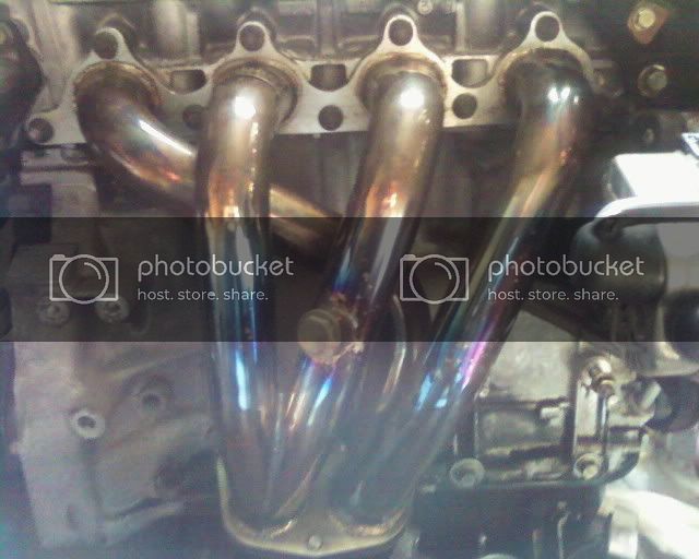

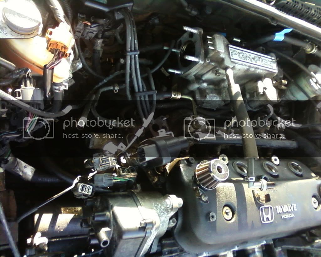

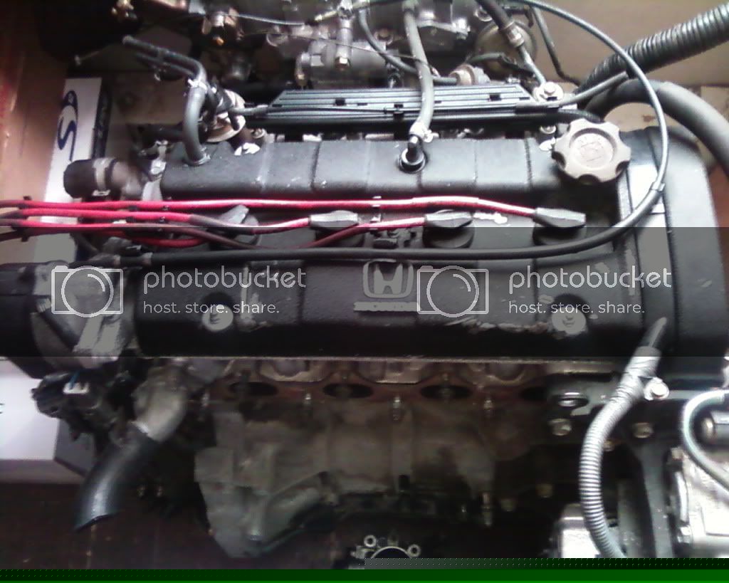

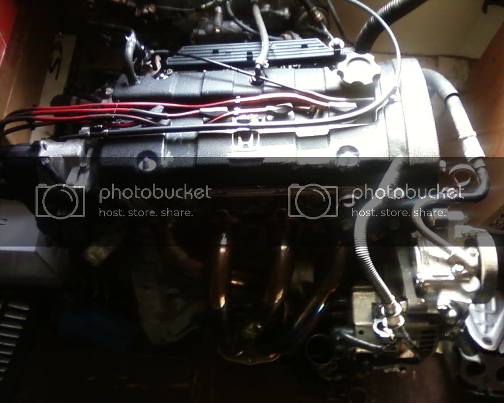

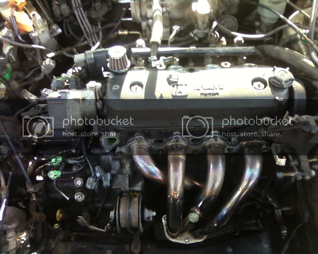

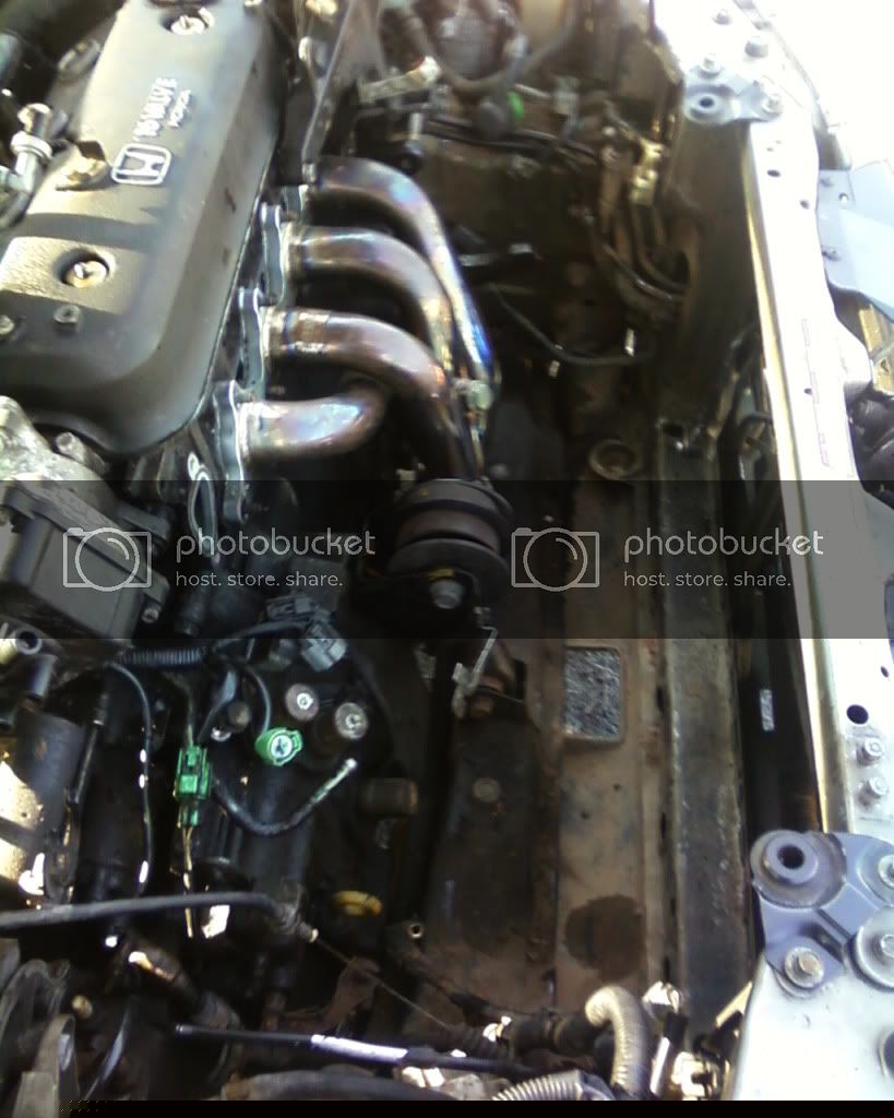

i think i need to hurry and finish my car and get it back on the road very soon this car has been a project pain in the a**.
these are the only pics i have at the moment but i well have more when i can get farther and get the axel bolts off and get the motor out of the car.
