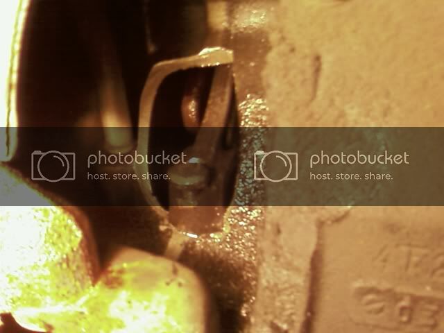

And to the OP, the auto intake mani will be just fine, the only difference between an auto an manual that I can think of is the extra cable wheel on the TB for the tranny kick down. I have some pics of what happens with ACL bearings if you would like to see them.
You sir would be correct.
cool... so all i need is a TB(manual). yes, id like to see those pics. thanks for the info
You can use the auto intake mani and TB without any problems.
And this is what happens when you have the crank ground and use oversized ACL race bearings.
That was my LS, so for my B16 Ill be going all OEM Honda.
lessons learned the expensive way... ill take the easy way and listen. what about gaskets??? i believe OEM gaskets are garbage, i could be wrong. whats a noteable brand(s)? thanks yall
thanks for the pictures, man!. I won't make that mistake in my build now. As for "wes lee's" question about OEM gaskets and seals. They appear to run 200+ k on these engines from the factory so OEM is always a good bet!.
