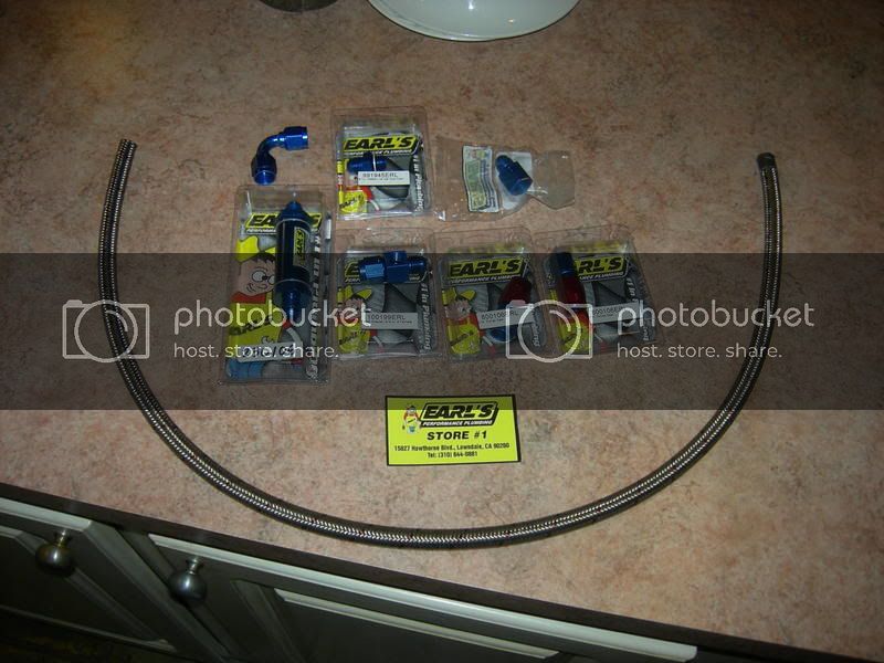

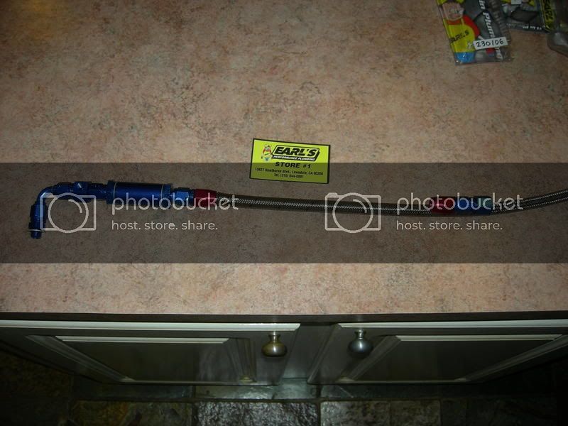

Got my Fuel line stuff in from Earl's store
-Andrew
Well, if your looking to do it, scan over This thread's pages.
Some guy posted some pretty nice setups that will work a little better.
My current setup will only leave enough room for about 3" of SS hose, because the filter and stuff is inline. (And hopefully I won't have any problems with my intake pipe clearance)

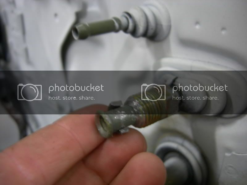

If your fitting looks like this...

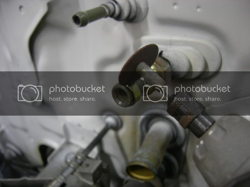

You'll have to cut off the non-threaded part of the fitting.

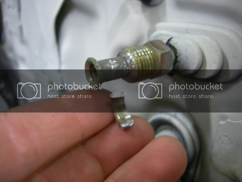

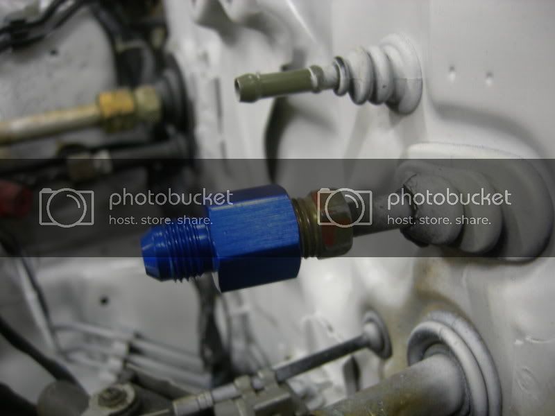

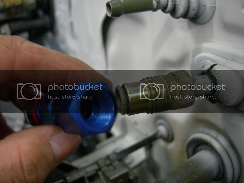

4. End result:
And your good to go!

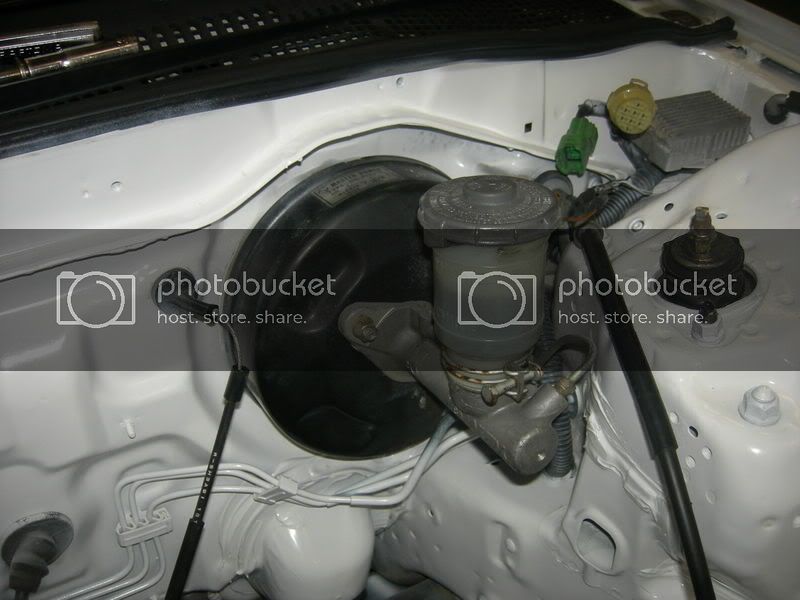

I've started on the brake booster and master cylinder thing. (DC teg)

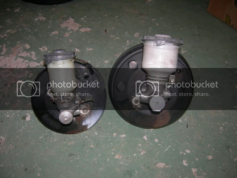

I've got the Booster completely bolted in, cotter pin and all, as well as the MC, but I need to go back to the junkyard and pick up that one fitting I'm missing(seen in last pic).
Isn't that stupid? I went to the junkyard a couple days ago, got 3 fittings, and neither of them is the right one!

i assume thats a 1" master cylinder? fuckin siiick. cuz i got the same one for my integra... just havent installed it yet.
Well, I'm not too sure what it is.. haha. It's off an 94+ LS w/ ABS. I'm starting to look around for a GSR MC. Those are 1".(same as ITR, but I think buying an ITR one will be a bit more pricy...)
But even still, it's better than mine.
