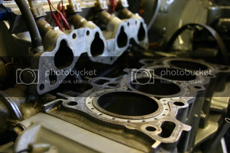

idk. What would happen?
Thats what I wanna know. and it's just on cyl. 4 and partially 3.
gah. I wish I knew! time to post up on H-T. lots of crackas there that know stuffs.

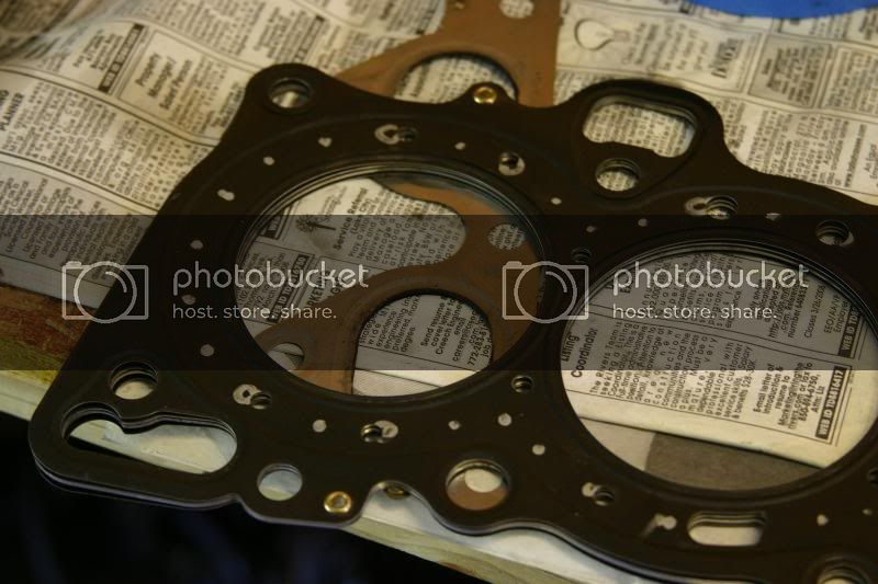

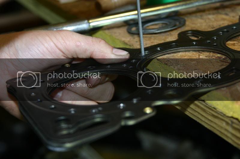

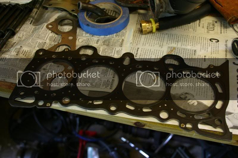

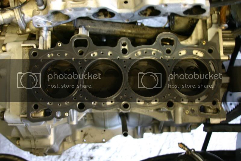

Drilled out the passages for the Headgasket: ( I called Cometic and they said it was cool)
Torqued the head

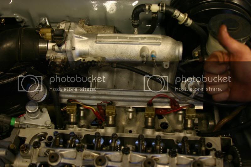

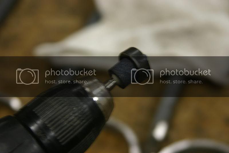

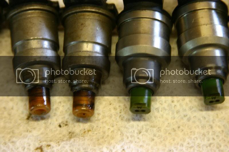

Injectors and bushings modded and installed:

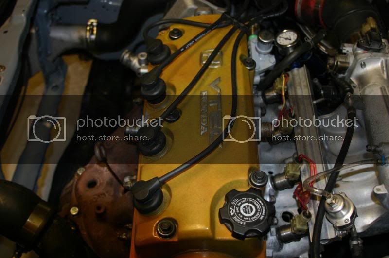

Installed Valve cover and pulled spark plugs(b/c 1. I bought new ones (BKR7ES-11) and 2. cause we're going to do a compression test first off)

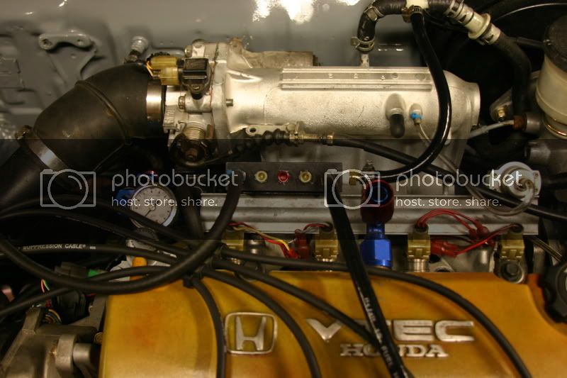

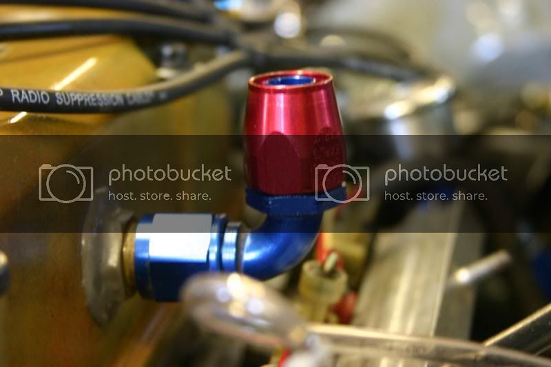

I know you guys like my -10AN fittings for the breather box ;)
haha I'm an idiot, though. I should have 'started' on the back one, because since I did it last, it looks be best! lol... oh well. These valve covers are a dime a dozen.

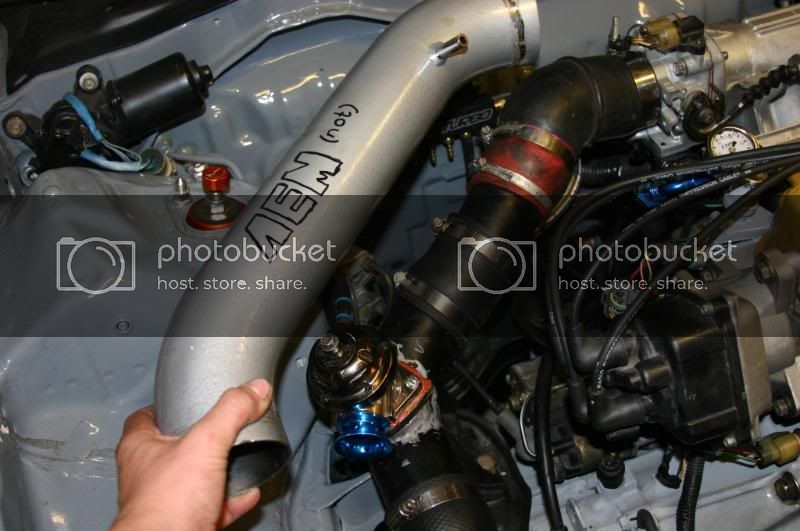

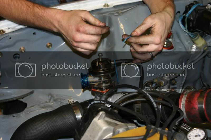

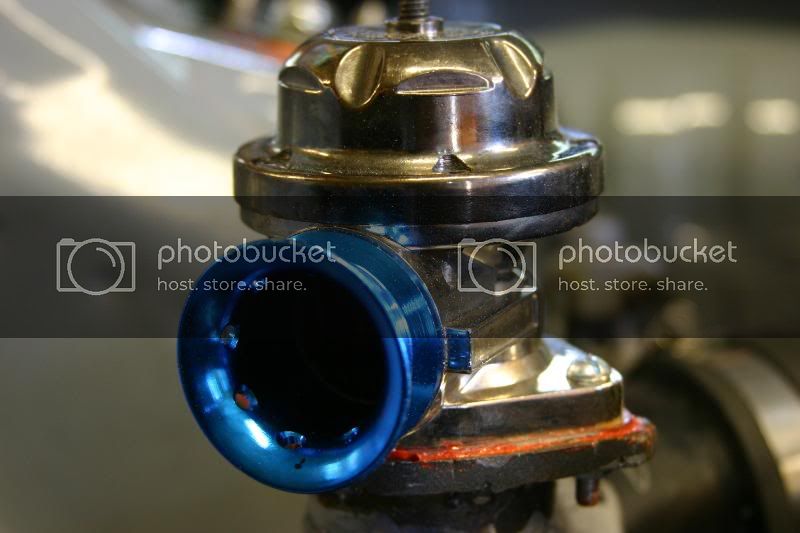

Terrance mounting the BOV
I'm going to convert to this pipe asap. it happens to be a perfect fit! I just need to get another (cleaner) BOV flange.

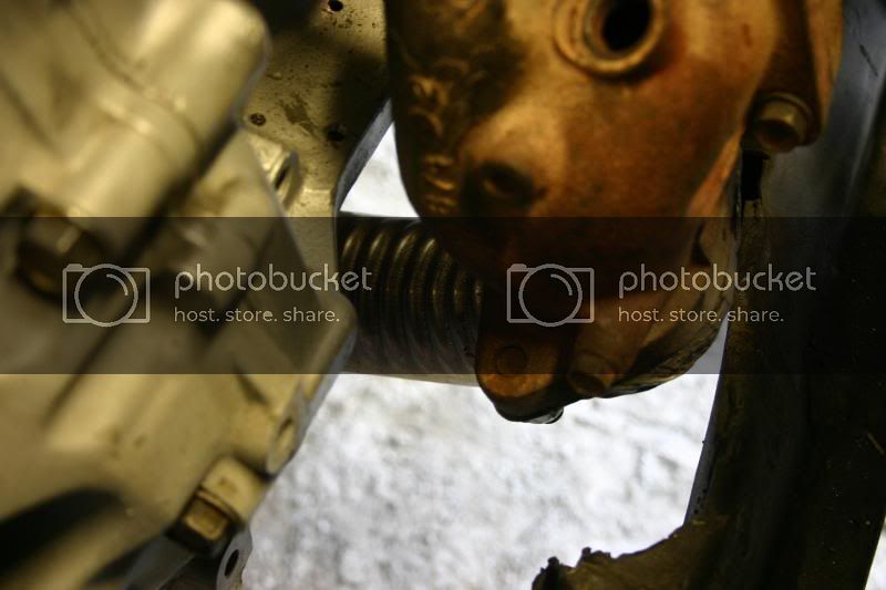

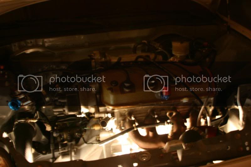

Oil Pan is on. I'm almost finished with the drain line; it'll be done today!

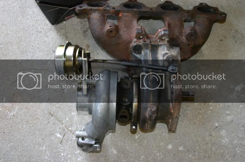

Terrance got busy working on a "new" setup for my Hot side. :thumbsup:

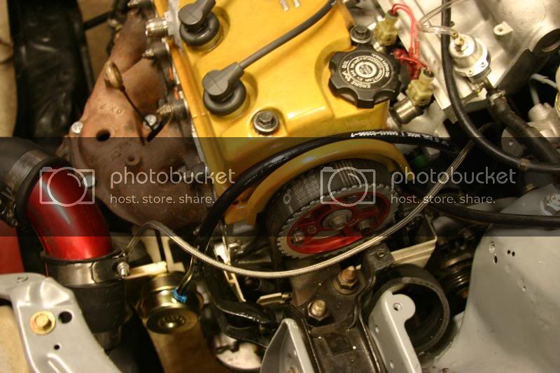

Oil lines and Wastegate hose. I sure wish I could have run the WG line closer, but the turbo doesn't have any nipples or anything for it :(
Will this be a problem? it's about 3ft.

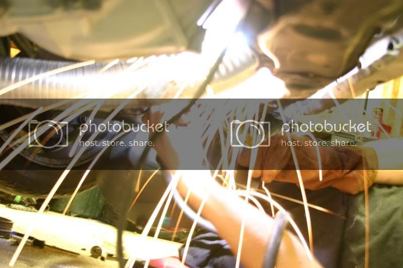

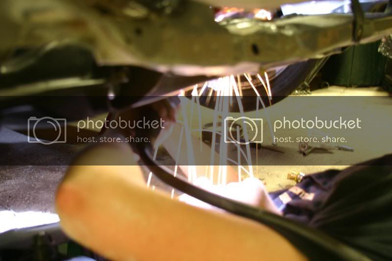

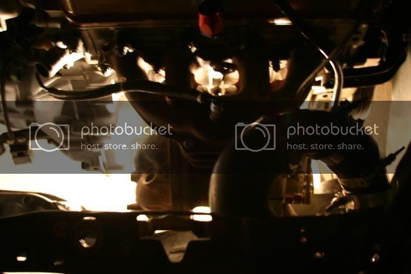

Then I tacked my DP in place so I could bring it down and weld it good.
ow:
OWW:
No pain: :rolleyes:

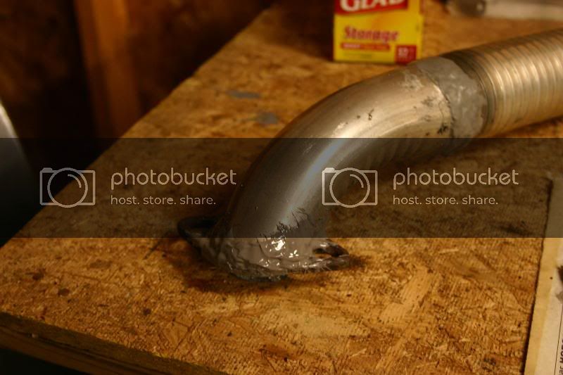

All welded and finally gooped up with JB to seal the small holes here and there.

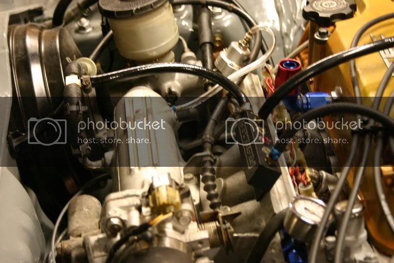

Catch can/breather box
Just don't want any pressure build up in the engine crankcase from blowby - thats when seals blow.

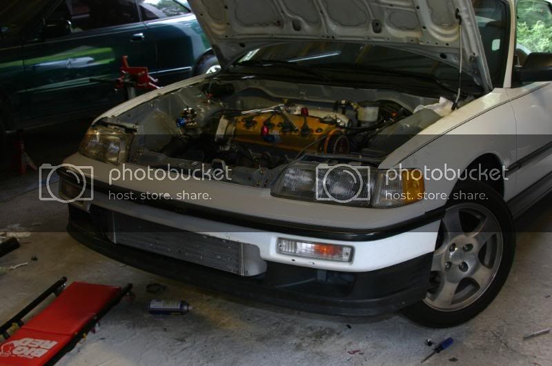

Got the bumper mounted-

See what I mean about doing the "visible" side last? this JB is so much cleaner.

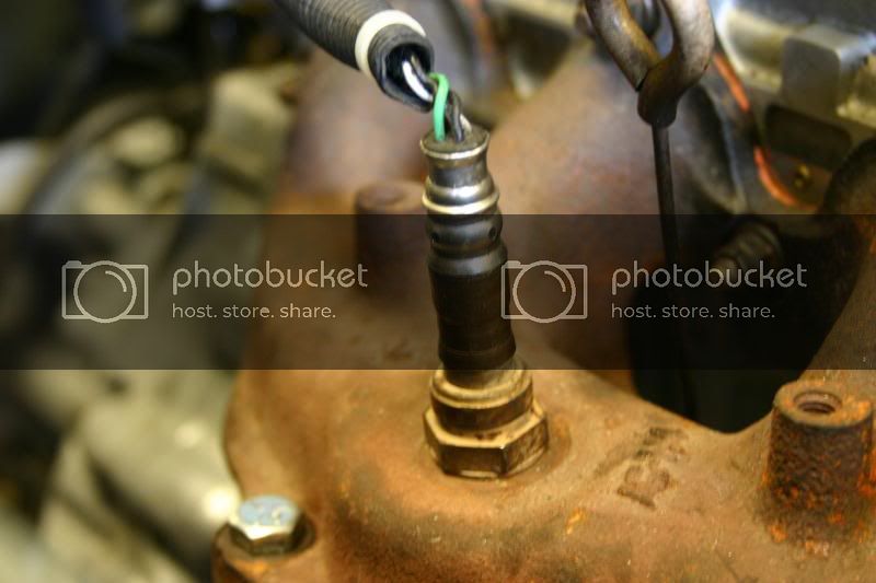

o2 sensor. Anyone think this needs to be post-turbo for any reason? theres one right next to it on my Downpipe, so its a piece of cake to change.

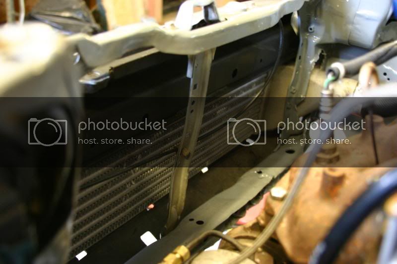

^ X your fingers for tommorrow! My radiator gets in tommorrow, but I might just have to jump the gun and do it first thing in the morning before class (I go it from 12-3 this quarter! last class ftw)
I'm all finished up except for the radiator and tuning!
I welded the oil pan really well and then JBWelded it to seal it all up. Shouldn't have any problems :thumbsup:

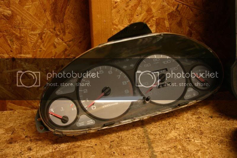

Terrance gave me a GSR cluster:
Where is this light coming from?
