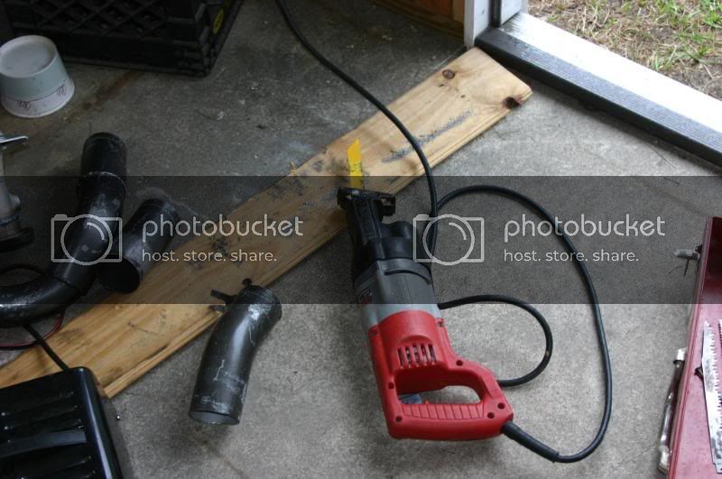

Might need to cut this out with the dremel:

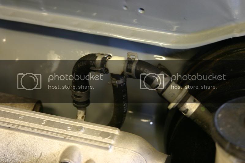

Picked up some more stuffs for my oil drain:
(the AN fittings were cheap so I bought some extra)

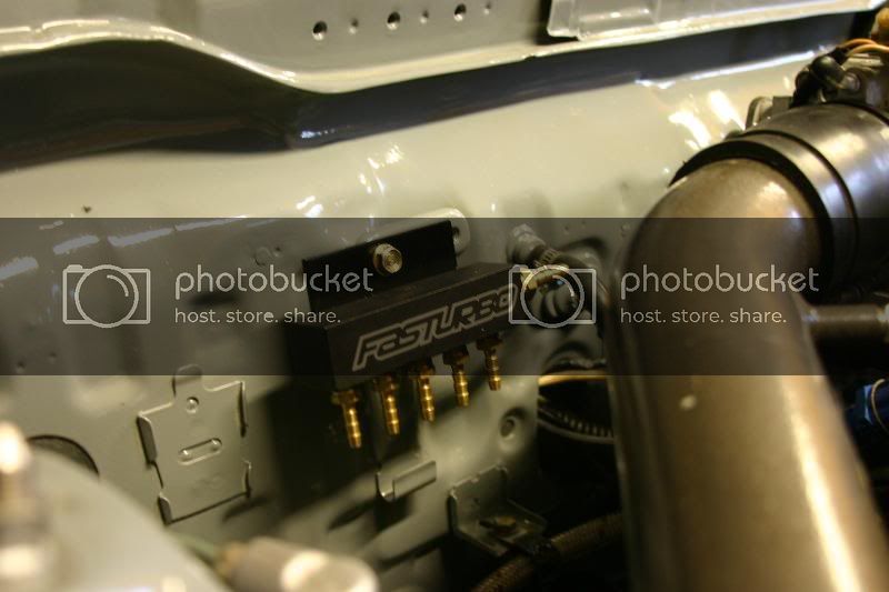

Added my vacuum manifold:

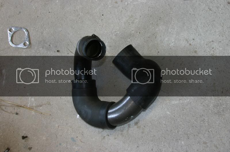

Got the crazy bends figured out thanks to my box of couplers, sawzall, and other random crap.

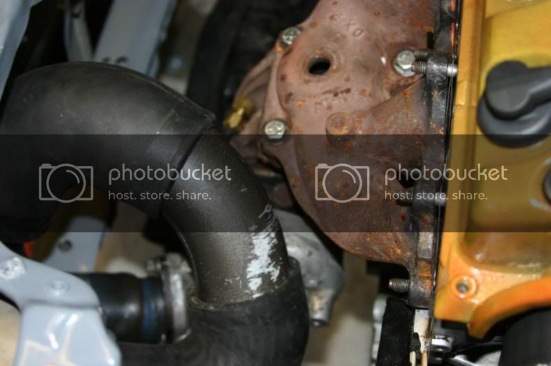

Heres how close the piping is to the manifold. I'll probably heat wrap it.
