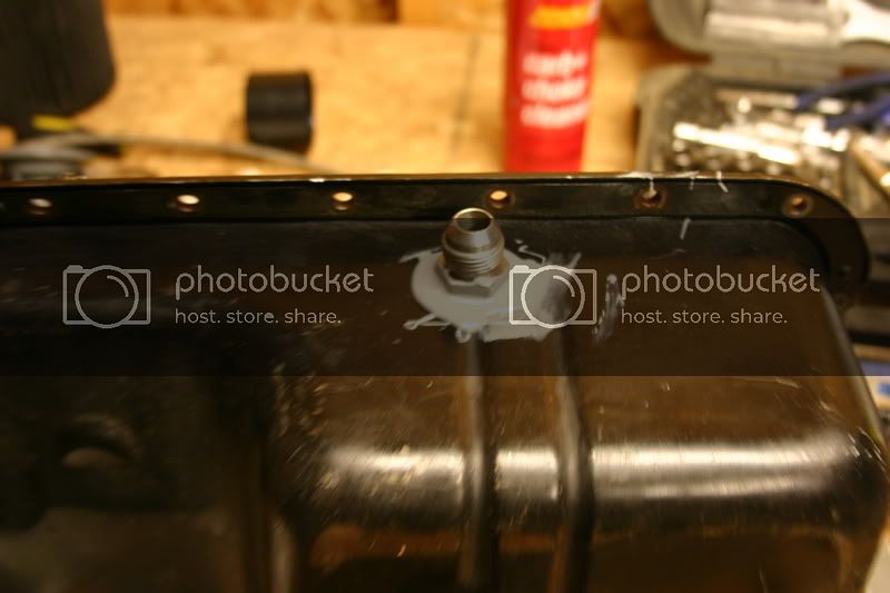

I'm welding some -10 bungs today. 2 on the valve cover for crankcase pressure and 1 on the oil pan for the drain line.

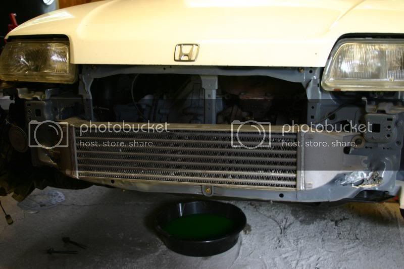

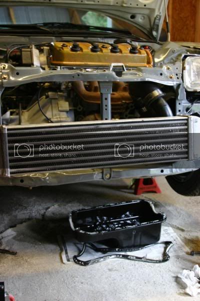

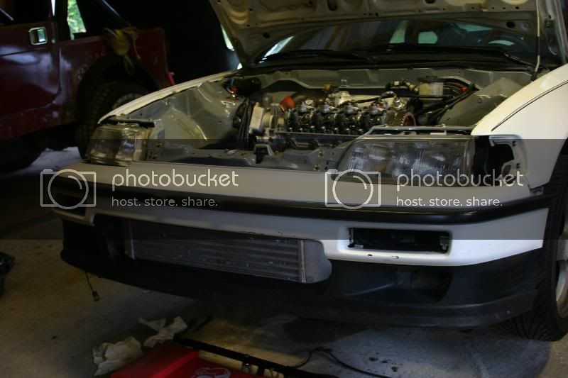

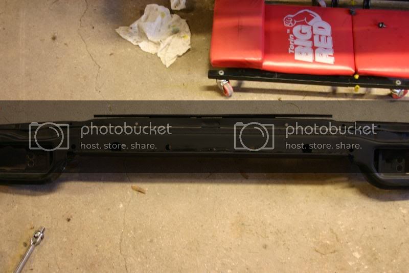

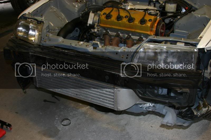

I mounted the Intercooler yesterday, but today I held up the Bumper support and mentally noted what needed to be done to make it right.

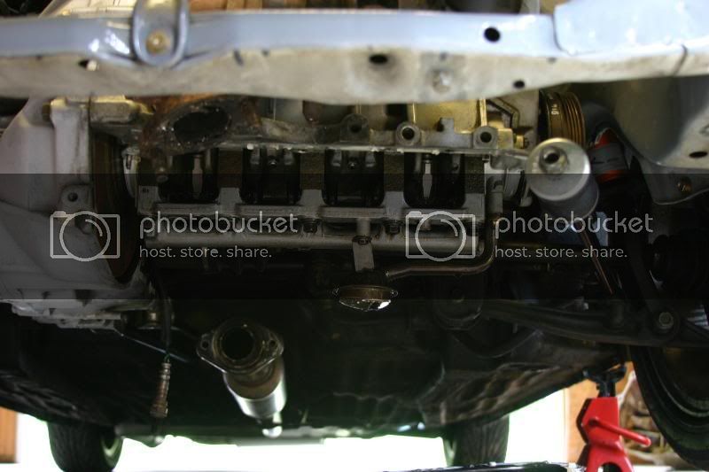

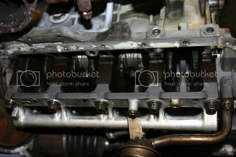

Next I dropped my oil pan and was thoroughly shocked by how clean it was under there. WOW. Just look! (I didn't clean at ALL before taking this pic.)
... I know right??? 8k miles = like new.

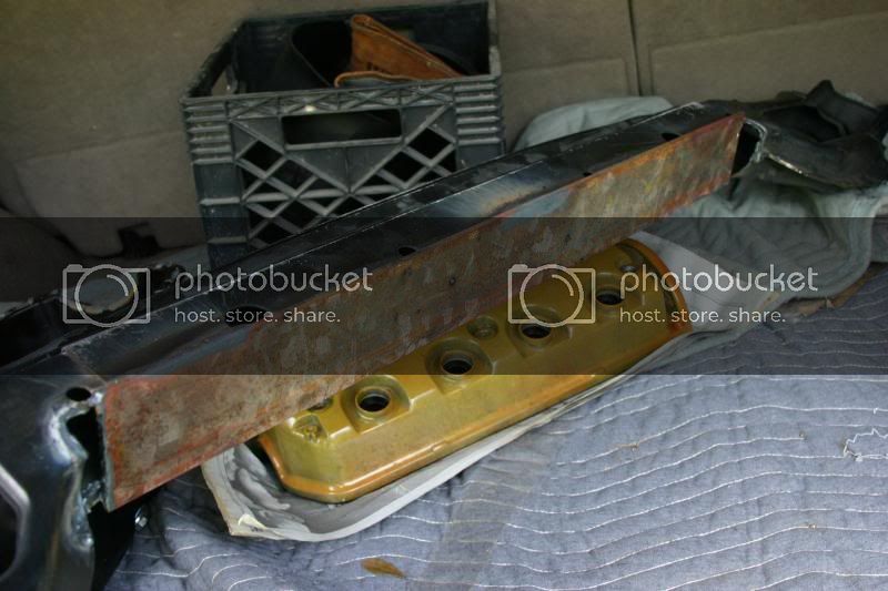

Anyway. Then I pulled the Valve Cover to put the vent fittings on.

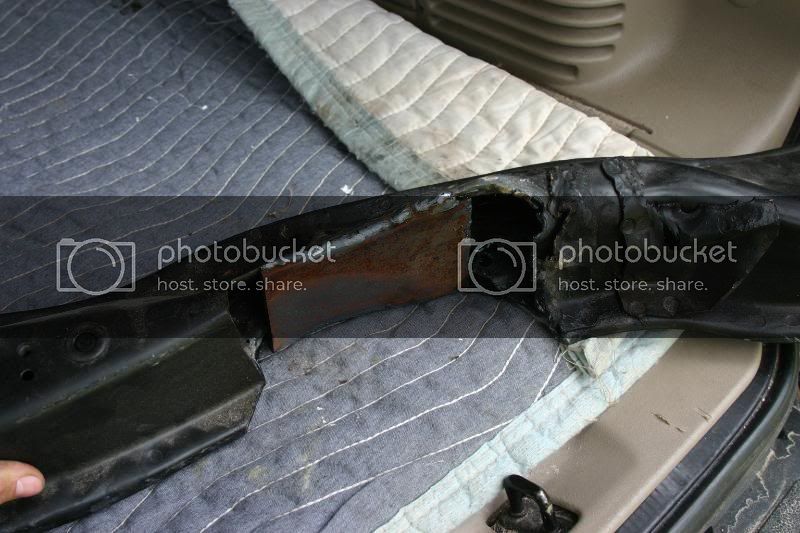

Torched and welded a steel plate on the crossmember to clear the DP:
Torched and welded the bumper support. Raised it about 3/4" to give the FMIC some room to breathe.
After some paint:
Test fit:

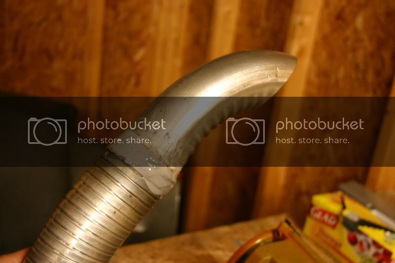

Custom $8 downpipe from Advanced Auto! woot

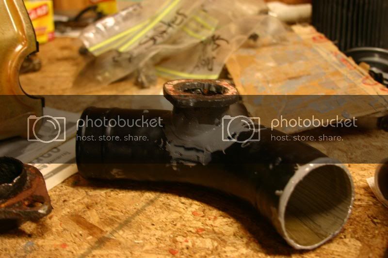

After some modification and welding (yes I actually welded it and then put JB weld on it to seal it(cause I was just using my crappy flux cored wire b/c I'm out of Argon))

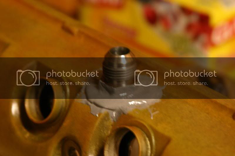

Then I JBWelded my fittings on:
And a couple for fun
^ Yeah I'll be cleaning it up a little. I'm just going to pull off the small strands here and there. I'm not going to grind the thicker stuff down.

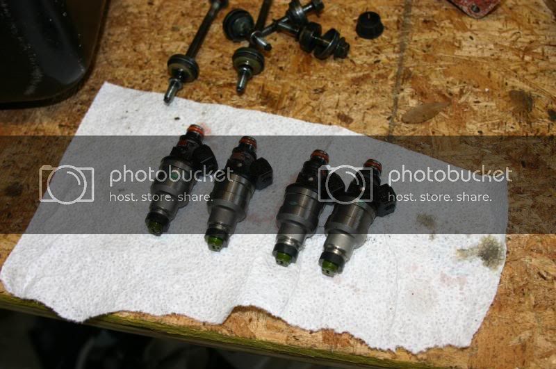

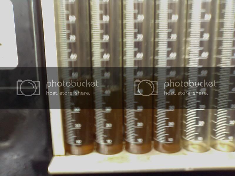

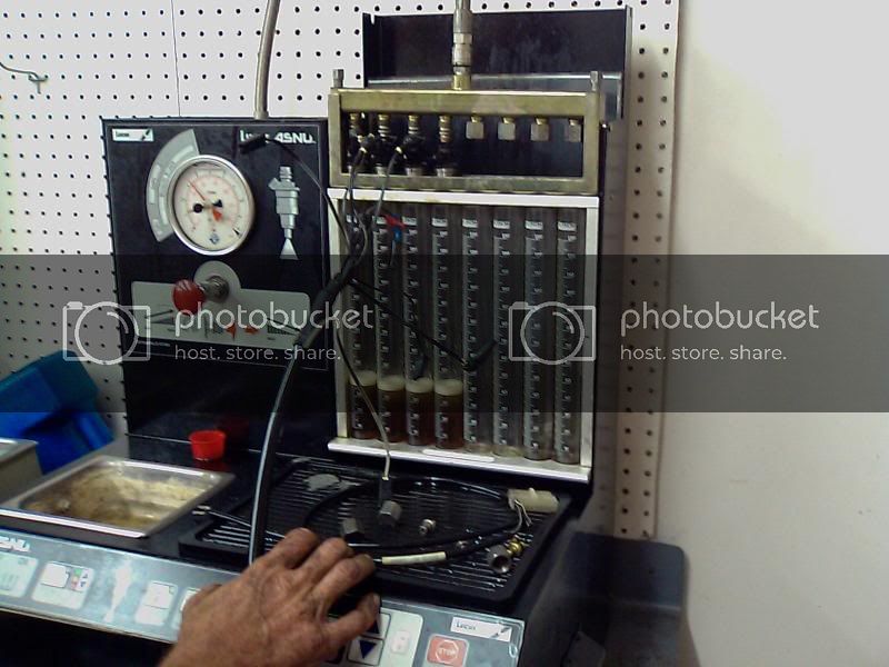

I got my BlackTops calibrated and they are doing good- Dude was pretty cool and I only had to pay $20 instead of the normal $10/ea. price! woot.
Cell phone pic sry:
one was "weak"
So we shot some air through it and it blew whatever it was that was blocking it out! right on the money!

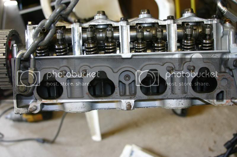

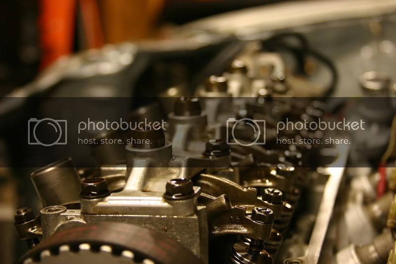

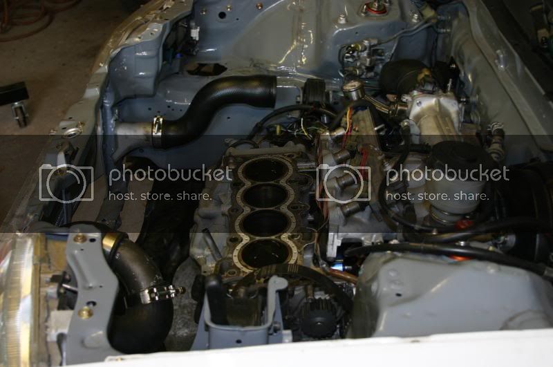

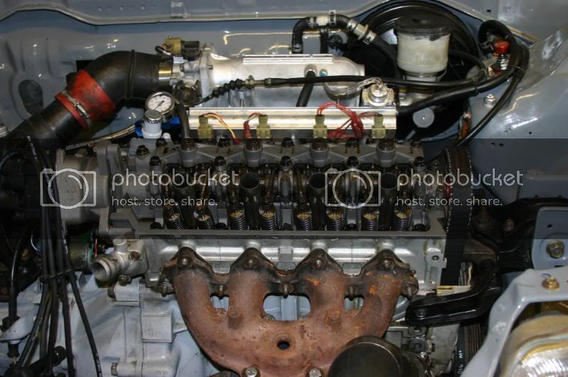

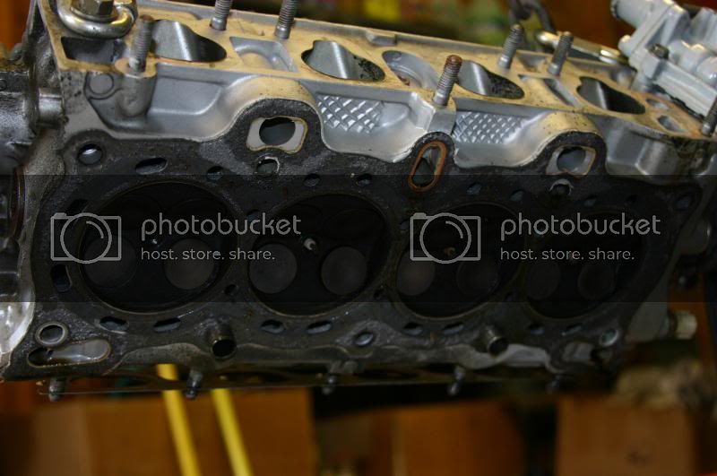

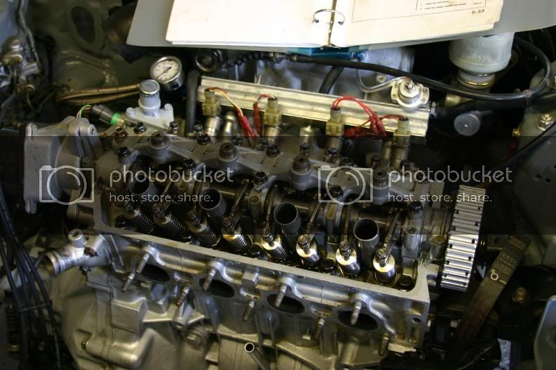

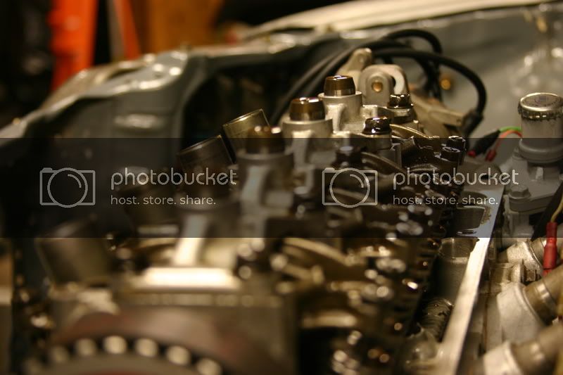

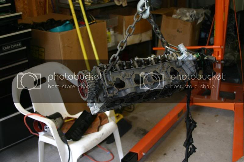

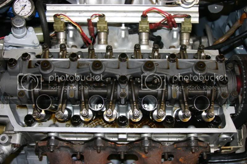

Pulled my head off
Heres the porting job KMS did (not bad!)

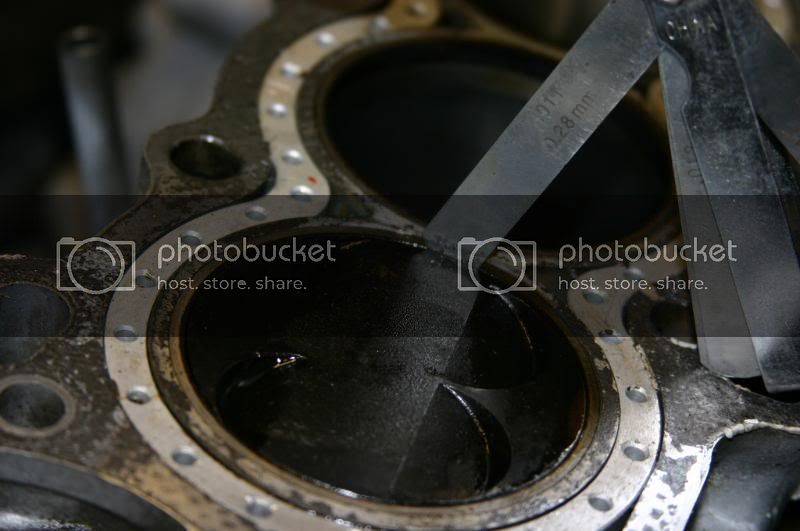

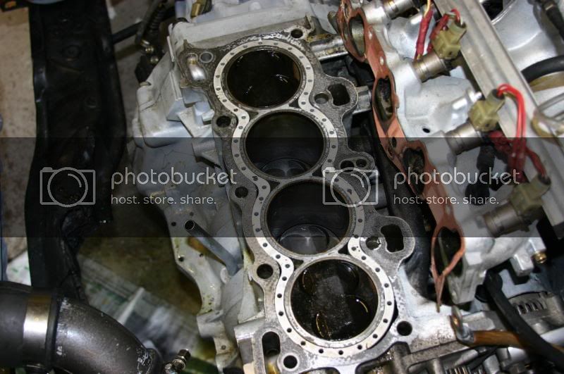

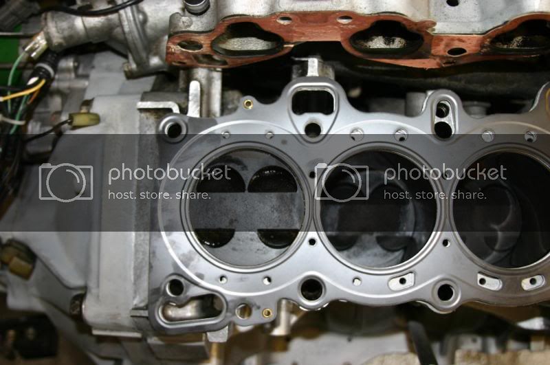

Talk about piston to wall clearance! .011" :o

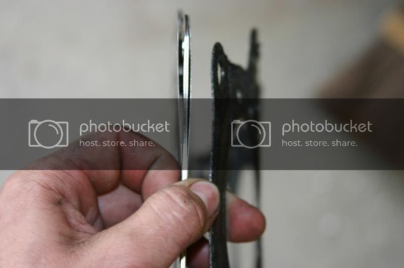

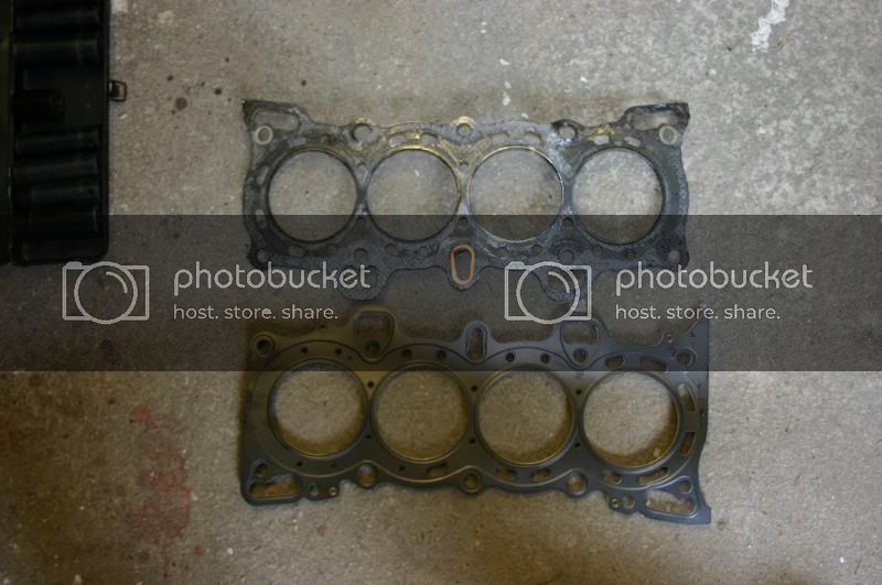

New headgasket: (a little bigger :))
It doesn't really line up with the coolant holes on the block gaurd on 3 &4. Coolant can still pass through, but it's not a perfect opening. I used it anyway, but does anyone think this will present a problem?

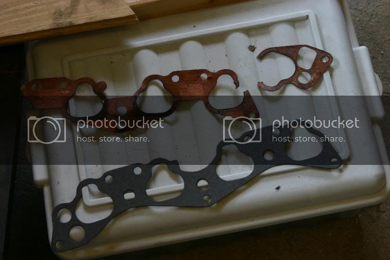

IM gasket(want to get a Hondata type)
DONE 1.5hrs. But I need my Torque Wrench from my buddy to get the 2nd stage of torquing in. (22 lbs is easy enough to use your 'calibrated arm' with. 49.... eh not so much)
-Andrew
I would think it could possibly leave air in the system or be a nice place for gunk to build up. But with you I wouldn't think it bad. I mean.. doesn't your car only drive on the street a total of 5 times a year :D.

Also, look at yoru spark plugs?
The one looks white, the others are normal color. Is that because of the flash (hope so). If not, you've got a lil prob w/that cylinder.
No they're fine. It's just the flash. They are all Tan :thumbsup:
