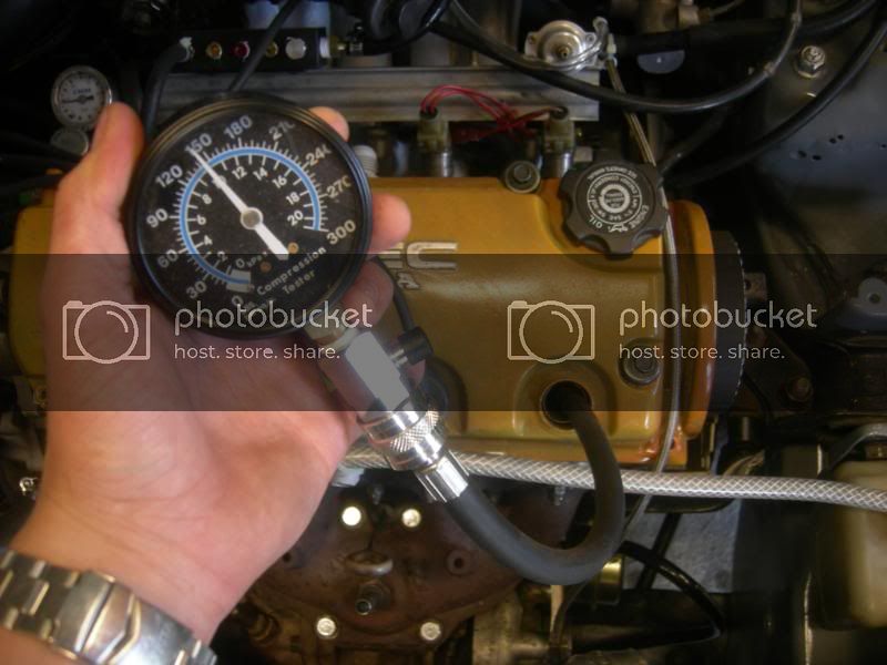

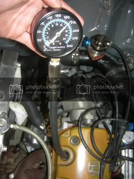

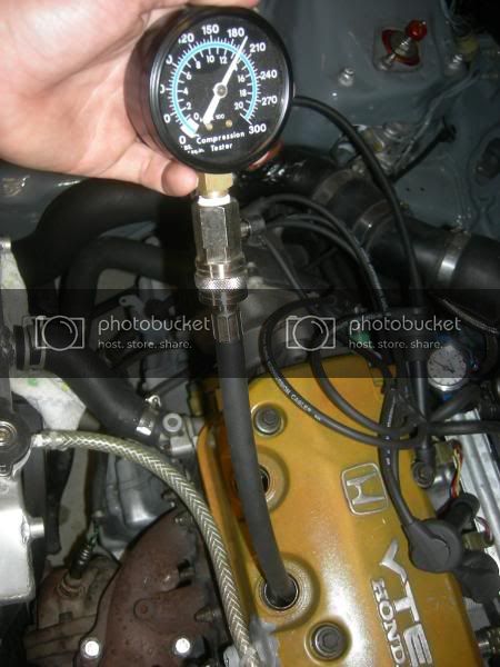

Compression results in from today :( All are OK except for #1 for some reason.
Rich much?
#1 = Fail. :(
It's GOTTA be the headgasket.
I'm going to try and get my hands on a leak down checker tonight and do that sometime this week...

The test looked a bit unbalanced anyway. How long has it been running? Did you warm it up before the test?

Getting a leakdown checker tomorrow. I'm wondering now if it wasn't actually my headgasket afterall... I sure hope it is/was something simple... but - it never is..
I dunno. With the way you drilled that HG out, it would make sense that 3 and 4 would lose compression, but not #1.
Do you have a pre-cometic HG compression test? Sounds like it could be a valve too....... Did you check the head and block with an engineer's ruler or anything?
Worst case it could be your block-guard causing the sleeve to sink. That'd suck.
