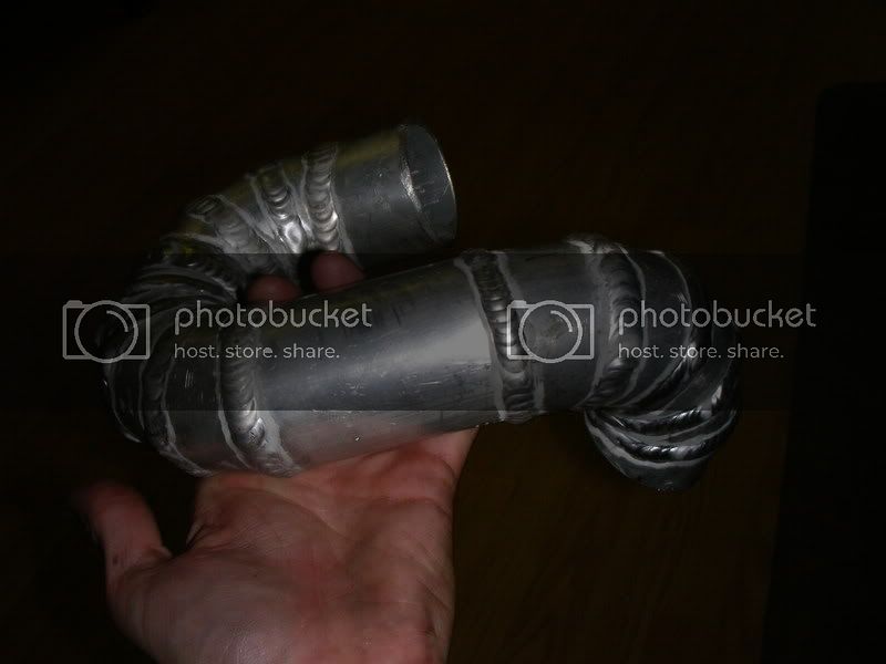

That thing looks intense. Turbulant too. I'd say it's exactly what you need pre-intercooler.
wOOt!!!!
BIG Thanks to Terrance @ ezell Industries! haha
Looks SICK!!!

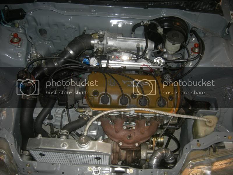

Update!
I'll let the pictures do all the work.

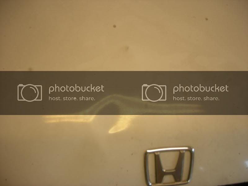

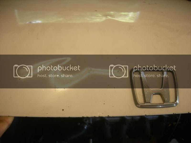

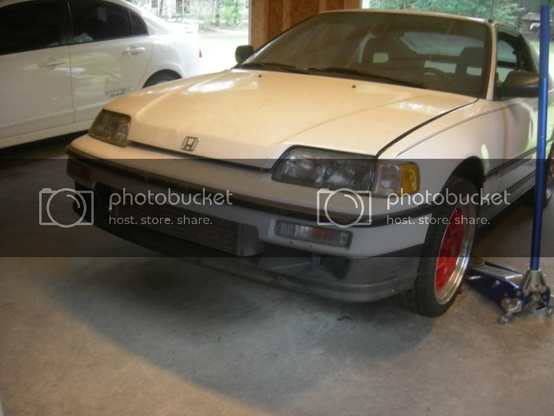

The pics of the dents in my hood is where I got a little over-zealous and beat the underside of it and it warped the top a little bit. Some of it came out, but it's still there. It's ok, though. I have that carbonfiber hood I've been thinking of repairing and using, or I can just do a little repair to this metal hood.. no biggy.

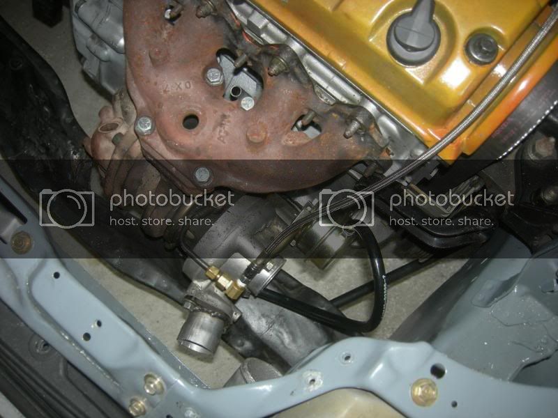

the only thing holding me back from starting it is oil.
I talked to my tuner and he said to just turn down the fuel pressure to like 15-20lbs and see if that helps it idle (with these big injectors). That way I can heat cycle it and check for leaks and such!
I'm sortof scheduled to get it tuned with him (if all goes well) next Saturday!

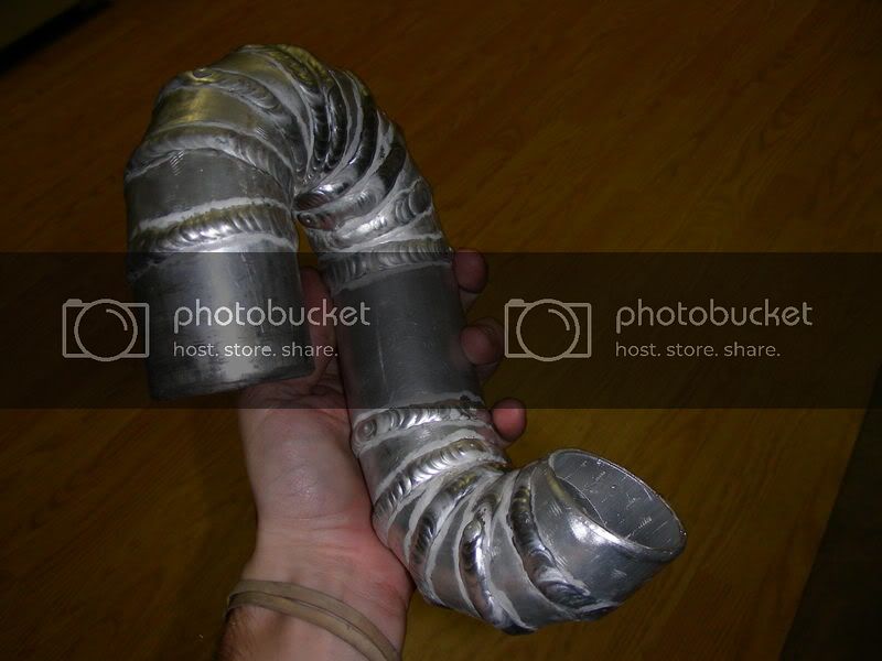

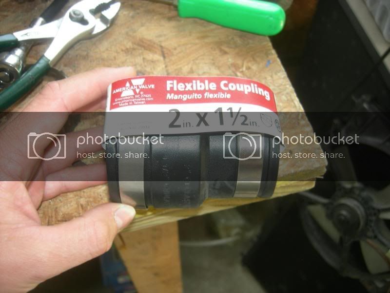

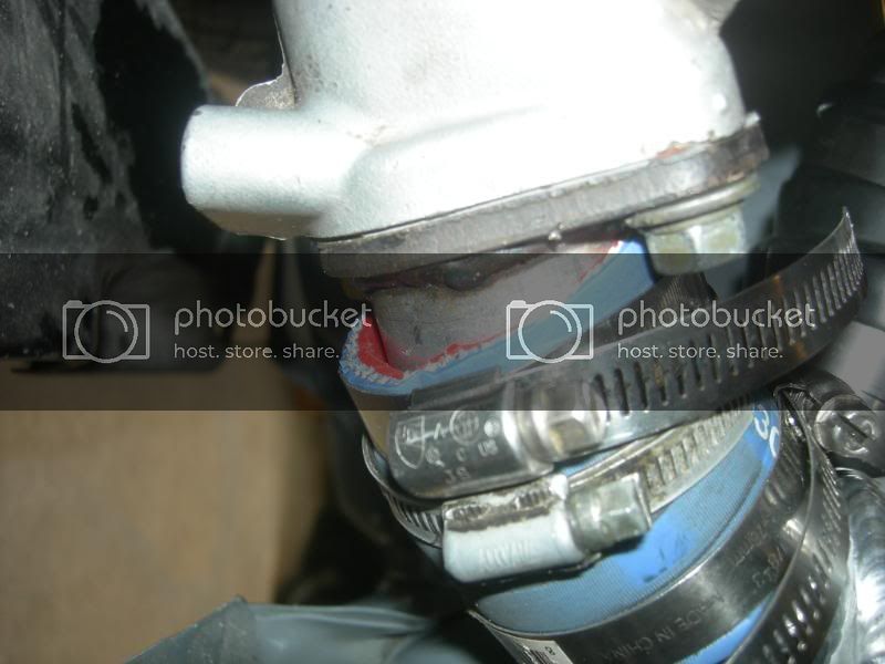

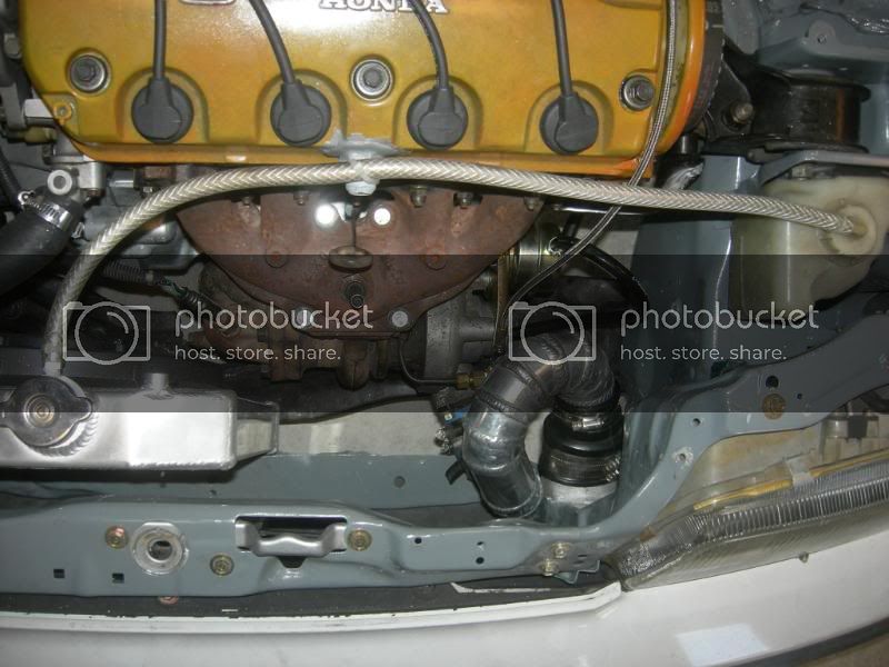

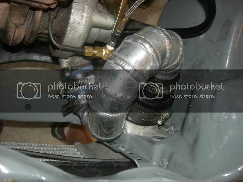

Dude.... what in the name of all afro-engineering is going on there....
quad band clamps......
Hey man, whatever it takes to get the job done! I've used MUSTARD several times in my mechanic career to figure out tolerances and whatnot :ph34r: Whatever it takes ;)

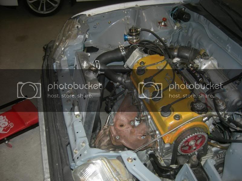

Andrew, thats sweet man! When are you gonna crank it? Man, I sure hope the headgasket is ok :o

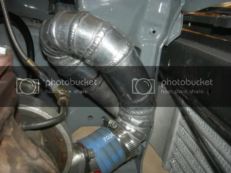

If guys run just 1 ok, I figure I'll run 2 to be "safe." None of my T-bolt's were small enough. :)

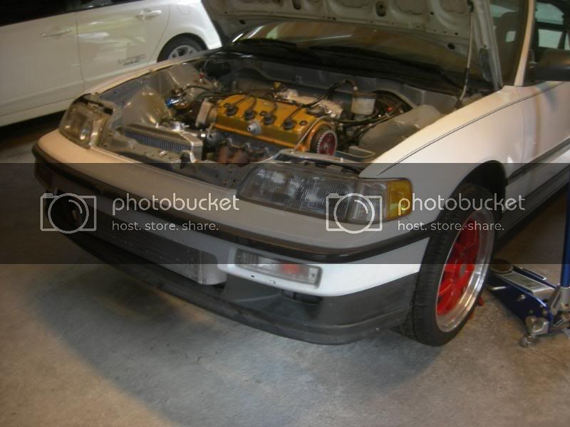

way ahead of you. ;) I took this last night but didn't upload until this morning. This is the "suprise" i had for ya. :D
I vote for the CF hood.

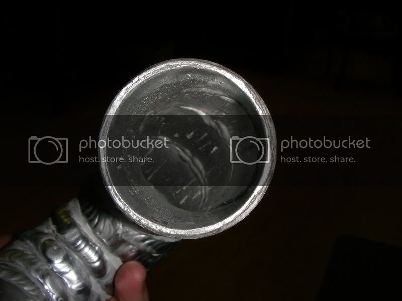

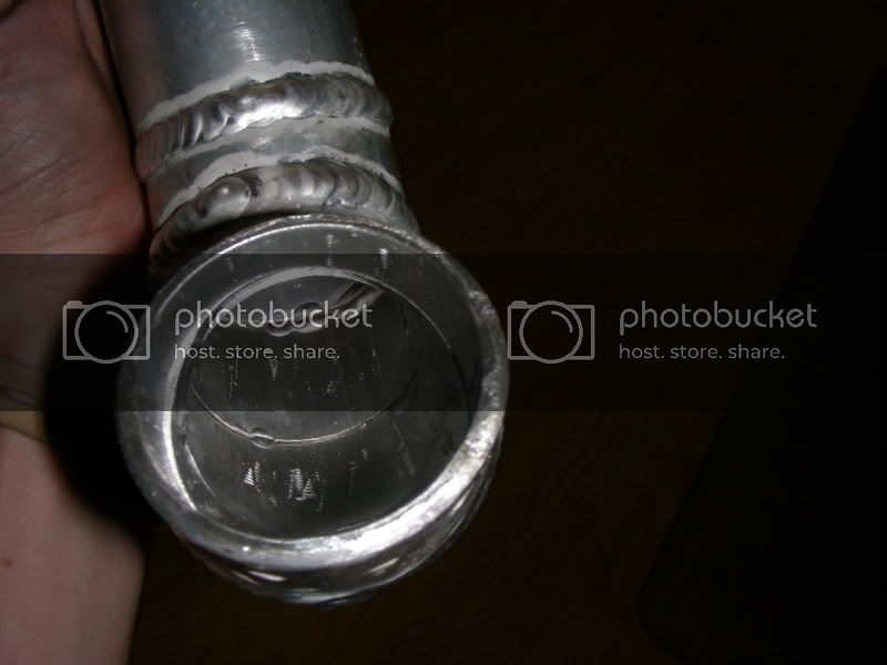

Also, make Terrance take that POS back and have them weld some beads onto the ends. Or else 10 band-clamps won't hold it on.
