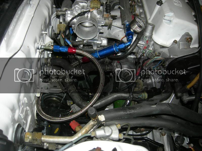

I'll snap some pictures when I get home, but long story short, I had to loop the line, because i couldn't do a 'straight shot' from the firewall. the two AN fittings were touching!
I made it work, so just hang tight.

Fuel line:
The picture makes it look like it's rubbing on the firewall, but it's actually about a 1/2" away from it, and it's not touching anything else, so I'm happy with how it came out!
