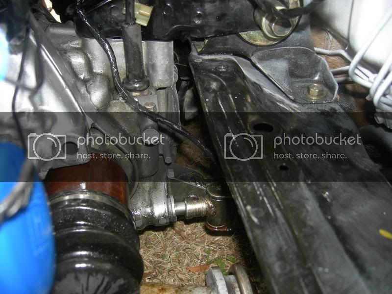

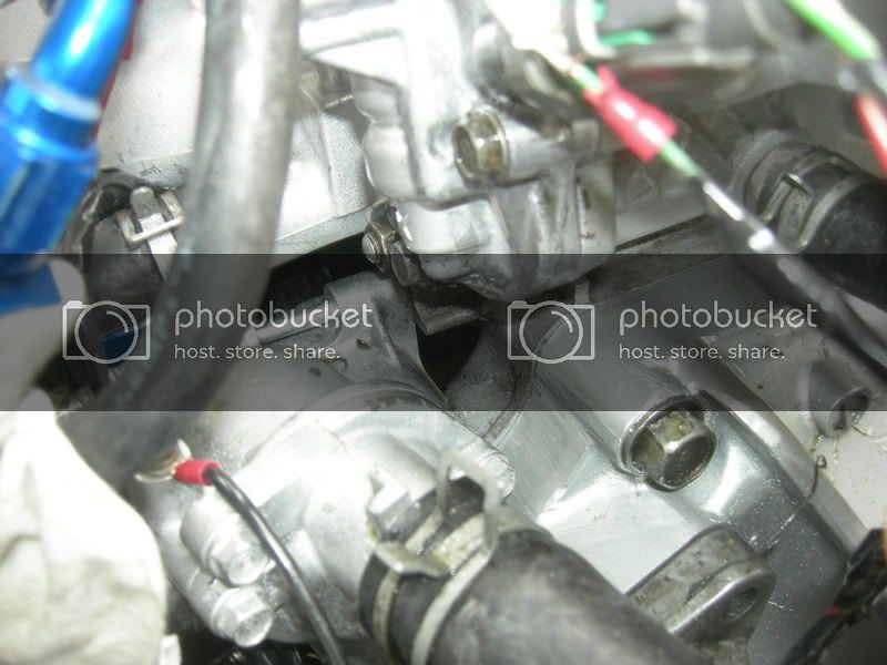

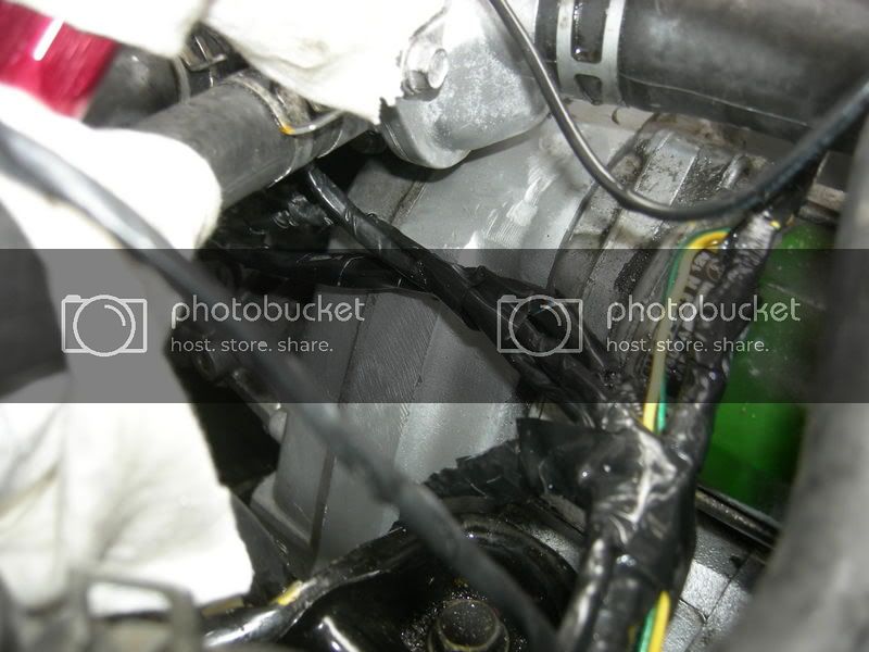

Well guys, I've got some of the problems fixed, but I'm still leaking oil.
Low, by starter:
VTEC selenoid area:

I know it's kinda hard to see the oil, cause it's so clean[i-thank-you], but maybe you guys get the idea...
make sure that the head was properly toqued on the front side, by the vtec solenoid, have seen this happen to a lot of people.
Yeah I'm working on getting a solid tune ASAP.
And I tried calling KMS today to make sure he torqued everything down :p, but he didn't answer.
Anyway, just another one of those things....
Luckily it's not a super bad leak
Yeah I looked at it a little more, and it looks like the back corner(by the vtec noid) is leaking a bit. WHEW!
