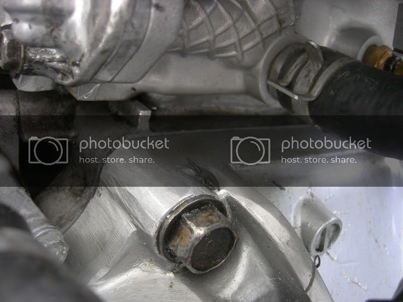

This is where I feel some of the oil(most of it is on the back of the block, dripping onto the exhaust..
It really is hard to tell where it's coming from, because where it is, its coming down onto the axle, and it's spinning it all over the block, so damn near everything is wet!
