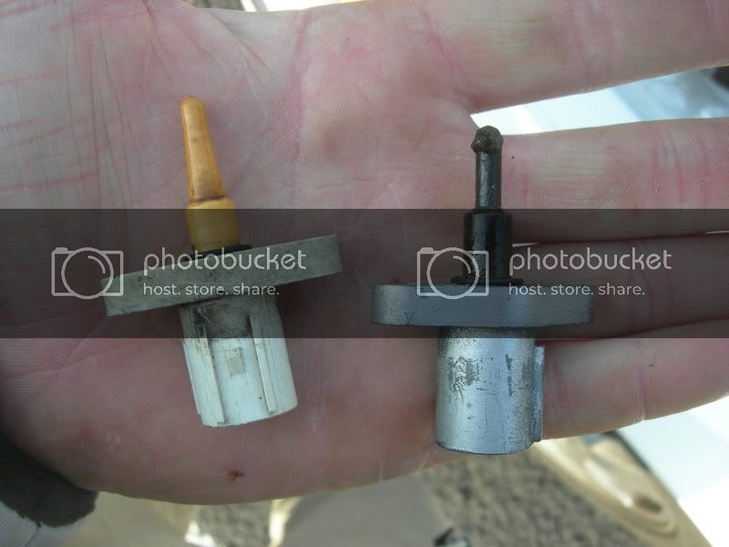

... Then found out why my IAT was throwing a code...

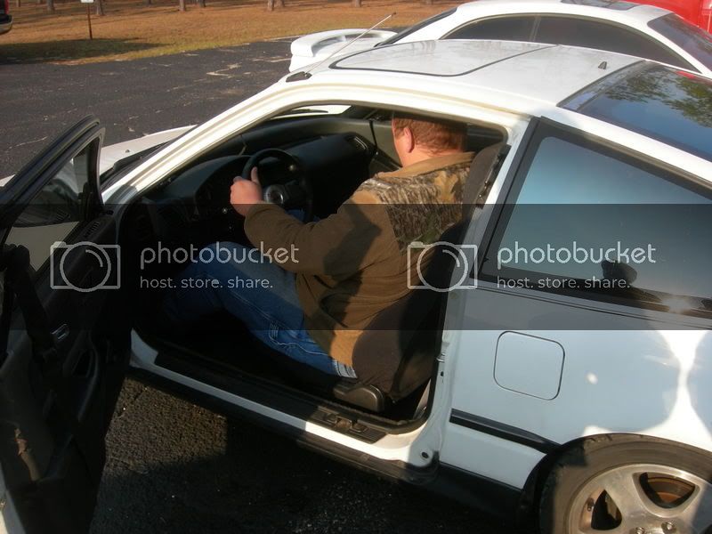

...Then fit my 320lb friend into it...

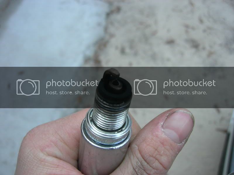

Then pulled the plugs to find out I'm running good! not too lean, not too rich...
+1 on it running, but I need to get exhaust, intake mani, and get it tuned...... BAD
