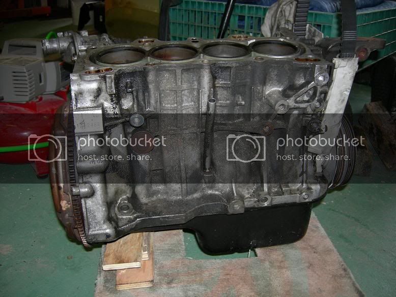

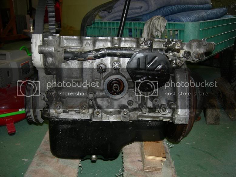

I sent my head off the the local machine shop, and they "helped me out" by breaking chunks off my head AND siezing up a rocker. Thread with pics.

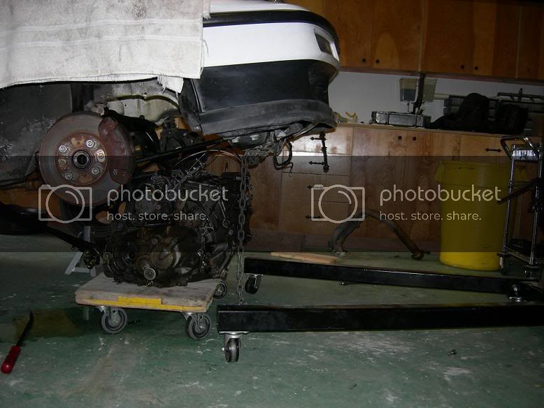

I pulled the motor out a couple days ago-
And now It's about ready to ship out to KMS Performance( Honda Performance - KMS Engine Development) for a complete build. (remember me talking about that earlier?)
It's going in for the following:
micropolish crank
shot peen rods
new forged 11:1 pistons
hone cyl.
overhaul oil pump to 10psi for ever 1,000 rpms.
Head:
stage 2 port and polish
stage 2 valves, springs, retainers
stage 2 cam
He (KMS) told me it would take 1 month to build it and have it sent back out to me.
I'll have a few updates in between, so don't think i've forgotten you guys.
-Andrew
