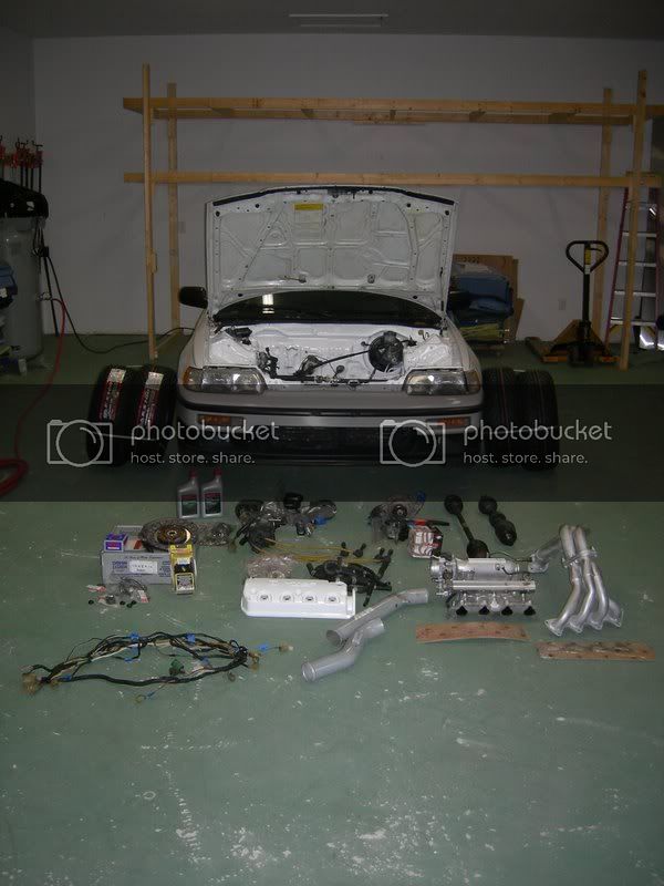

We got the airplane out of the shop, and now theres TONS of room for me!!
So I took advantage of it and went through and layed out everything I'll need when I go to put everything back in. I think I've got everything except a decent filter for the AEM CAI. (dude screwd me on Ebay... said it was a k&n, turned out to be this beast. haha...

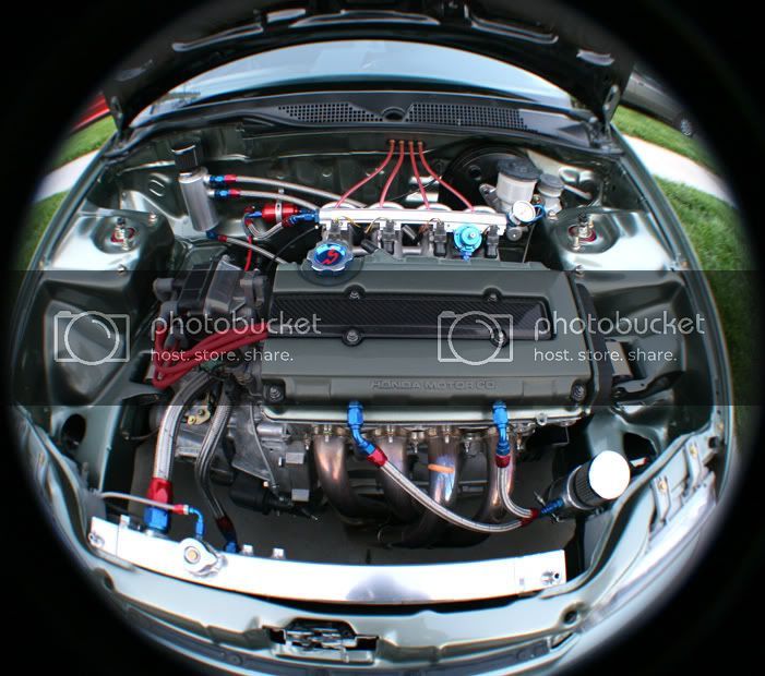

I think I'm gonna do an SS hose look.
I plan on doing an SS/ fuel line to my fuel rail, like in this thread.
Then I'll do a catchcan install, and will eventually just have everything SS'ed.
This is my inspriation picture:

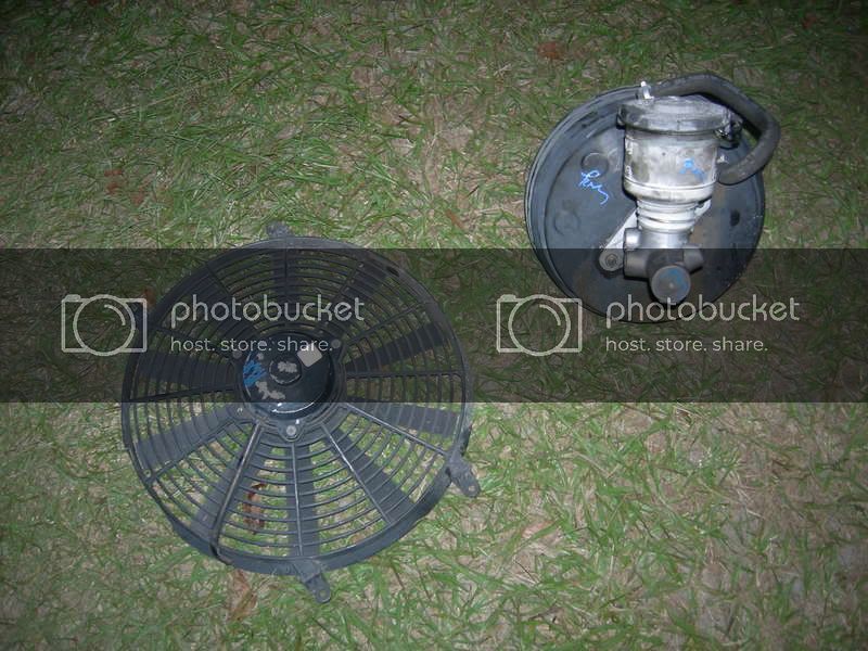

Picked up a cool slim fan today, as well as a BB/MC from a 94-98 teg:
it came stock on a mercedes (pic), but I found one a little bigger one just laying in a different mercedes, and picked it up for $25 for the fan, $25 for the BB/MC!

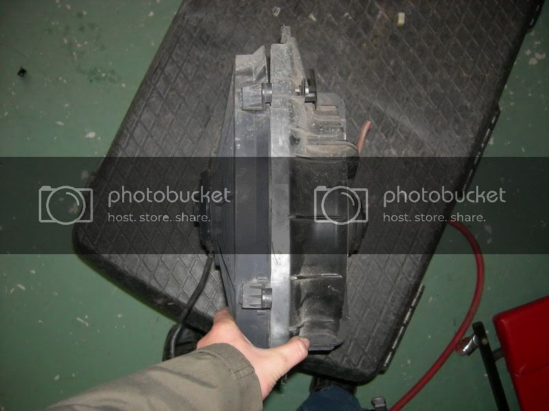

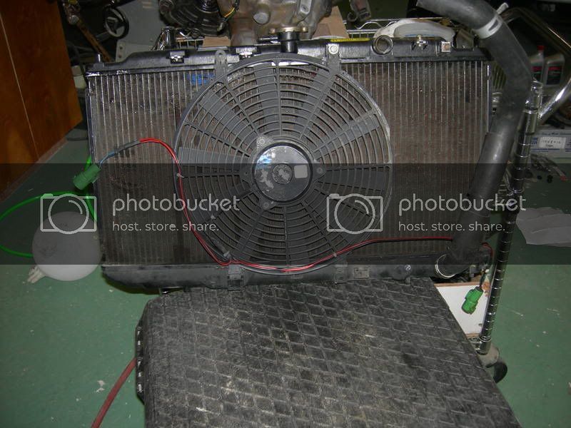

I got my slim fan installed! I wired both the A/C fan switch and the engine coolant fan switch to it, so it will be used for both(since its so much bigger I don't see any problem.).
And to show how much slimmer it is... the new fan is 3 1/2", the old fan is 5 1/2"!
And I got the injectors spliced so I can get the wires in between the Intake runners so I can run the harness underneath the IM.
