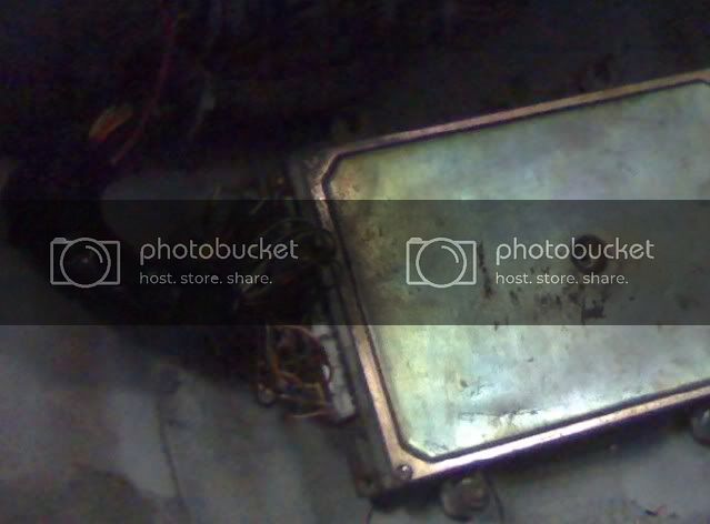

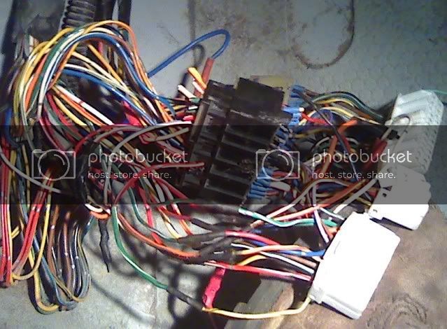

I thought fuel first but after filling the cell to the top, still did it. We spent the first part of the morning checking electrical stuff...and we found the main relay did fail, was losing power for the fuel, then we found that the obd0 to obd1 jumper harness had several bad connections only held together by the shrink tube...and one of them was the crank position sensor circuit. my buddy is re-soldering every connection at the ecu as Im hiding in here updating...lol. after the soldering is all done I'll be in to do the videos...they are short, but you'll get the pic...thaks for the ideas much appreciated.:D

as for the electrical gremlins we found in the car this we believe is the culprit(or one of them) for the dying out issue...bad jumper solder job.
so we by passed the jumper and wired directly...
