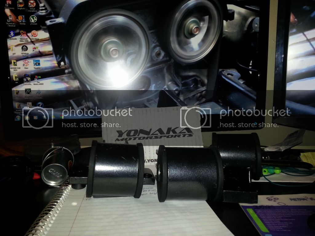

i got these from passwordjdm.com
i know they are not hasport or whatever, i had the money to but them but i figured i could use the extra money to buy some other shit lol
