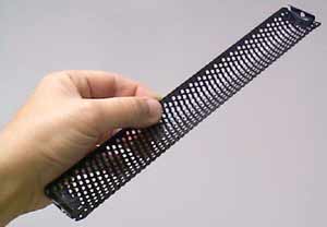

Brad, not too bad for a first timer on the bondo, try to spread more uniform and smooth, makes for less sanding after. And pick up a cheese grader, use it to rough shape when its still setting up, when its somewhat soft.
also try to us less hardener in there.your bondo is starting to cure before you mold it,you will want it to dry slowly.so you can wok with it more

Thanks for the cheese greater idea. My uncle suggested something too, I think he said it was a body file.
Yeah I didnt mean a literal cheese grater from your moms kitchin.:D One of these.
