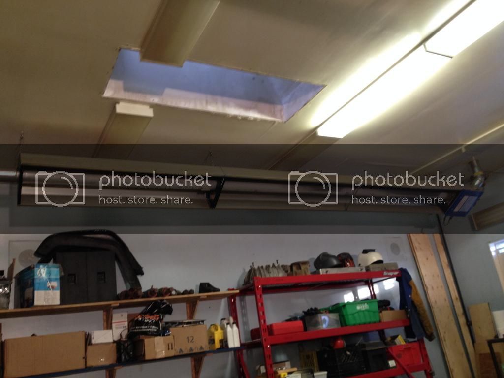

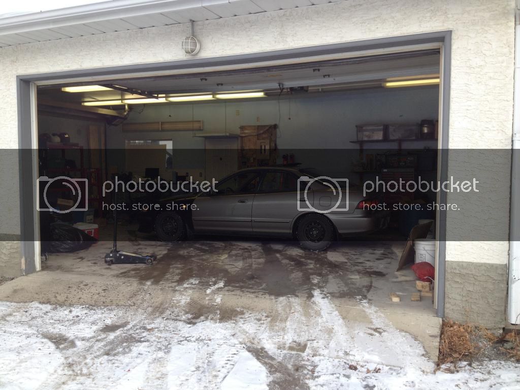

Detached, heated, three car garage at the new place we rent :thumbsup:

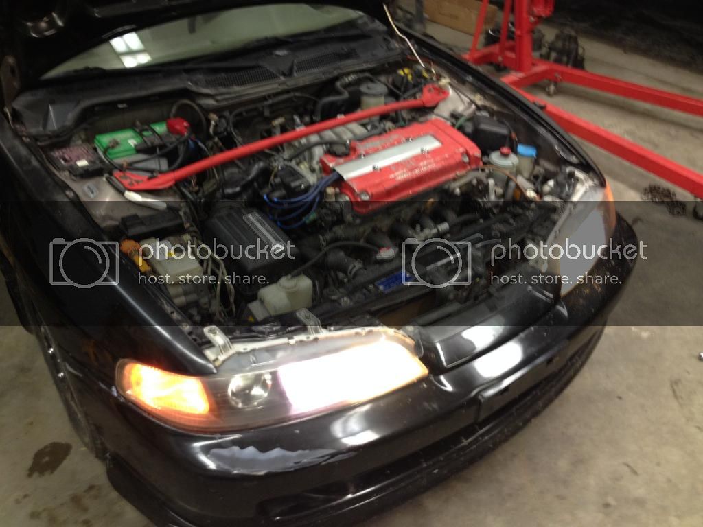

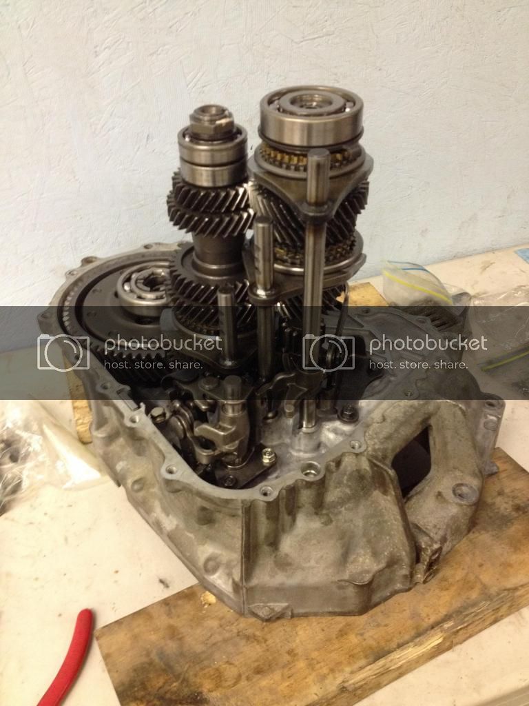

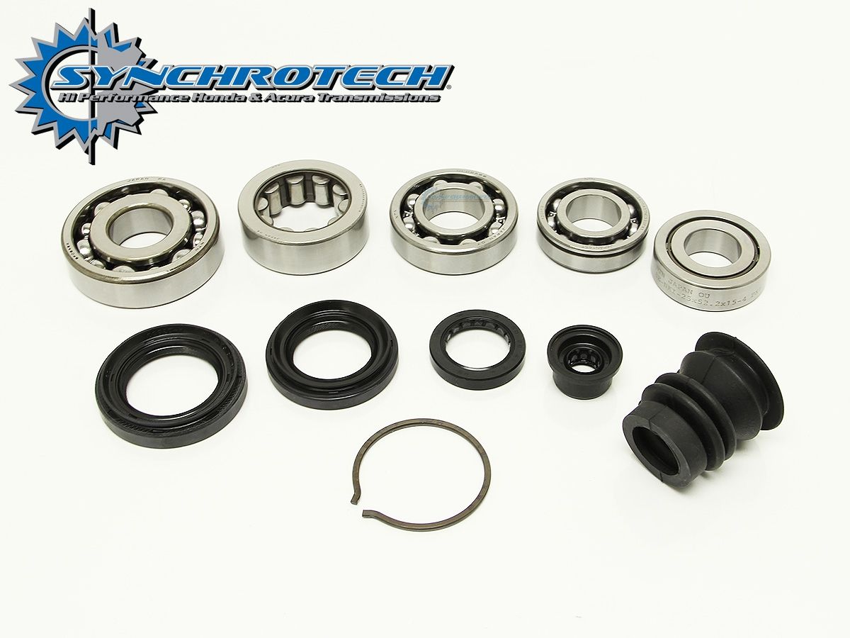

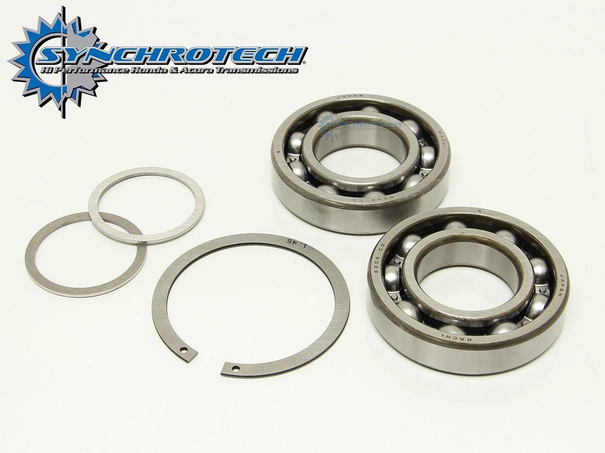

Rebuilding the GSR trans with the new ITR diff :) Roommates uncle runs/owns a Kenworth dealer and is going to get the case sent through the parts washer. Just waiting on bearings/seals from Syncrotech
'98+ ITR differential bearings
Bearings & seals

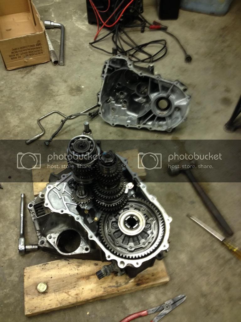

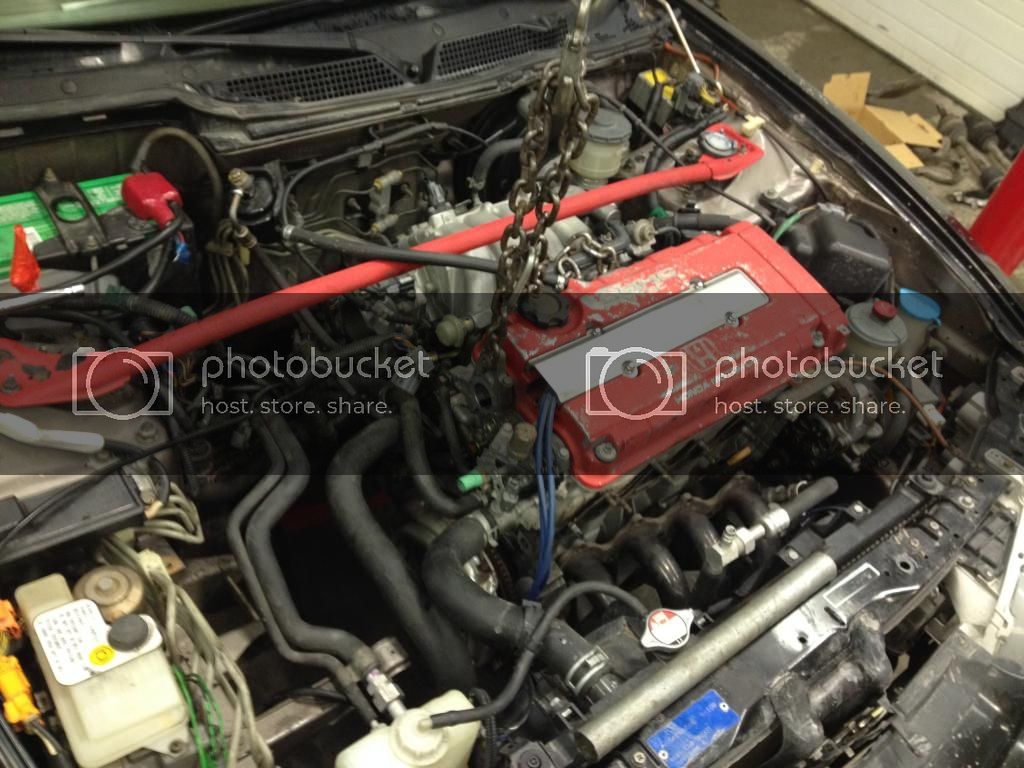

Finished and installed the new trans a week before Christmas. Put the car in the garage on friday after work, pulled the old trans, swapped 5th gear, assembled the new trans, installed, then drove to wok monday :)
Friday

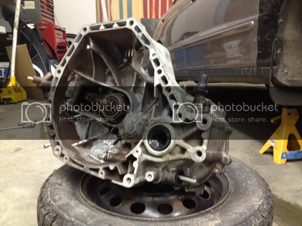

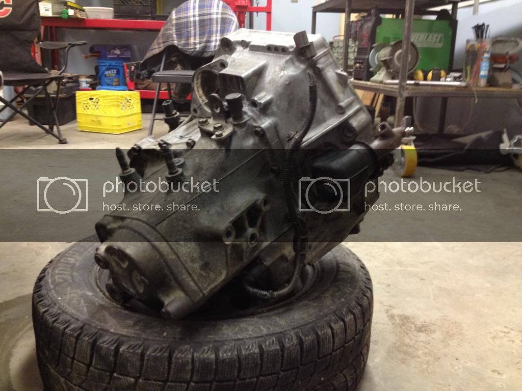

Old trans out

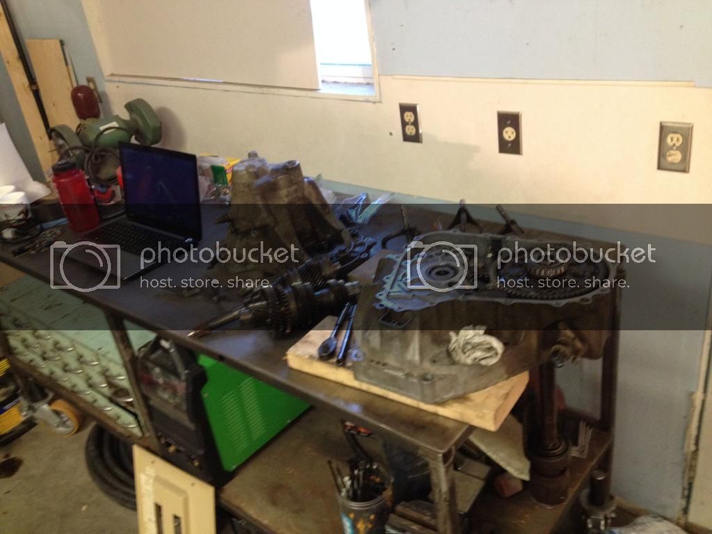

Old trans apart

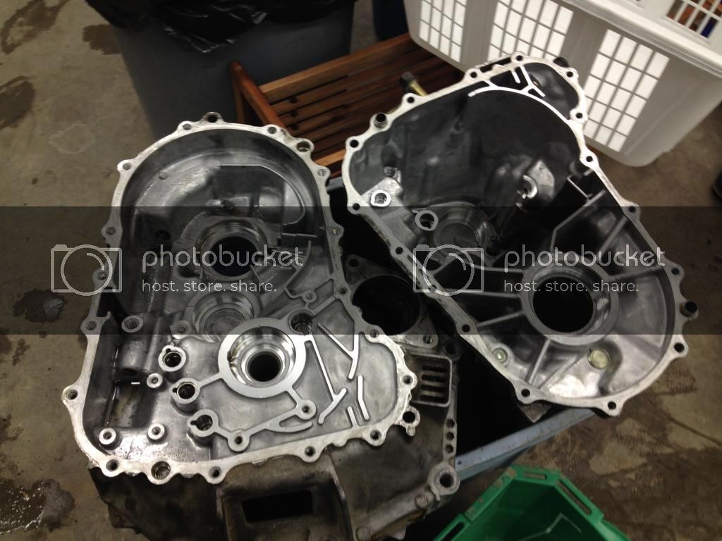

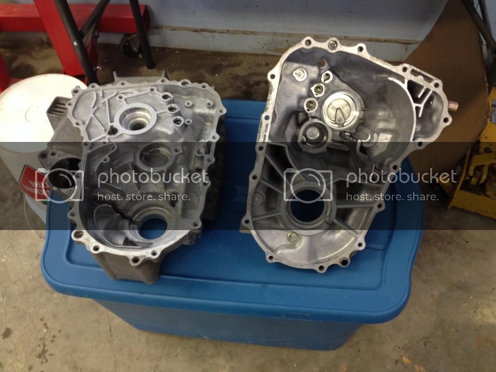

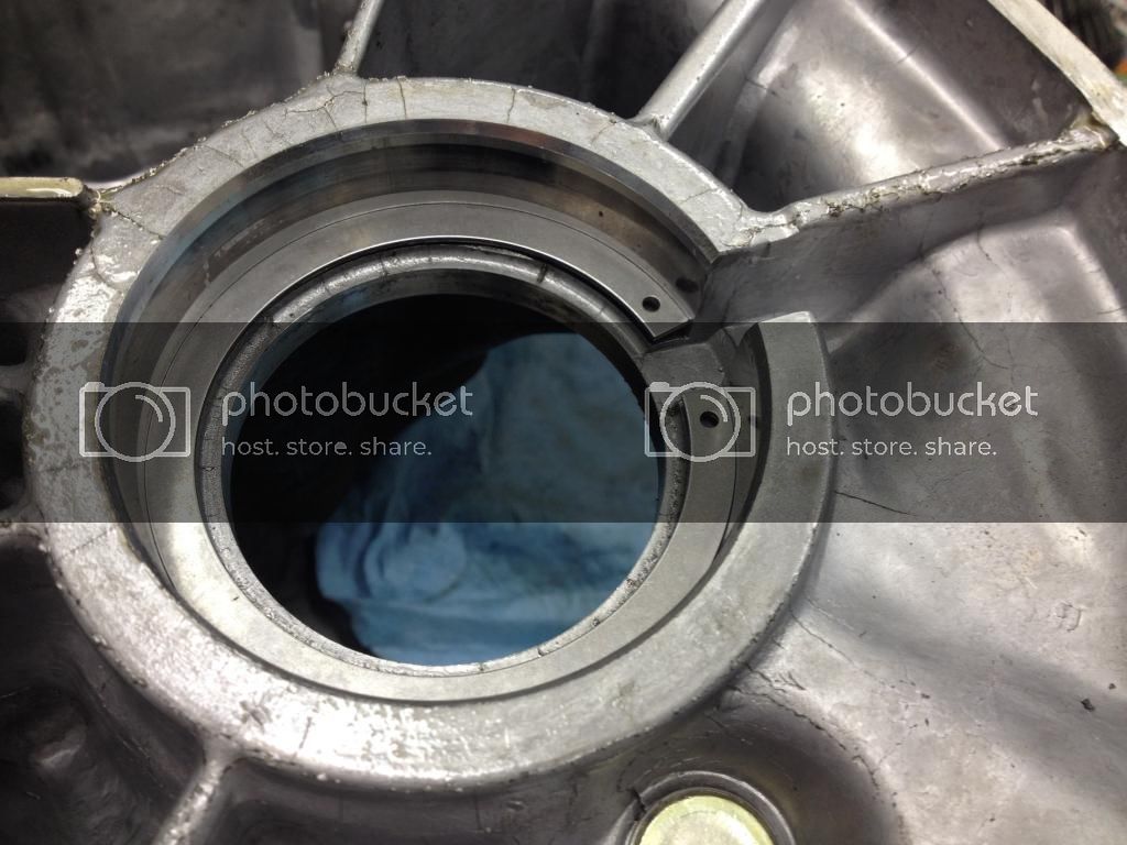

New trans case cleaned

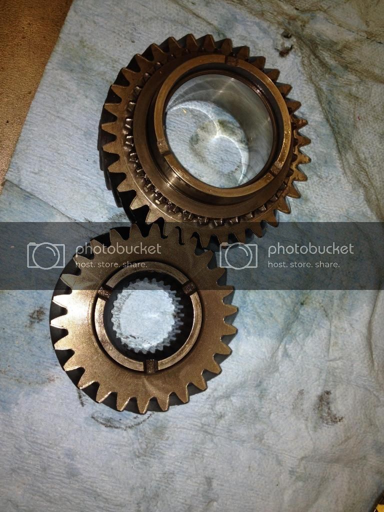

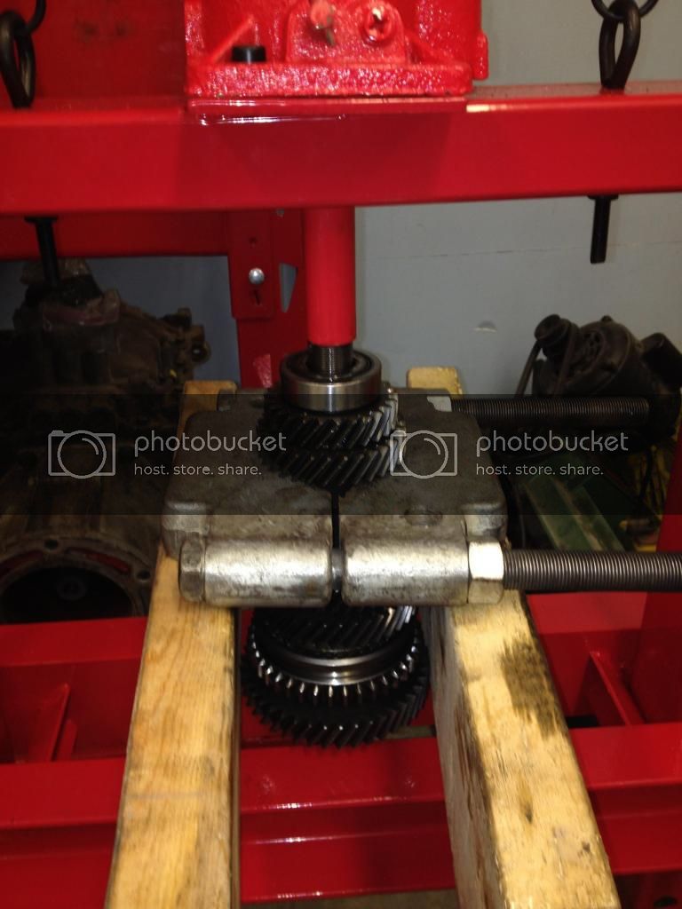

Pressing off the LS 5th gear set
LS 5th

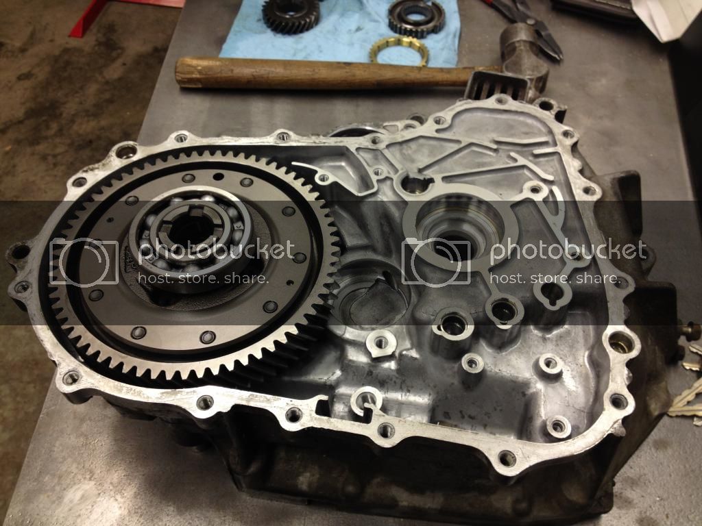

New gear set put together with new bearings

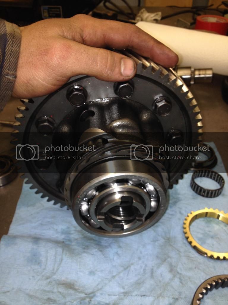

New updated style bearings on the ITR LSD
In she goes
Gear sets and shifter forks in right after
After sizing my differential pre-load I had to order a specific shim from the dealer, it arrived the following morning
Back together
Mated together at last
It's been performing great ever since!

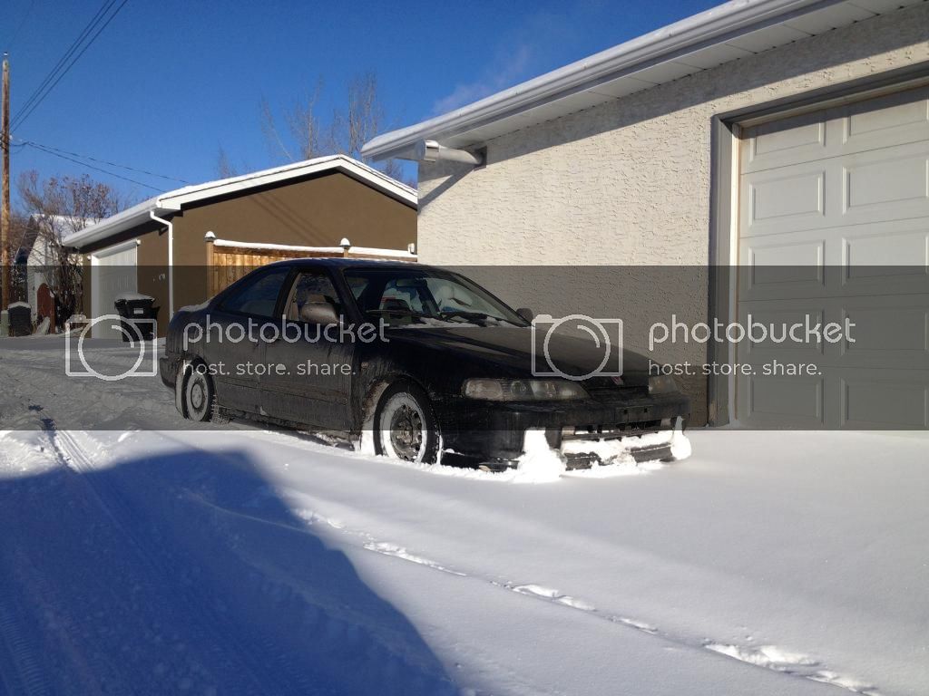

It was winter since I posted. Little has been done to the car, city life is consuming me

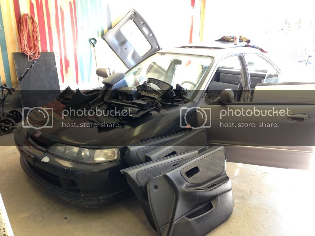

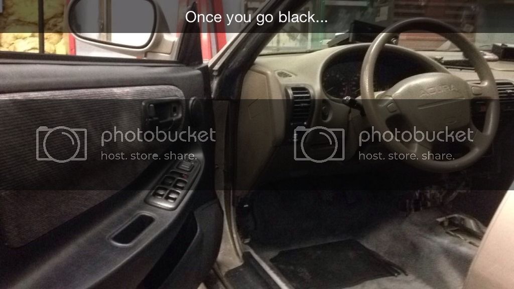

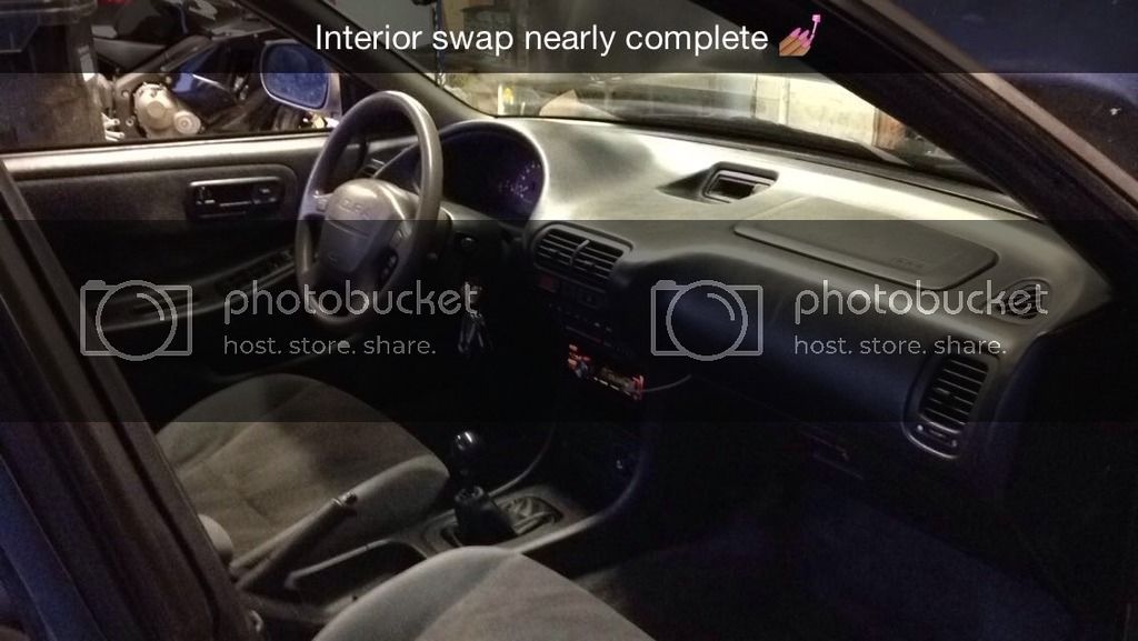

Found a low mileage black interior swap, I was very, very happy about this

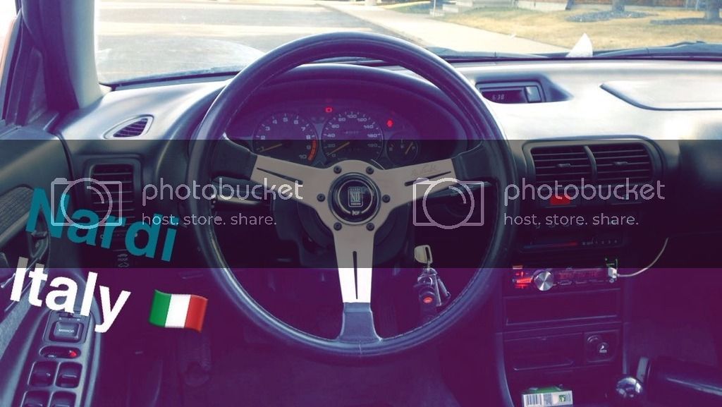

Finally installed my Nardi, first time on a car since I bought it a couple years ago!

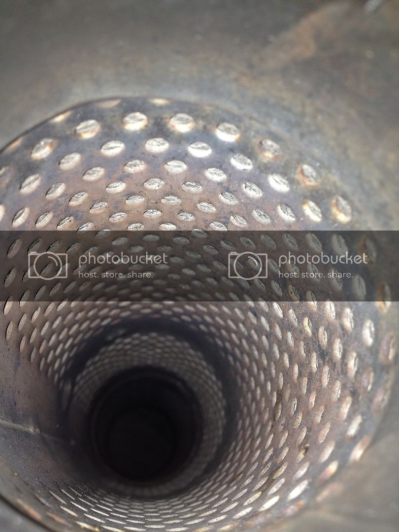

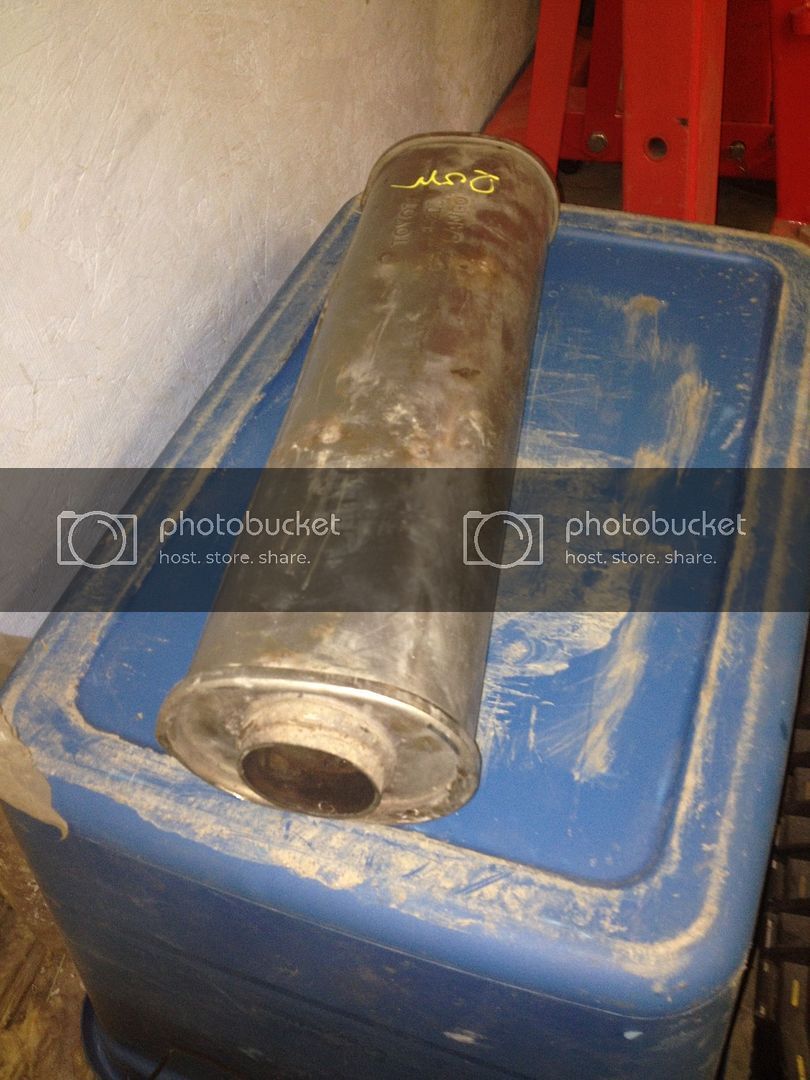

Installed a nice large 2.5" stainless resonator off a Lexus on the cheap
