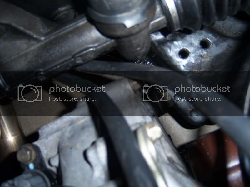

PS gear box is leaking b/c the trans is hitting a bolt. Got a used manual rack today

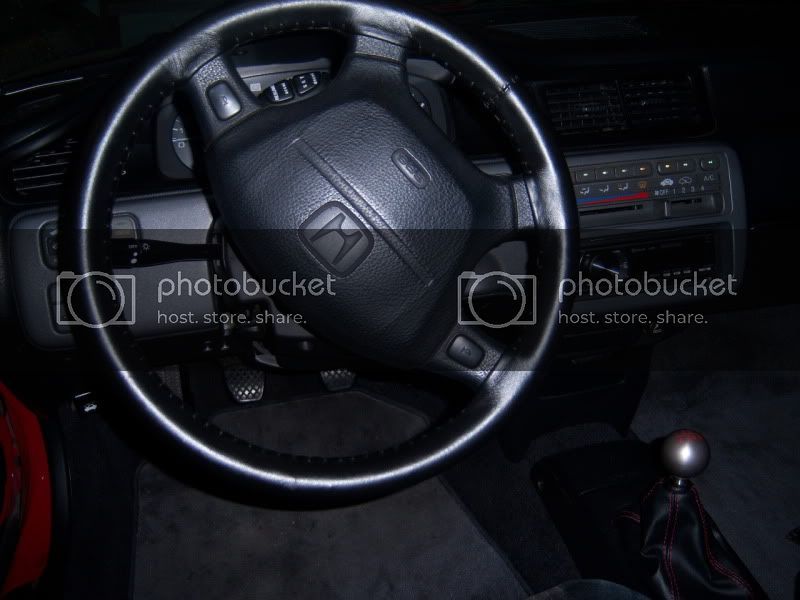

My steering wheel is 90 degrees out when Tires are straight (steering wheel turned left). Talked to a buddy who does alignments and he said it should be fine when I get new tie rods and an alignment. Didn't drive it.....I'm spent.

Do you have cruise and an air bag? The wiring harness has limits when you turn the steering wheel. I just ripped my harness apart when I got my car back together. I believe you get 3 1/2 turns each way before it rips apart. Id recommend taking out the universal joint and aligning the steering wheel best you can before the alignment. :)
My dad and I fought that damn yolk and where it connects at the steering rack
I was underneath while my dad was in the cabin. He said he tried to collapse the column up but it didn't budge
He must have turned the wheel to get a connection and thats how she came out.
We had it better but the two bolts near the gear box were feeling tight and wrong with an inch left to go.
They came out very easy and had no issues so we were stumped.....took it back off and chased the treads.
This was a pain. I took off the header, O2's, shiftter cables, various little things and two motor mounts.
I have been lazy and putting this off (b/c I knew it would take me too long)
Both wheels are slightly turning away from eachother. It's not that bad but still a 2+ mile drive so I may rent a dolly.
I am worn out. But I will mess with it next weekend.
Is there some way to get the steering wheel better without taking the rack loose and fighting that crap again???? PLEASE

What my problem was: (you can see the PS fluid that leaked out the bottom of the gearbox)

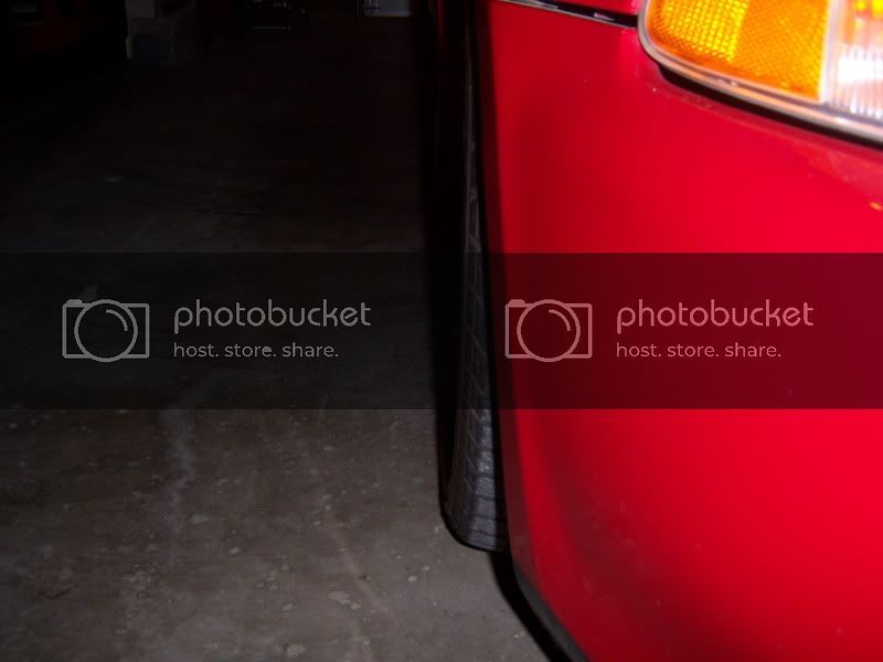

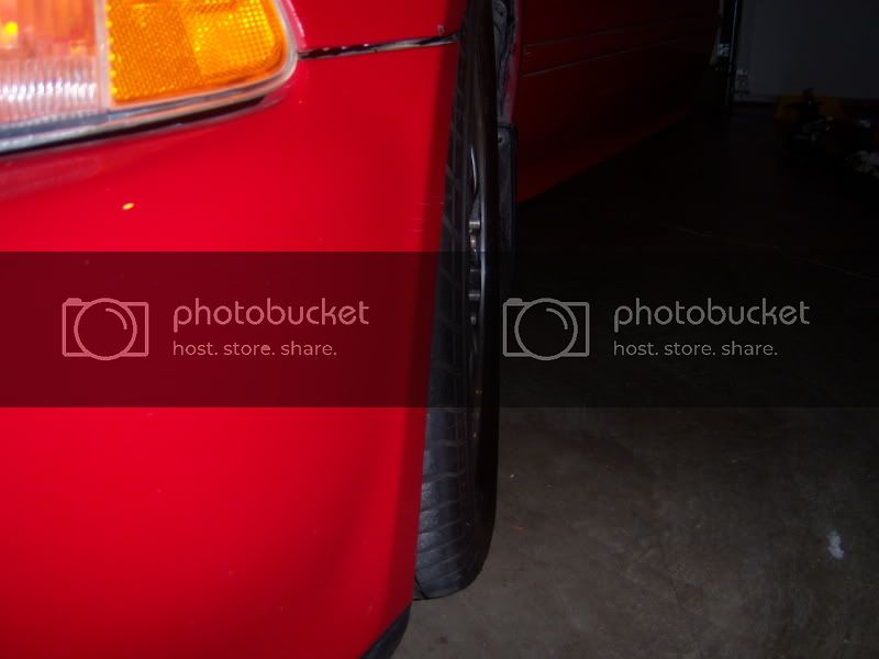

What I have now (from the top......not jacking it up this morning)
Wheel alignment isn't that off......I think I can drive it......my dad thinks its fine for the trip to the shop.
And my problem.......
I got a week to figure out a plan to fix the steering wheel situation......will work on it next weekend.
Ugh.....no. Plus I have a huge rubber grommet there. I may need to take the column out or the rack.
How is the steering wheel mounted to the shaft? Are Honda's different from the old spline setup? Never had one off.
I am thinking (well.....hoping) that the joint will come off and I can reset it.
It seemed like there was some play in the steering column cylindrical gear that the joint attaches to.
So I figure it is worth a shot.

*Edit - I was looking at the parts schematic on Majestic Honda ( http://www.hondaautomotiveparts.com...DR+SI&catcgry4=KA5MT&catcgry5=STEERING+COLUMN ) and if you prefer working under the dash more than the hood, it looks like you may be able to get access to the lock bolt for the shaft from inside the car. Maybe, maybe not; but it may be worth looking into. Obviously, I don't have a shop manual for a 92 Civic

I ordered new OEM outer tie rods, dust covers and bracket for the manual rack. Will install them in a week or two and fix the steering wheel so I can drive this car again.
