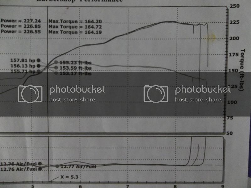

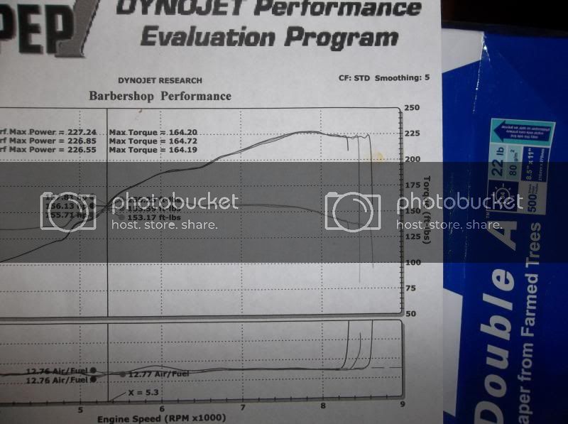

I'll post a picture of the dyno sheet. Motor hit a tiny bit over 227whp too but the final was lower hp with little more tq.
Middle Run was final run. He lost the data of the first run after air/fuel tweak only (215whp)
Closer Picture
That's an awesome looking graph man- if you can just keep it breathing out to 8500 like it does at 7500 you'd be right on top of 250whp. That was my goal with my GSR build- maintain the 150-160 lbft out to 8500 and I would have hit it...
