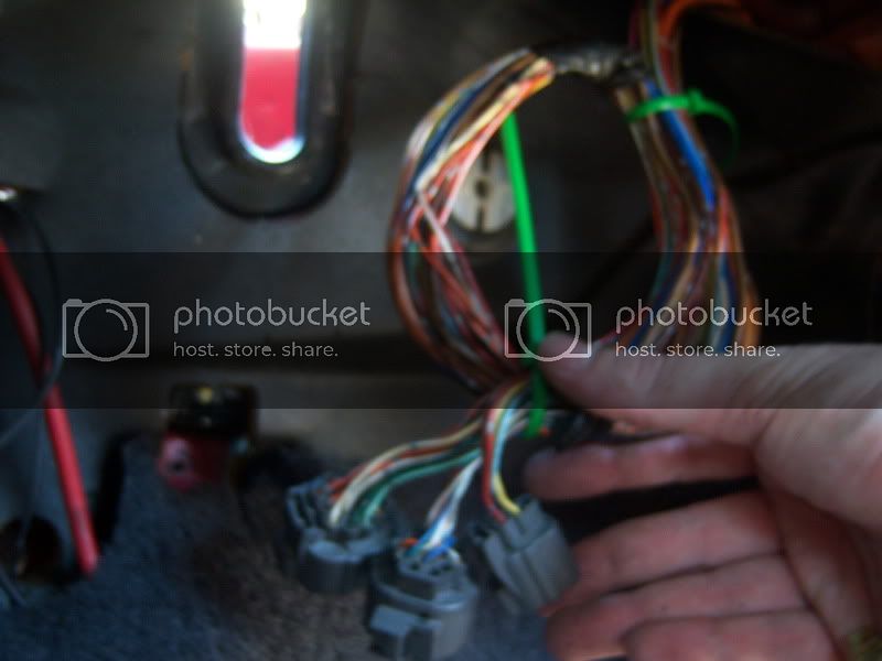

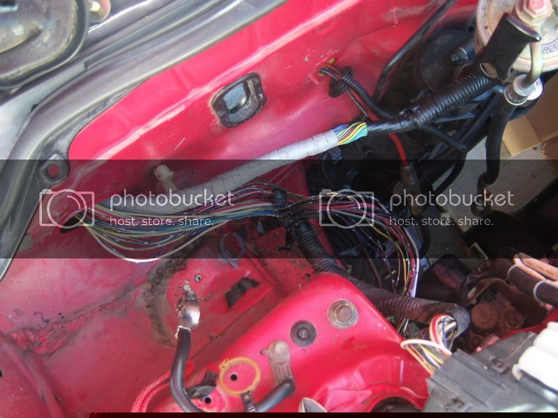

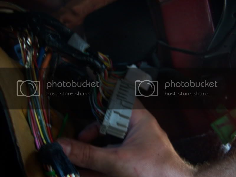

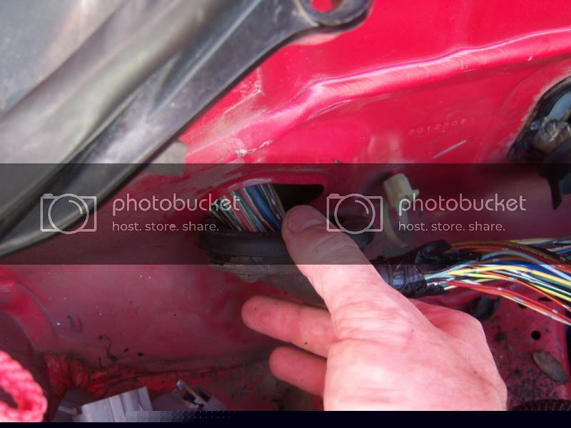

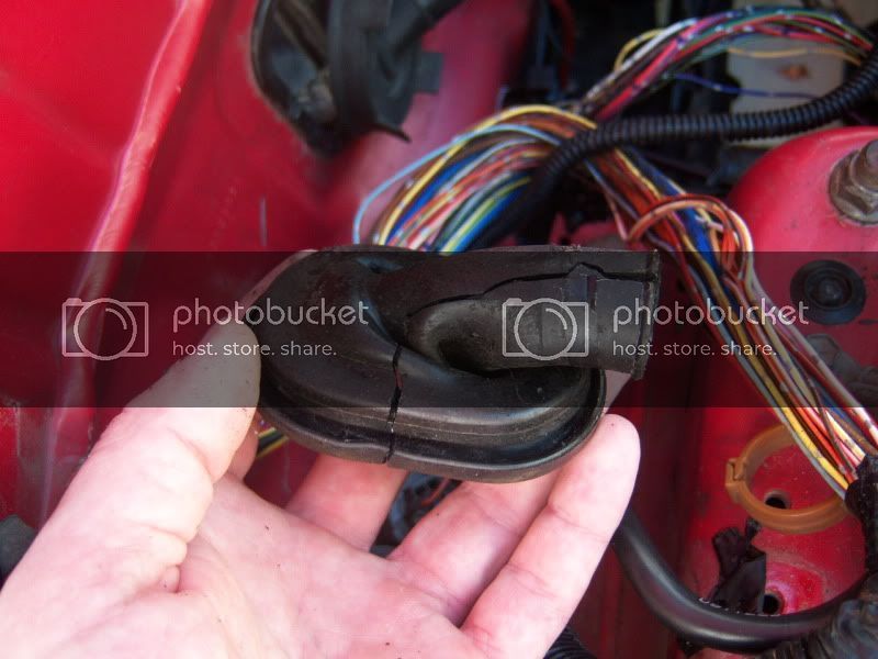

Took apart the looms and electrical tape (lots of it) on the passenger side harness (engine harness was intertwined w/other electrical)
I took it apart so I could pull the non-needed engine harness plugs through the firewall and I got them zipped tied right now.
This is as far as the JDM K-harness goes (suppose to go to the other side :thumbsdown:) but I will make it work

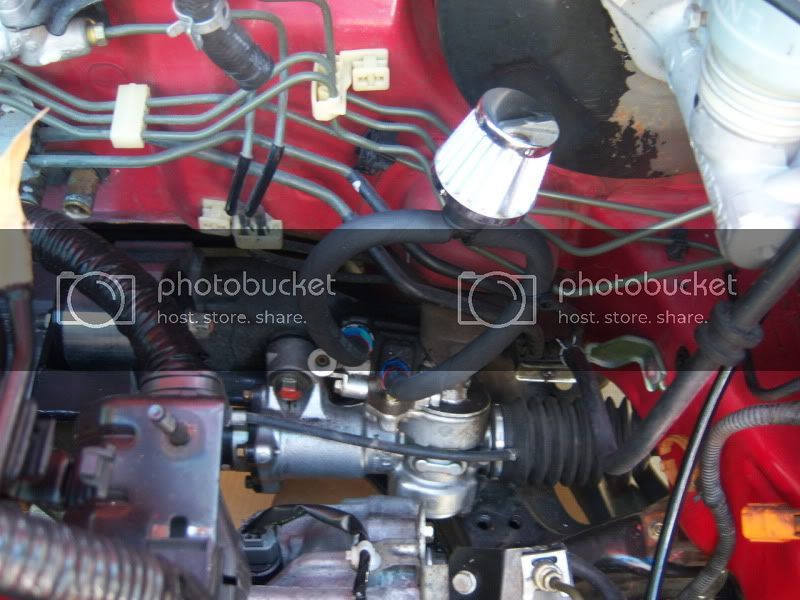

Also.....no power steering but a power steering rack. Many will replace the rack with a manual one. Its $70-80 and then you got to install it.....then get it aligned.
I decided to loop the 2 main lines and cap the one that is made to cool the fluid (still need to buy the bolt to plug it).
Couldn't find metric fittings that had a barbed end so I went with adapters to AN fittings.
This way I can run OEM or MR2 PS later (if I want)
Wished I could have made the lines a little shorter (cleaner looking) but the T-fitting made it hard.

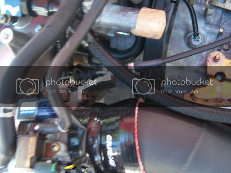

I also have to run the Evap Purge on the TB (which I think it makes hood clearance worse)
Once I got K-Pro.....it wont matter but I do not want a CEL (running 2 O2 sensors too)
I'm going to cut a 3inch wide piece out of the structure.
Yeah......I got the area for the hood structure ready :thumbsup:
I read that to, that the EVAP purge hits the hood, however I'm running the Evap purge as well and I havent had any issues with it hitting my hood. I did move my hood latch up a bit when I was trying to clear the vacuum hose. Maybe it also depends on which TB you use.
Man thats sweet; I want a k20r pretty bad but I have dumped too much money already myself.
Wonder if I can simply unhook it from the TB (plug the hole) and hide it under the intake? Keep it plugged into the harness but let the other end just float in the atmosphere.
I really don't know if it matter though :shrug2:

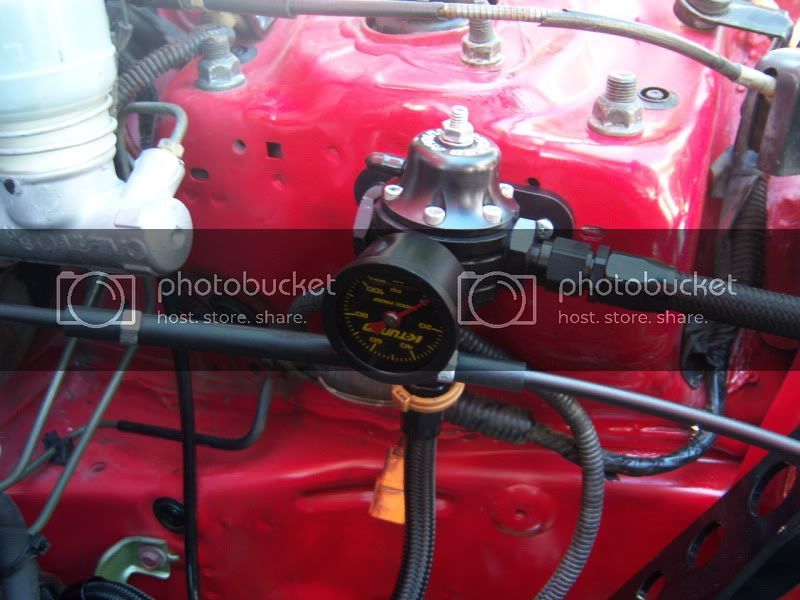

Got the stock lines out and my swap clutch line put in and my fuel pressure regulator.

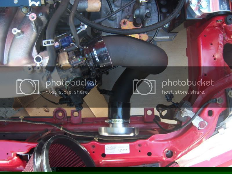

Just thought I would show a quick pic of my intake (high radius bends 3")
leave it to me to notice your FPR gauge is upside down. Lol.
Love the swap, want one in my EG so bad. Good luck!
The FPR gauge feels way too loose when its upright but I cannot get it tightened around another 180 degrees either :shrug2:
EDIT: I know some Teflon tape would get it where I want but I have read that its not a good idea for gas systems :shrug2:
I had a similar issue with the fuel pressure gauge on my HR fuel rail. I contacted Hybrid Racing and they suggested Permatex - 56521 Hi-performance thread sealant. Permatex says its ok for fuel fittings.
http://www.permatex.com/products/au..._permatex_high_performance_thread_sealant.htm
