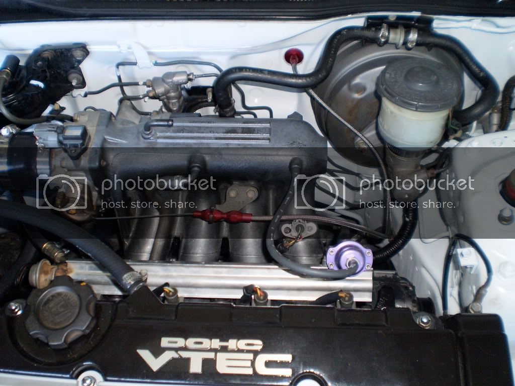

Can anyone please post a few clear pics of their B16 intake manifold area just so I can get a clear idea ? Please ?
This is the best pic I have right now. i added a picture from a helms manual that shows a general description of where the vacuum lines run. It may be slightly different then what yours looks like but it is a good reference. Also the charcoal canister is only needed if you have emissions laws. If you take it out it wont hurt anything.

^ Bro mines totally different. Like each and every sensor placement etc. Even the intake mani itself. I can't understand :S

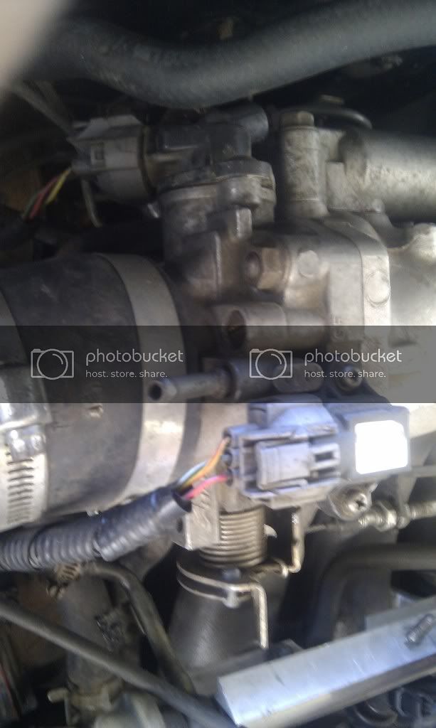

ooo okk!!! and what about the other sensors and hoses ? The nipple at the back of the intake manifold, where does the hose from it go to ?
Pictures will help. I think you are talking about the one that connects to the brake booster. You should google a helms manual. I don't mind helping you out, but a lot of these questions could be answered if you had a manual.who helped you do the swap? Can they not help you out?
^ The guy who swapped is out of town at the moment. Not even sure when he'll be back. Helms manual for B16a4 ? Can you find me one ? I googled it but all i got was b16a2 etc, those are different from mine.
No I can not find one for you. They are all basically the same, or atleast close enough that you should be able figure it out. Like I said I will help a little, but I am not going to hold your hand. Did you look at the vacuum diagram that I posted with the picture of my intake? It is an attachment at the bottom of the post. It is difficult to tell where evrything goes because I can not see everything.
