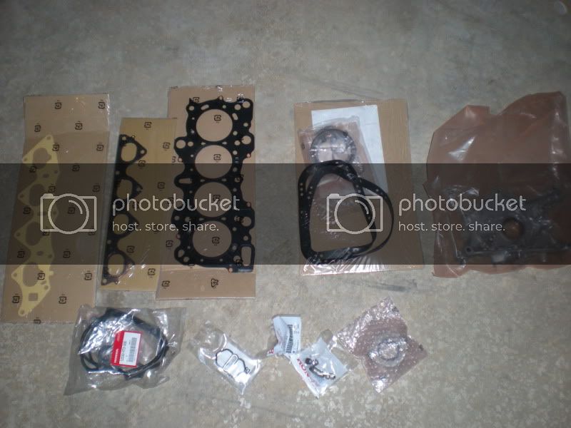

My first shipment of OEM goodies showed up at my desk today :)
-ITR Oil pump
-Throw out bearing
-Top & bottom end complete gasket sets
