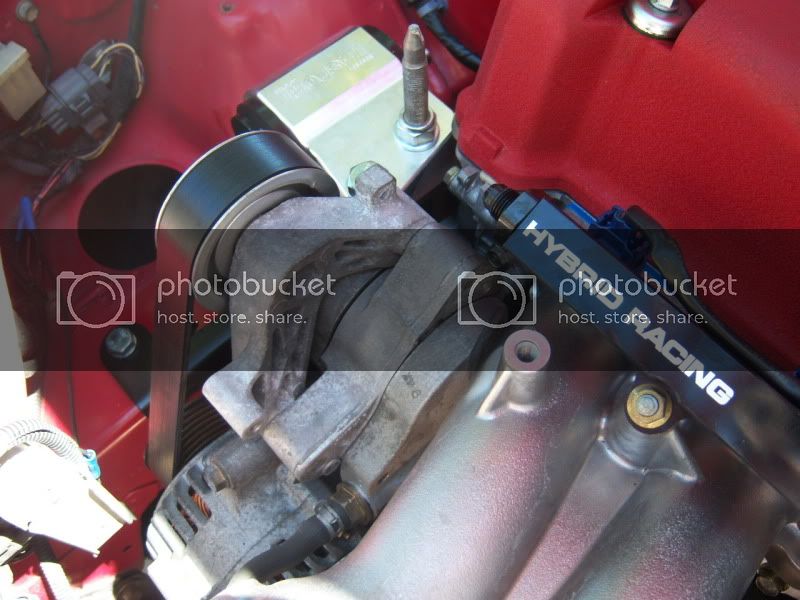

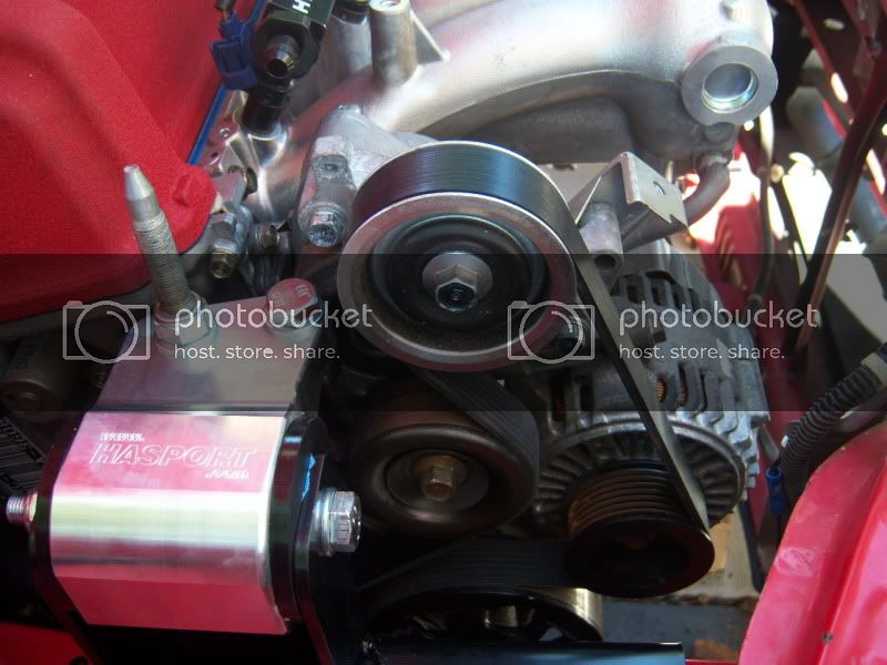

You know you can run a K20Z3 idler pulley and a 51" serpentine belt if you are deleting AC and PS pumps. Looks clean and is much cheaper. I paid $50 for the used idler and $30 for a new Napa belt. The aftermarket ones are nice and pretty but my OEM idler (has tensioner built in) has the same patina as the rest of the oil pump housing and has prefect tension with the belt. I can get you the napa belt number too.
You got a steal for that whole swap if it was only $1500.
Looks good, but i already have the PS &AC delete and Alt relocation kit installed

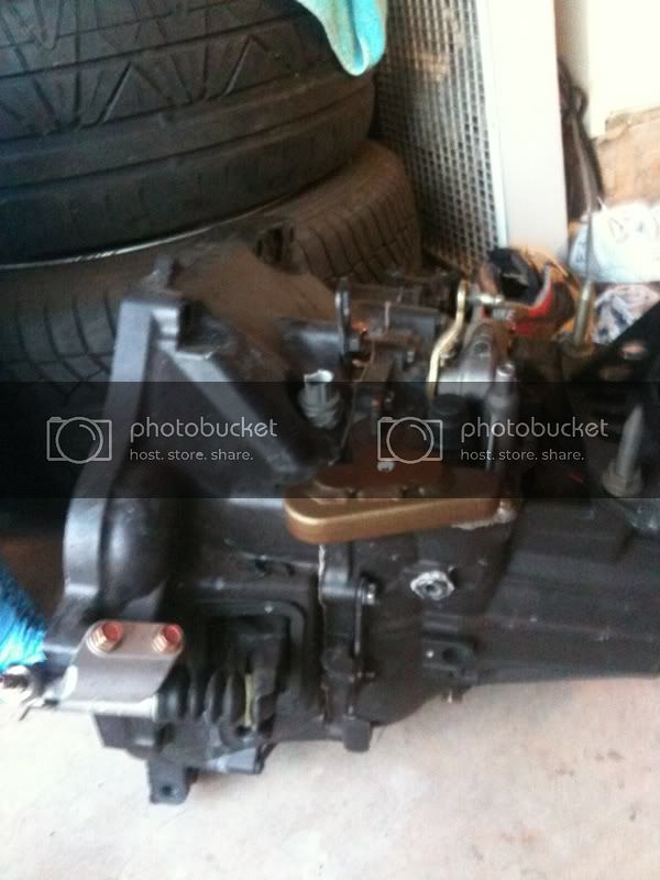

And i contact a guy about purchasing his Tranny w/ Quaife LSD so im waiting on that and the JRSC kit to both go through so i can relax and be done with searching the Forum every second im off work for a while.
No problem.....just thought I would spread the knowledge. No alternator re-locate or anything is really needed. Those delete kits are one of those K-swap products that makes you think its the solution.....when its really just one solution.
