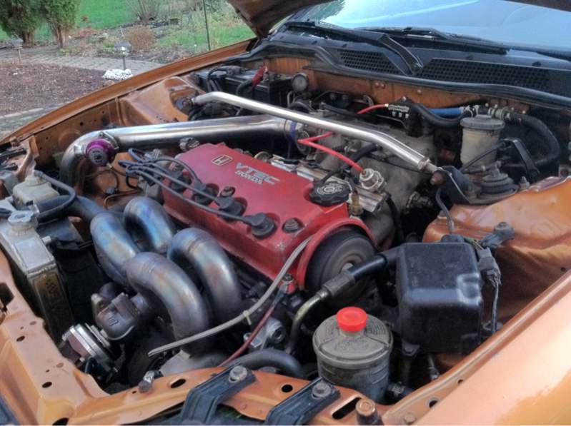

But snapped this decent shot the other day.

if its not a show car.. what for?
Rust in the engine bay, we haven't had the roads salted yet this year, but if there's lots of dirt and crap on everything, it'll stick longer.
yeah it could use alittle clean up here and there but its a Daily, not a show car. Im satiafied with the overall look of the build.
Then again Pickles, youre anal about that stuff. lol

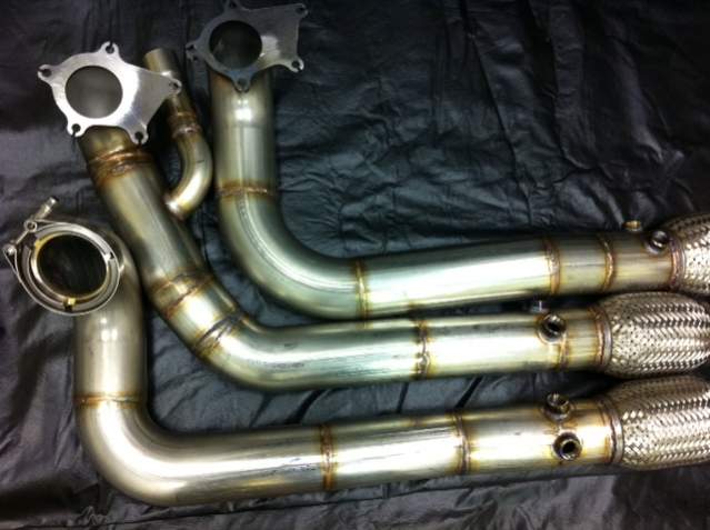

Recieved this pic from Go-Autoworks this morning. Mine is the 5bolt on top.
Its shipped, should be Friday.

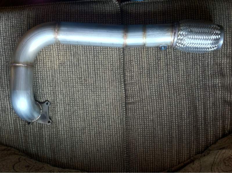

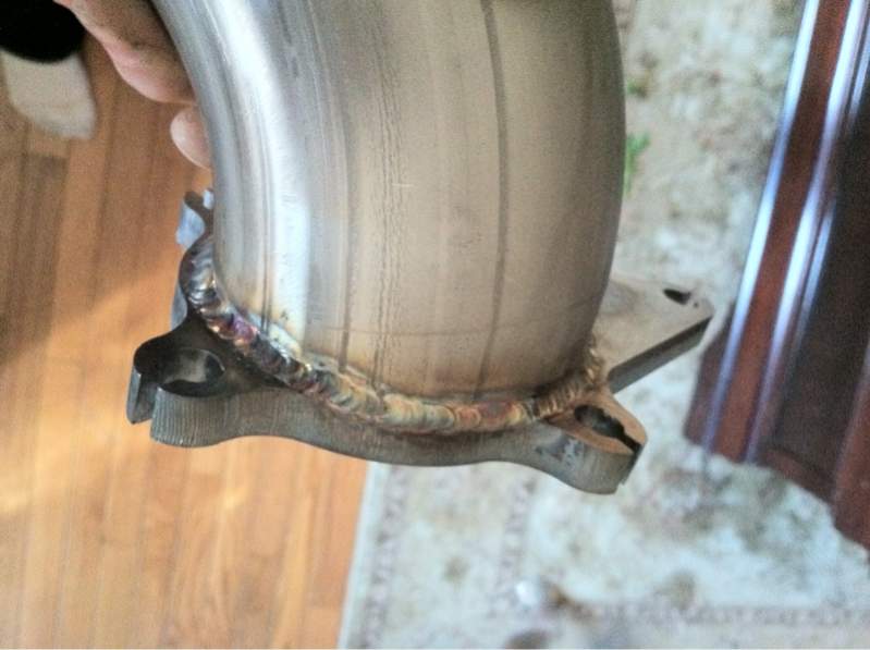

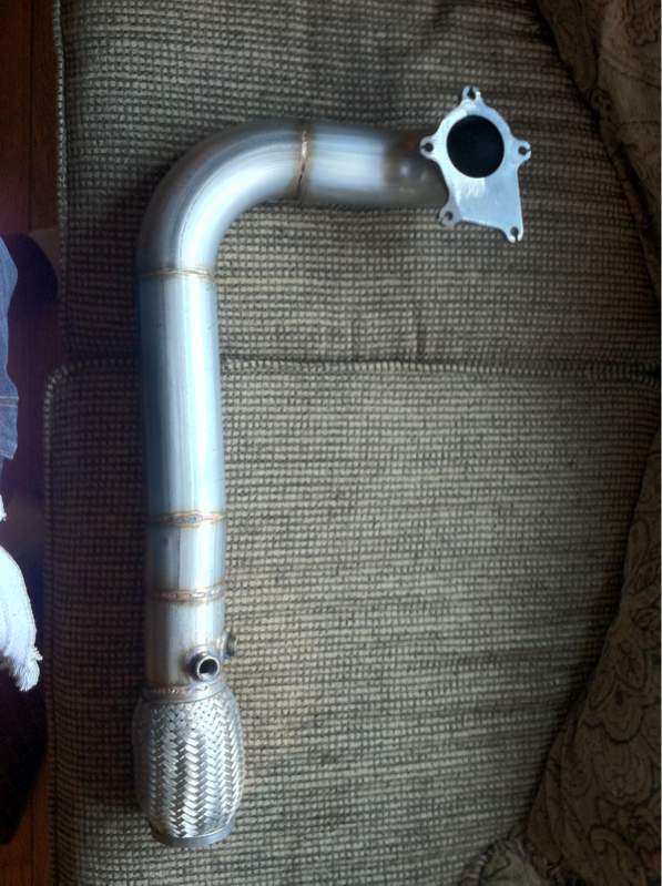

Pix of the downpipe. Its open end, so ill have to get a flange welded on first before i can use it.

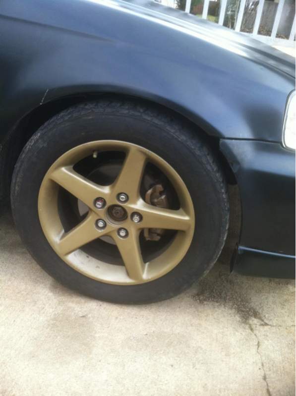

I got offered to trade a set of prelude wheels i was gonna use for winter, for these rsx wheels. Idk the tire life of either set yet because my 'lude wheels havr been in storage for quite some time.
opinions?
Update: Turns out the tires on the Lude wheels are shot, so he said hes interested in flat out buying them as is.
ANyone know how much lude wheels are worth?

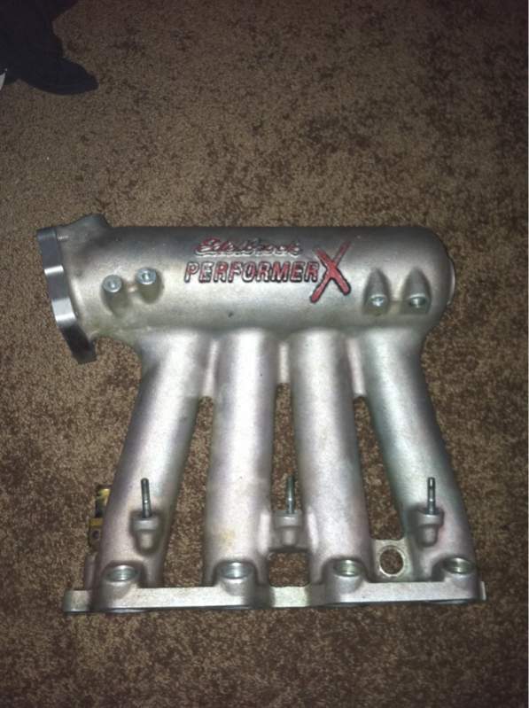

Did some work for a friend and scored this bad boy. Replacing my skunk2 manifold for this for some much better flow.
Matt. Did you use or block off the extra ports on the bottom of the manifold? I have a vacuum block, so i dont really need those ports right?
I blocked off any ports that I wasn't using. You can either use the vacuum manifold, or the extra ports. It doesn't really matter. I did find my wastegate/BOV to be more accurate when they were run directly from sources and not through a manifold first.
Yeah that's the only crappy thing about the manifold. It moved my TB down about 3 inches so I had to re-design the upper portion of my charge piping. It's worth the work though, my car made significantly more power on the same amount of boost.
