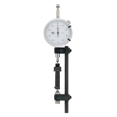

also picked up a rod bolt stretch guage from summit, this is the one:
