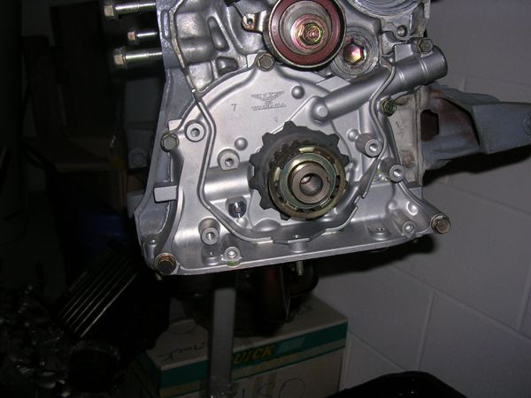

mains, rod end caps, and crank girdle installed. also oil pump, water pump and rear main seal, and finally windage tray.

im hesitant to install the head just yet. since i still need to transport the engine back to my place in baltimore before i can install it. and with my apt being on the 2nd floor it might be better to just wait to put the main pieces together afterwards.
enjoy :)
