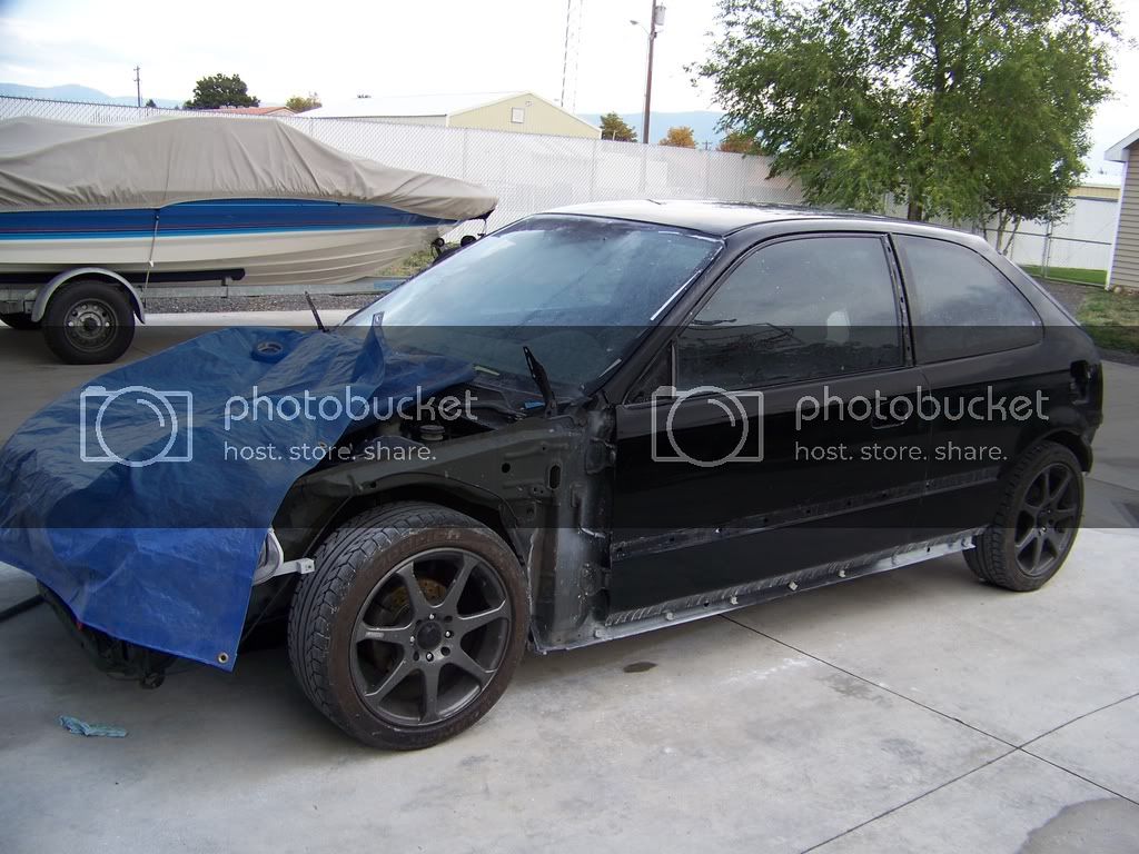

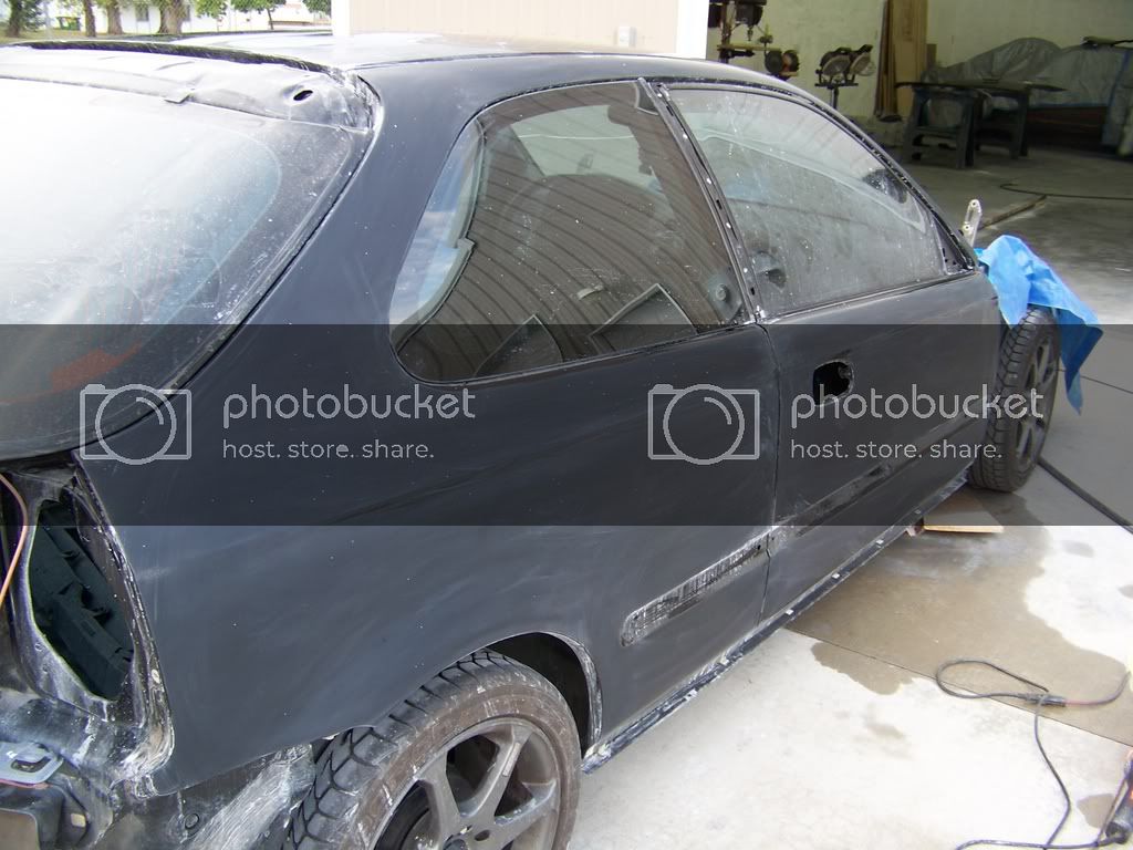

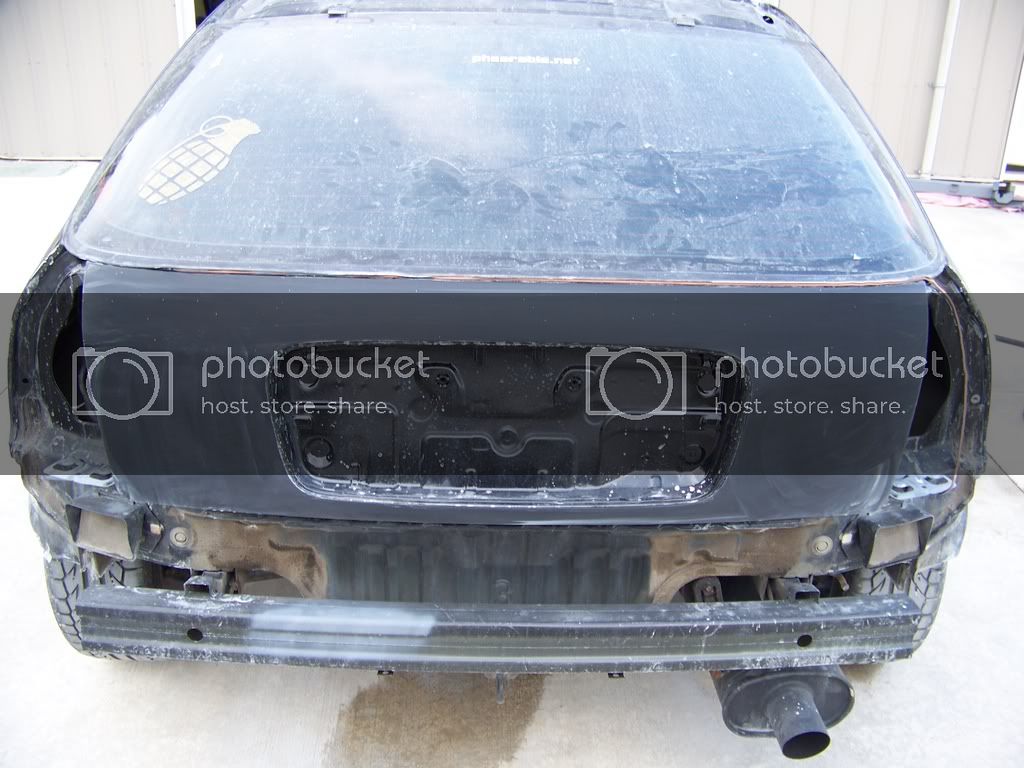

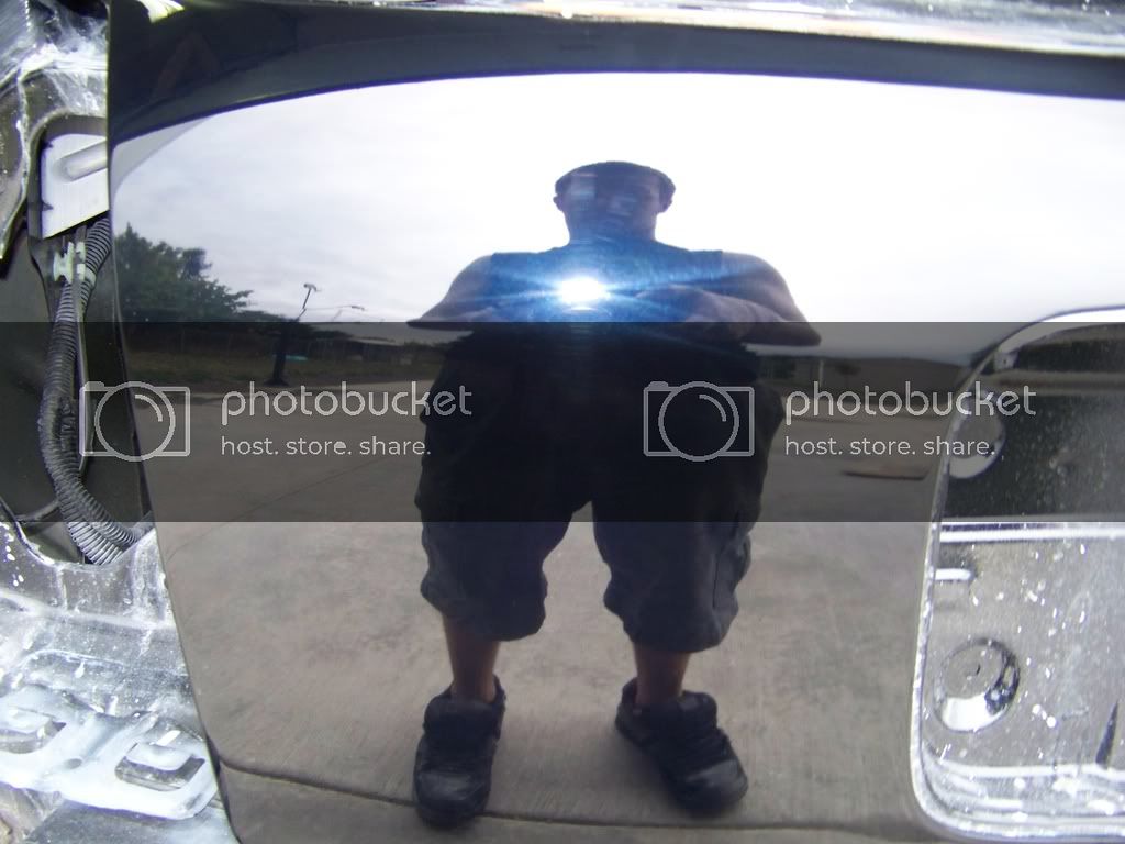

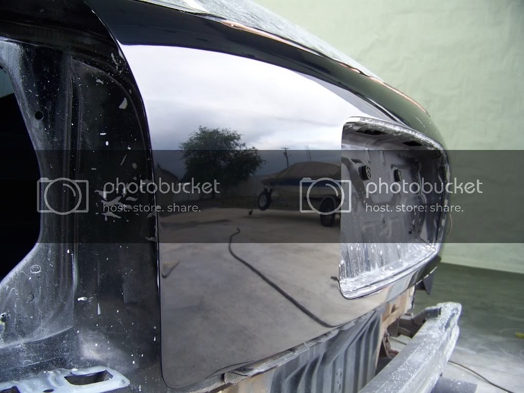

Here's some pics of the cut & buff ive been working on. Started with 1200 grit, then 1500, then 2000, then 3M heavy cut compound. Thats where I'm at so far. I still have to go over the car with machine glaze, which takes out the really fine scratches and polishes to a really nice finish. I sneak peaked it on the left side of the hatch :ph34r:
Anyway, here we go:
Halfway through the cut & buff:

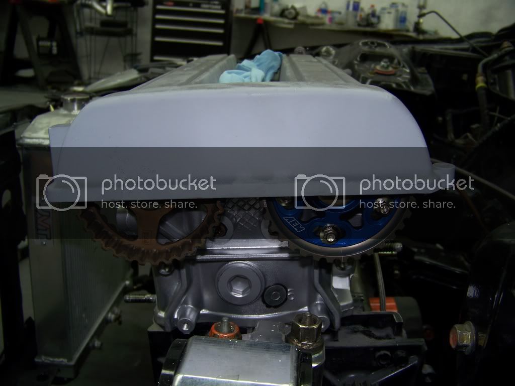

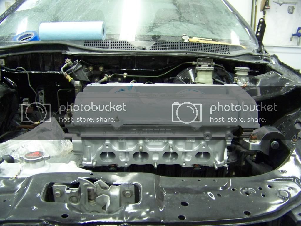

Engine is back in (not the head I'm using, just a spare one to keep dust out of the bottom end):
WOW what a piece of AWESOME engineering! Where do I put my downpipe?

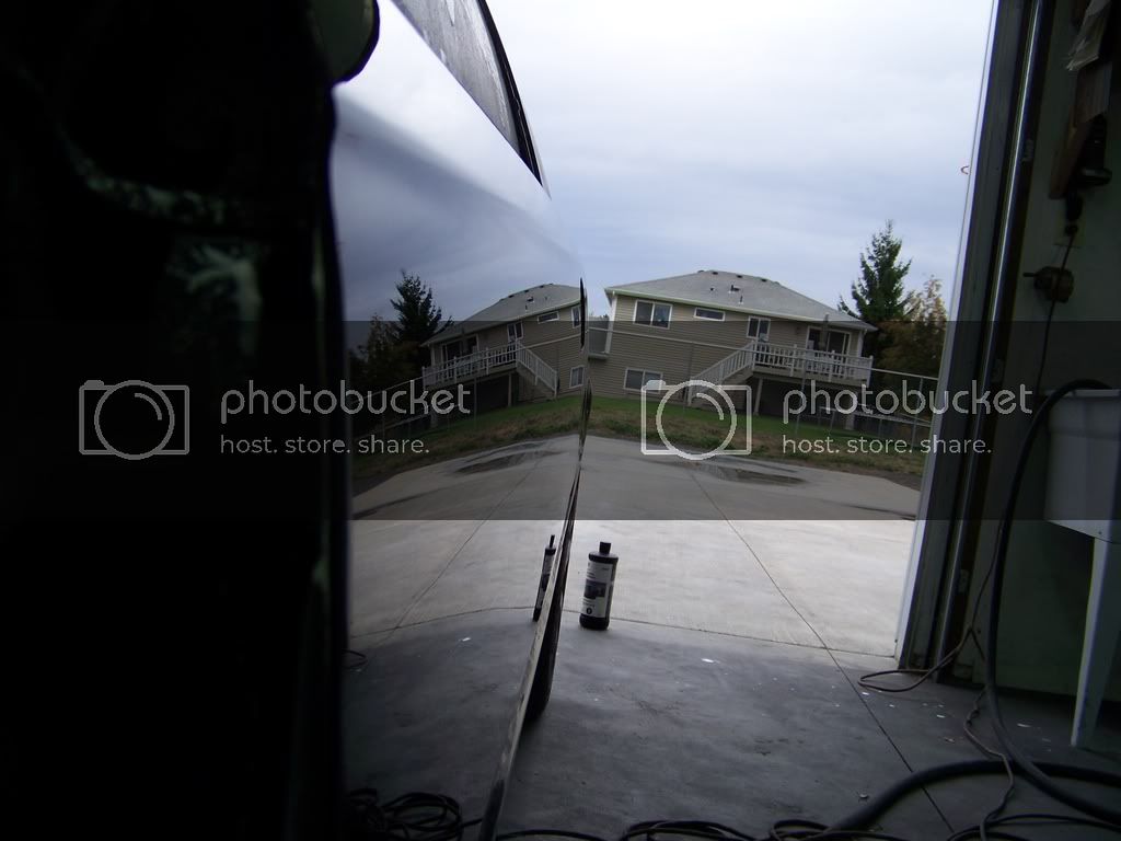

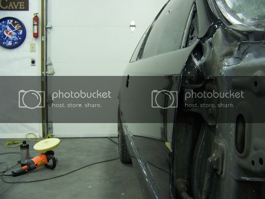

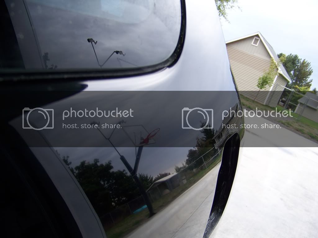

This spot is finished. Cut, and buffed with the high cut compound and the machine glaze.
Epic flake!

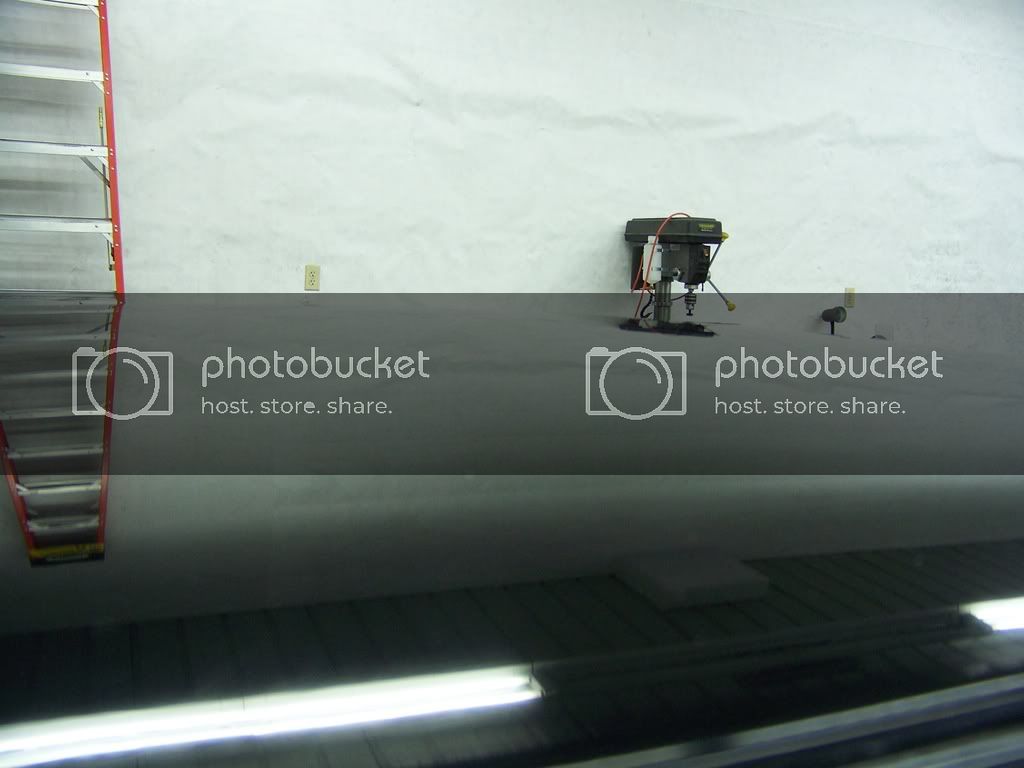

This is JUST high cut compound here, still need to go over it again then hit it with the machine glaze:
Remember that one spot with all the orange peel? Here's that same spot
Making some good progress! Woot woot

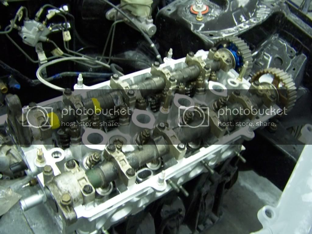

Thanks guys, got the head & valvetrain on with new cams & springs & retainers.

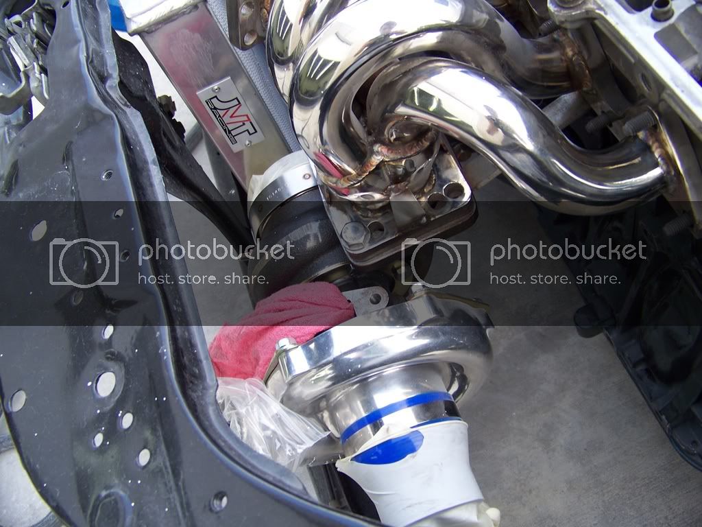

Looking for a new turbo mani right now, so we'll see what I can find

Head is assembled. All new parts installed (and yes thats a single cam gear.. interesting story behind that.. figured I'd put it on the intake side since thats really the only one I'll have to mess with). And the valvecover will be getting painted soon, havent decided on a scheme yet.. Pics:

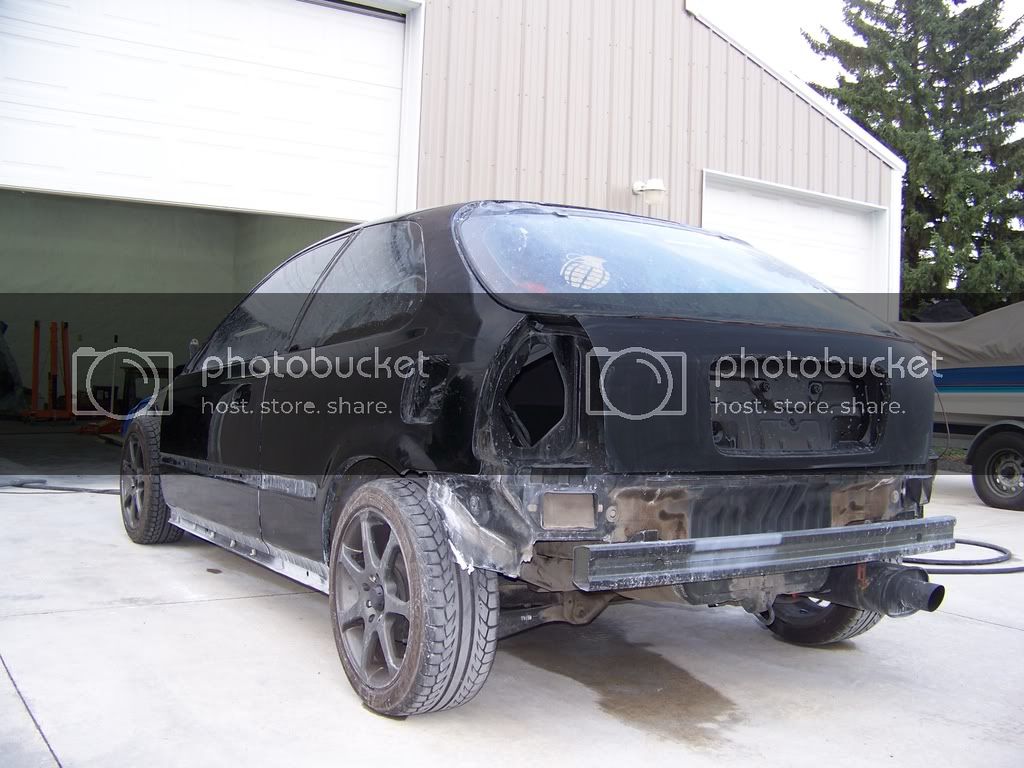

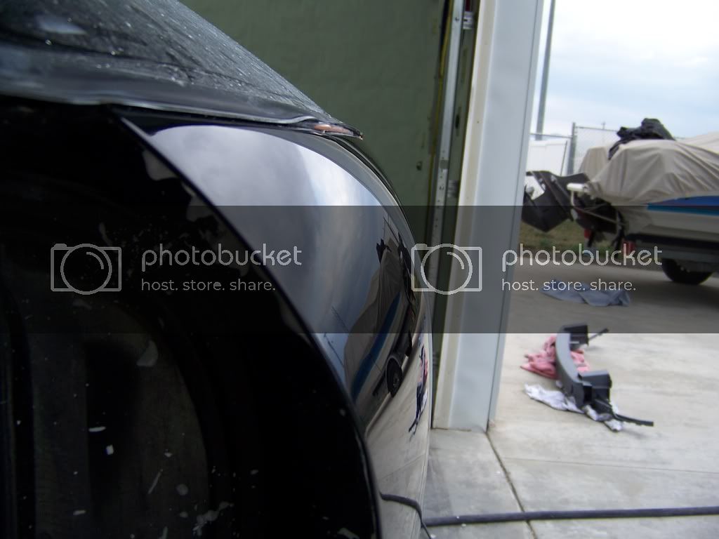

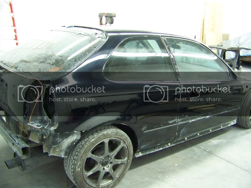

Some more buffing done on the passenger side. I'm going to go back and wetsand this door one more time.

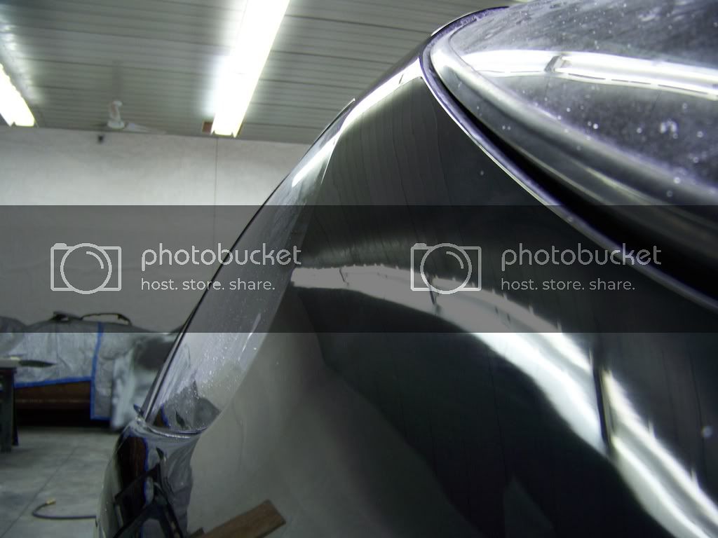

Roof:

Yea. You can tell by the valve cover, lack of a VTEC solenoid, and when the cover is off, you see the camshaft holders. On a VTEC head they are one plate for each camshaft.
lol wow..im pretty fuckin dumb huh..i didnt pay much attention...
