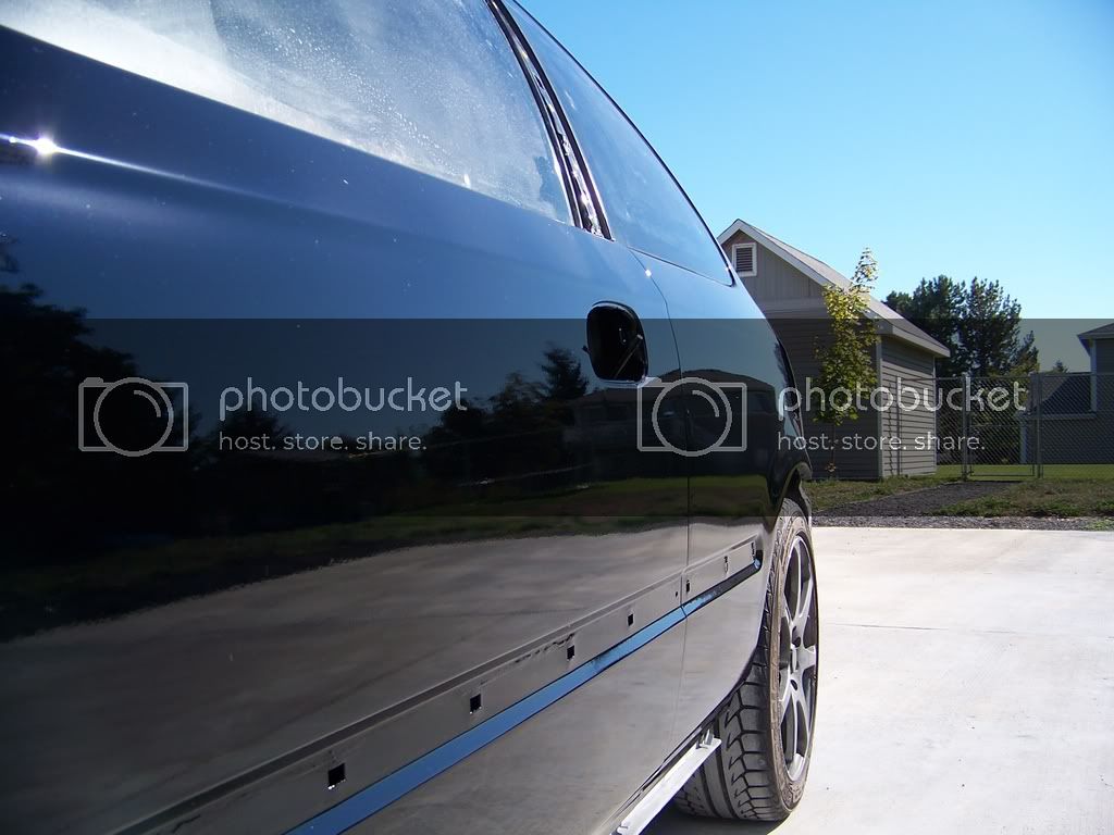

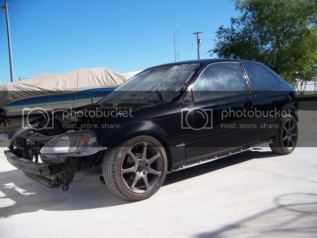

damn looks better than i thought since no paint booth... but damn good for a diy!:eek:
yea you can see the blue in the pictures on the edges of the body. Looks like you needed a tri-pod haha..... and i like your ghetto condom on the tail pipe. now hurry and get that t4 beast in there... and the rest of course it may help>.>. and immediately trailer it over. remember i get first drive. roflopagus..
First drive!? Bahah, u mean first drive besides me :ph34r:
Yea it is gonna cut/buff out nicely, thanks

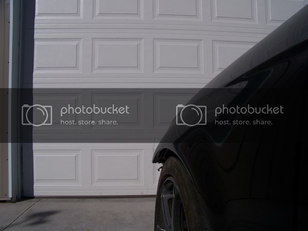

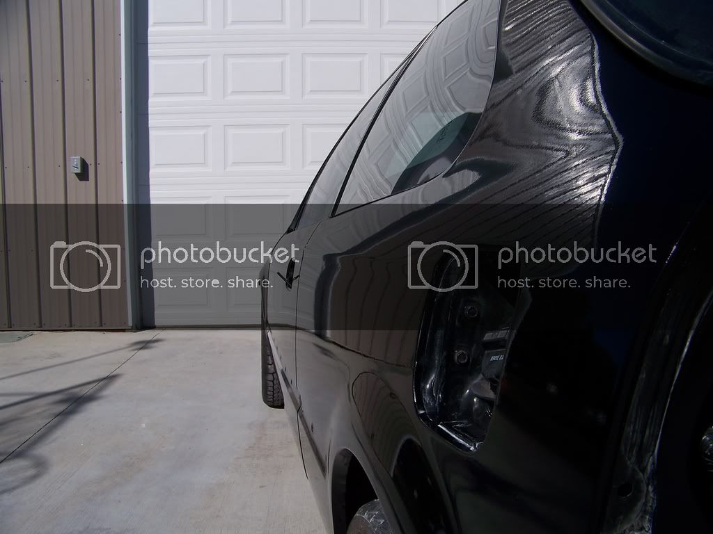

I like how the upper part of the qp looks like black woodgrain, because of the angle of the shot corresponding to the house and the ek. that is real cool.

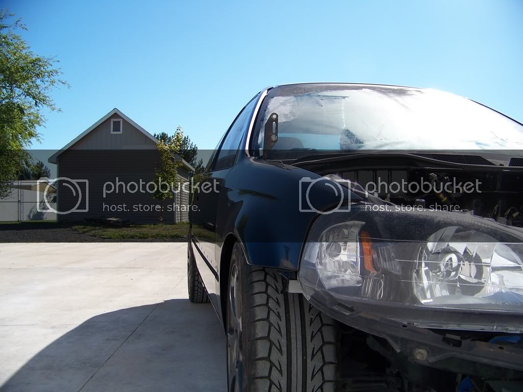

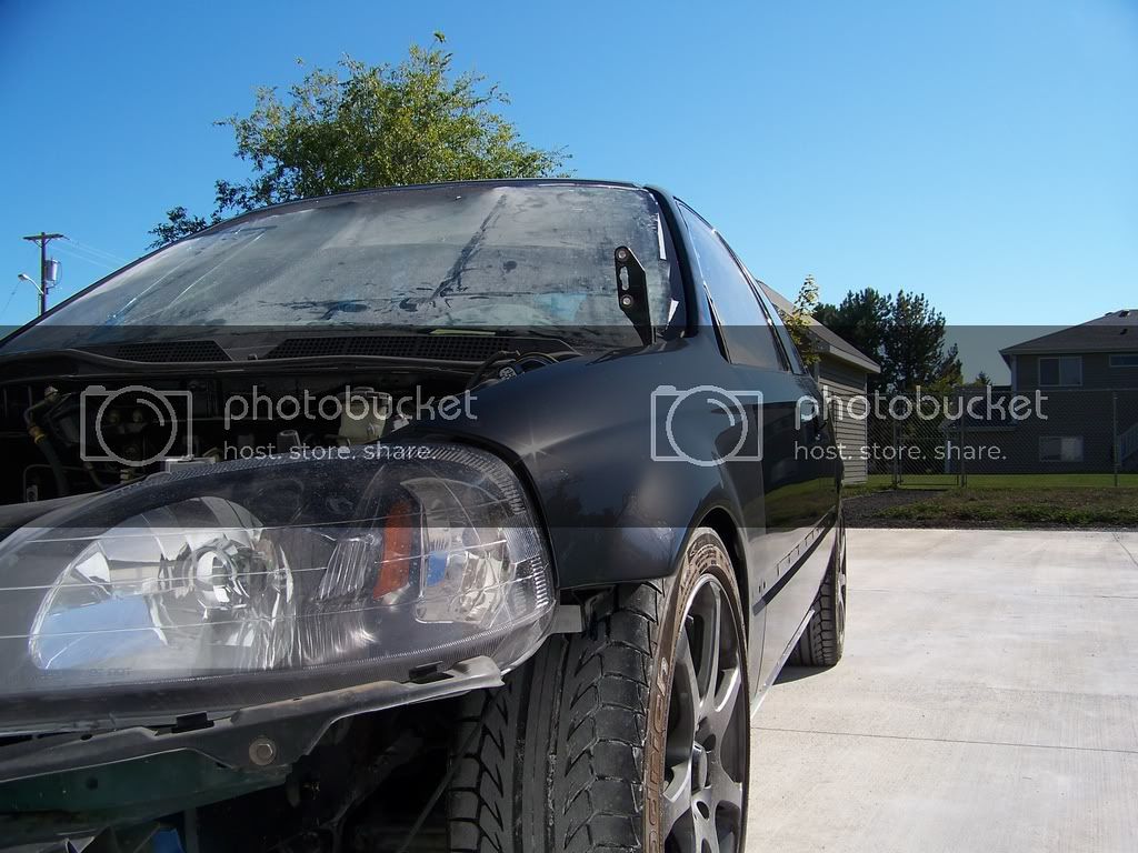

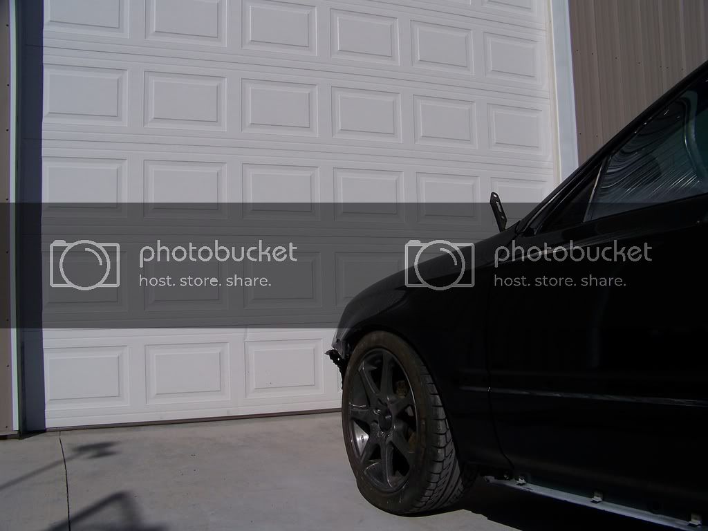

paint is looking damn good there in the sun! :eek:

Yes its getting some EX rear handles that don't have keyholes. The mirrors are getting painted, but I am not going to paint the slim moldings.. I think it would look kinda strange. But yeah, it should be back together soon, thanks for the kind words :)
