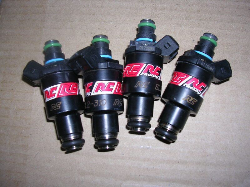

I won some rc injectors today 310cc on ebay for a great price that are in great condition.

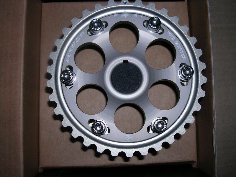

skunk2 pro gears, these are light as fuk!

woot rc injectors off ebay 110 shipped...they look to be in awesome condition.

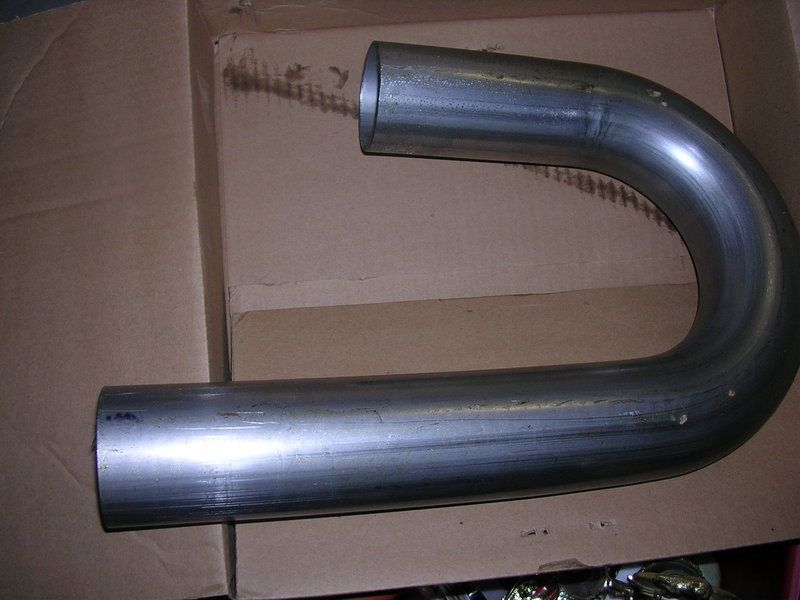

3 inch 16ga ss, im cutting my apexi tip off because i never liked it and making a turn down style tip. with the the other half i think i will make an intake arm to my comptech filter, the ss really doesnt way that much at all.

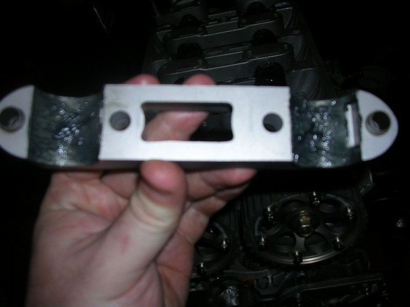

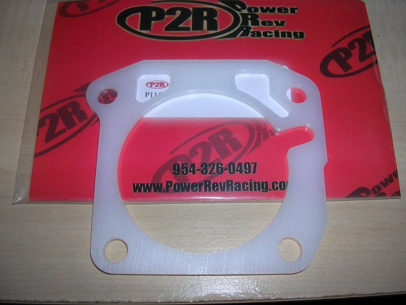

just stopped by my dads because i shipped the p2r gasket there by accident:

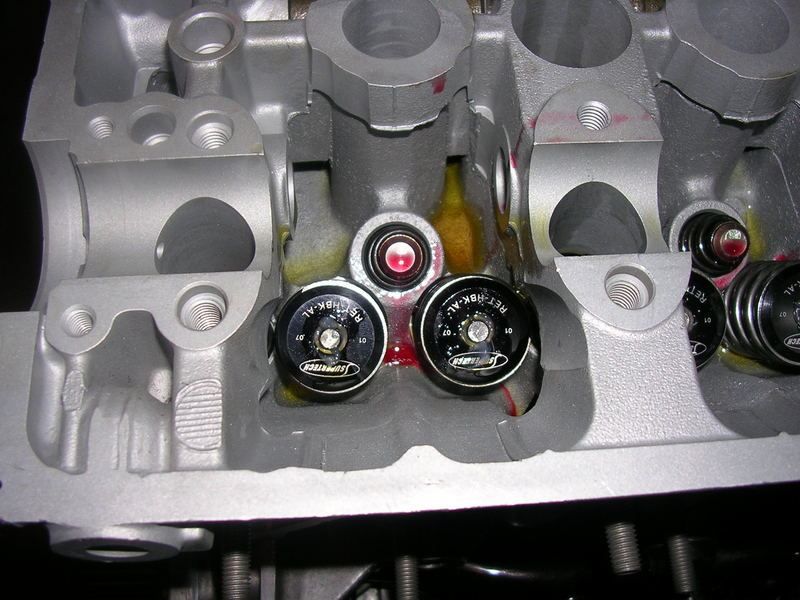

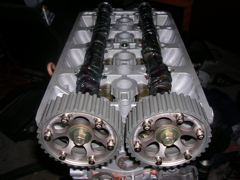

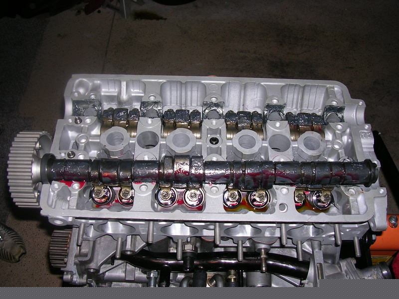

Cam install
I used lots of assembly lube
I have them bolted down now I just need to set everything up top dead center then install the timing belt.
