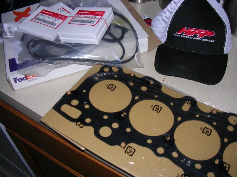

thanks for the comments guys. i did a compression test and was about 250 psi accross the board, i didnt try the oil in each cylinder test though. I really doubt the head is an issue because like matt said its only under acceleration when it smokes and everything in the head was new done by a professional. Im thinking the compression rings are probably ok but the oil rings are either bad or seized or both or maybe the clocking is is all open down the piston letting the oil seap there. I bought brand new oem honda rings so we will see when i dig into to it and also bought a new head gasket because i dont like the idea of tearing it down again and using a used gasket. I will be making sure the clocking is properly done as well based on what i saw omniman do in his video which is a great help for you guys wanting to learn how to do some of this.
Sadly i have checked all other areas hoping it was something else but im pretty sure the rings are the culprit. the felpro oil pan gasket i got leaks like a mofo fyi so that will be replaced with oem as well while i do this.

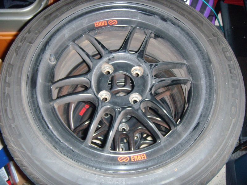

I finally did the turndown on the muffler and got some rpf1s from a h-t user so the k1s now have khumo xs on them for just the track and rpf1s for the daily driving. I also got Sparco buckets from fstvtec and installed my crow 5 point. shit is not fun anymore to daily drive! i almost hate until i get that one open road chance on my way to work and on my way home lol like most of us. I have been too lazy to paint the dor jams and interior but in time i will and put all my new moldings on....i think i might get like a cheapo redo on my paint job first because it looks like shit and pisses me off.

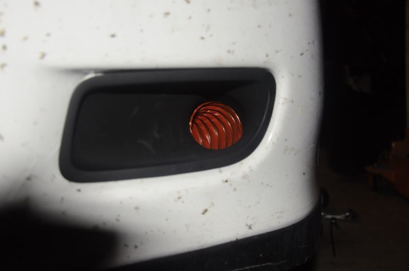

Updates before I went to Sebring

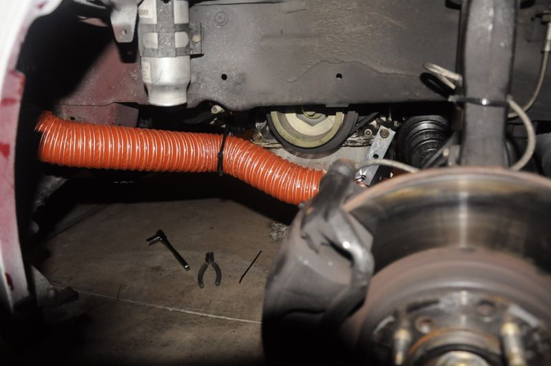

Motul brake and gear fluids, Hawk ht-10 pads, brake ducts from honda-tech user jbs :thumbup:, skunk2 rear camber, blox rear toe, brake duct hose, b&m race shifter with spherical bearing which is one of the nicest additions I have ever made, and progress coilovers with 500lb progress/800lb hyperco springs which were pretty nice. I showed my koni/gc for comparison.
