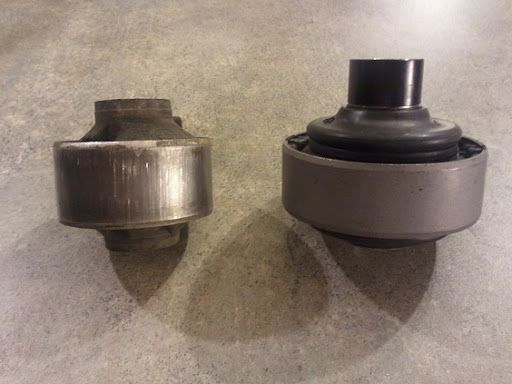

2011+ STi front aluminum control arms (the reason i need the longer axles, these control arms will increase my track width to that of the widebody, another 1-1.5" or so total. they also have a rubber isolated spherical bushing)
Whiteline Roll Center Adjust kit, extended ball joints and
pic of the 2011+ STi control arm
old bushing vs new bushing
