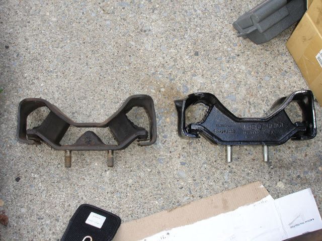

heres a good pic to show the difference between the Group N tranny mount and the stock mount

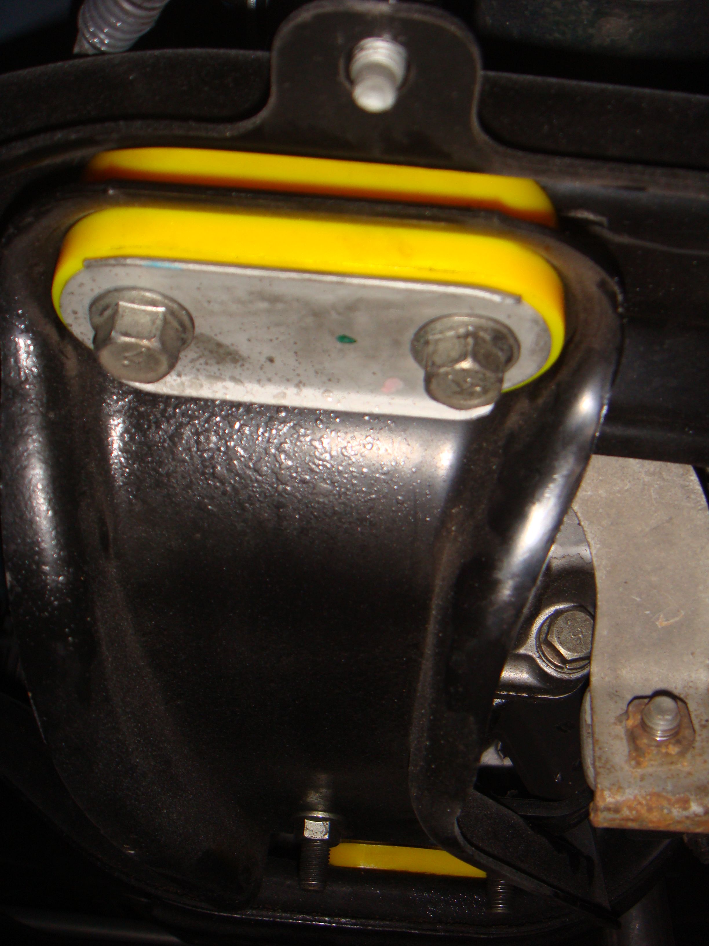

also not my pics, but here you can see the whiteline transmission subframe bushings, called the "Positive Shift Kit". they go between the pieces of the tranny support members. the stock ones are super soft gummy rubber. they can literally be bent in half and are very pliable. the WL ones are stiff poly.
between the GroupN engine mounts, transmission mounts, and the WL tranny subframe bushings, there was a noticeable tightening of the driveline. so much less slop. and a tad more vibration, but nothing like a full poly setup. the stiff rubber is still very liveable. i have poly engine mounts in the crx, and it shakes and rattles like crazy. the WRX just buzzes a little more lol.
